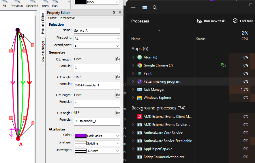

I can’t picture a 3 point spline for what you describe… but you could formulize the control point angles based on the Measurements. This is a simplistic pattern… but I just created 3 variables to represent 3 different measurement files…

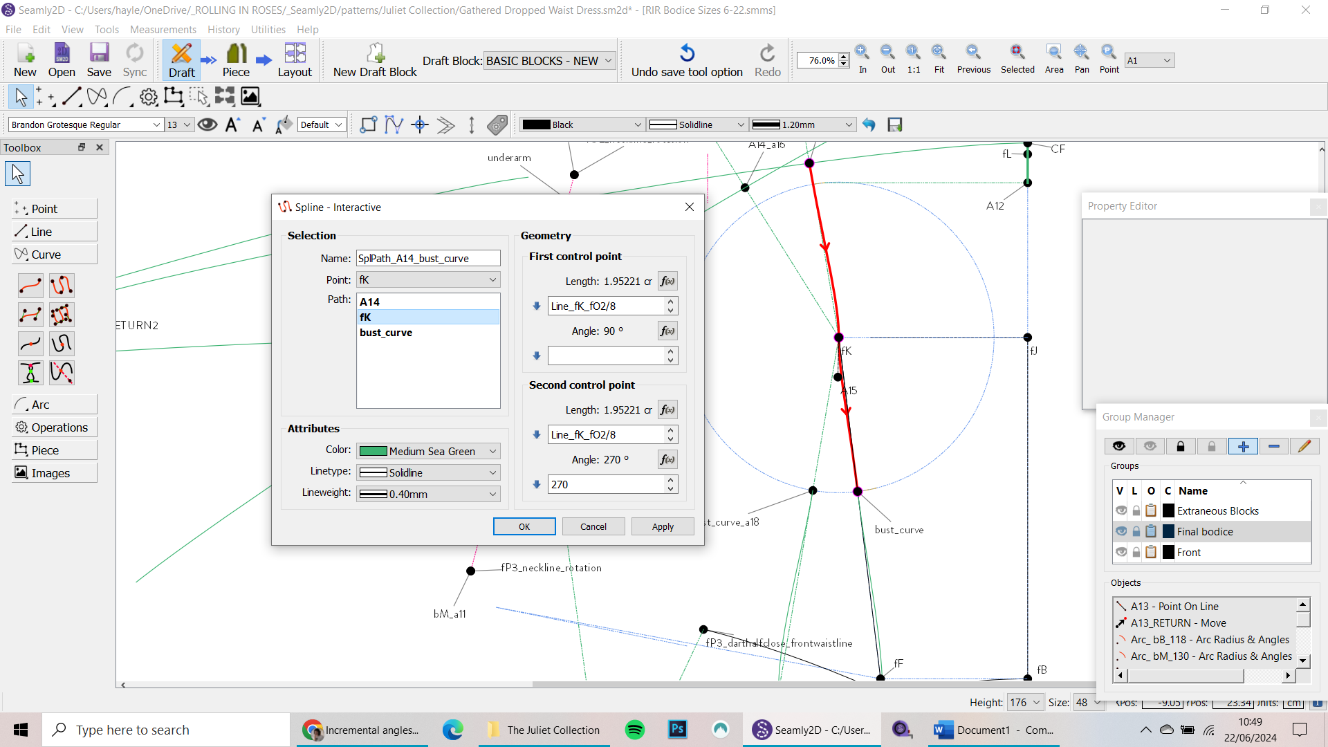

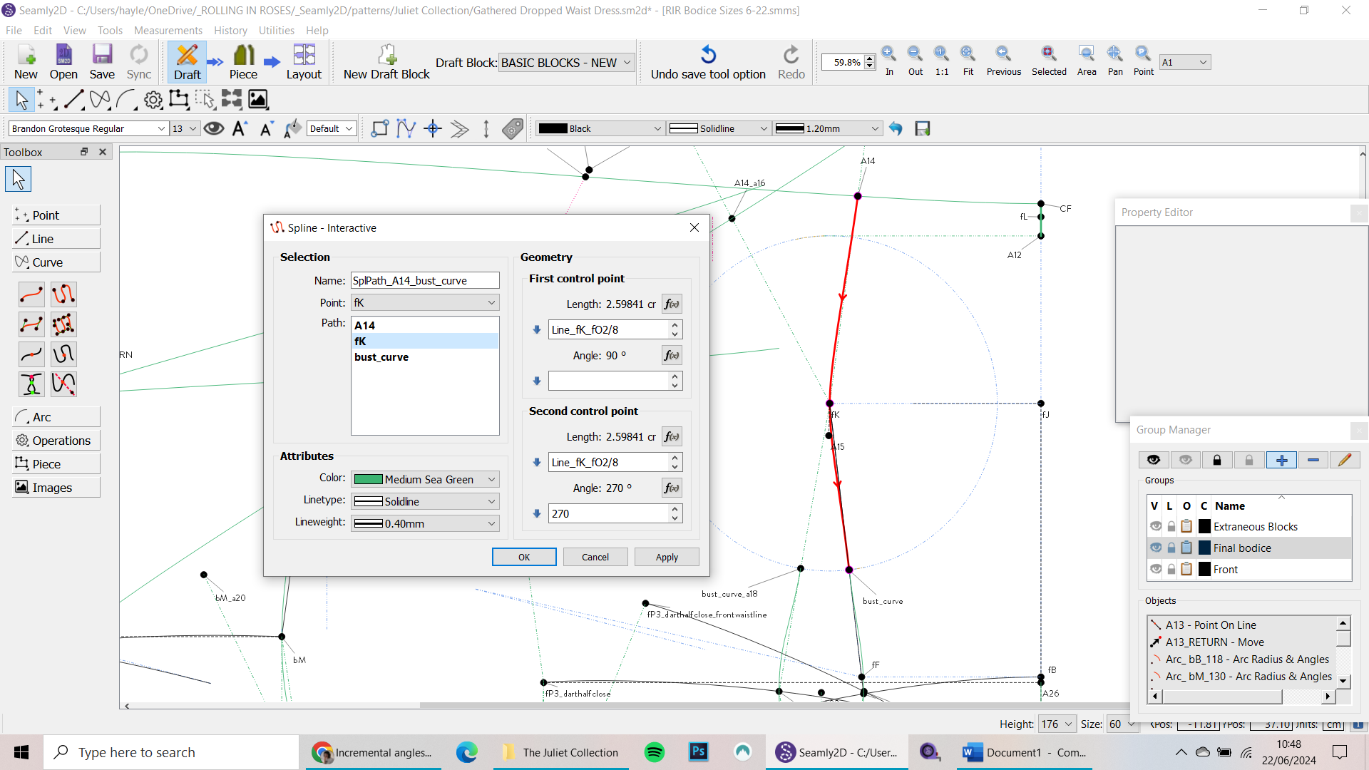

Just for reference, this is the spline I’m talking about (it’s a bust curve for a princess-line seam):
So it’s a nice curve for a bigger size, but…
The smaller sizes need a different angle to stop the spline forming a horrible shape. I just set the centre angle as vertical for this example, but ideally it would be incremental.

Oh, I see! No, an If statement would be overkill. I think what will work best is for you to ditch the existing curve & redo it like this:
  1. use the Line tool to quantify Line_A14_bust-curve
  2. use the Spline - Interactive tool to re-place the curve
  3. set the angle of the control point on fK to AngleLine_A14_bust_curve.
  4. you may need to -180 to make it lie straight instead of looped.
Hope that helps!
Ahhh, of course! Why didn’t I think of that?! Thank you so much, I really appreciate your time! Mission accomplished :blush:
