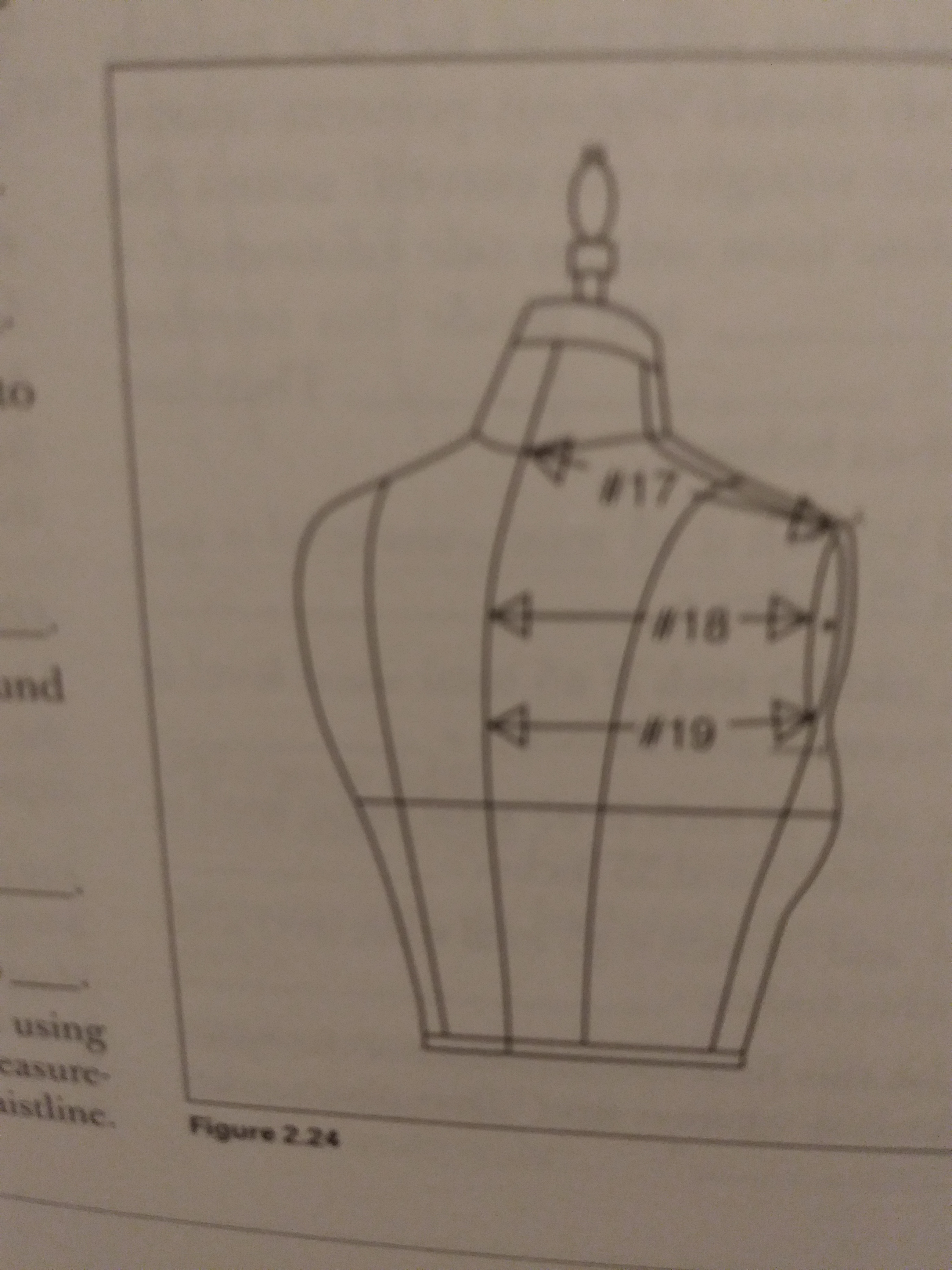

Are numbers 18) and 19) the right way around (remember I’m only going on the description, presumably there is an illustration in the book that makes this clear?

I double checked 18 and 19 and believe that what I decided is consistent with the illustrations from the book.
