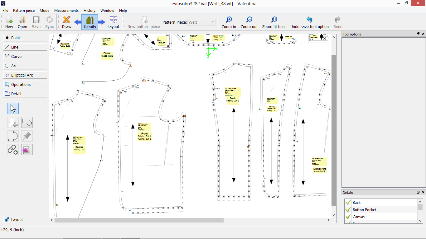

That said… I figured out a way to take an existing pattern, and using the various tools to place the grade points in the proper X-Y pos, and then using standard Wolf dress form sizes I can do a standard 2" grade up or down. I presented several patterns done this way in another thread you may find useful.

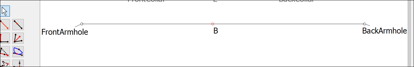

  1. Create the first pattern piece that contains both Front and Back shirt blocks.
  2. Create the second pattern piece as a line equal to (front armscye length + back armscye length). It’s easier for me to type ‘Line_B_FrontArmhole’ and ‘Line_B_BackArmhole’ into formulas instead of the spline names. Sometimes there are multiple splines and line segments, so making this pattern piece to calculate the front & back Armscye lengths keeps things simple.

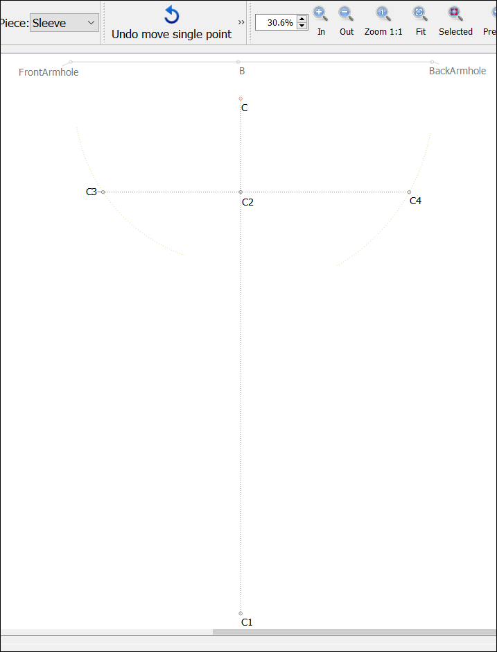

  3. Create the third pattern piece for the Sleeve. The Sleeve will need two calculations: Sleevecap depth and Bicep width.
  • Create C & C1 - Sleeve length for long sleeve shirt:
    • C - Sleevecap top
    • C1 - Sleeve length. Use Point at distance and angle tool, point=C, angle=270, length=arm_shoulder_tip_to_wrist
  • Create C2 - Sleevecap depth for a regular-fit shirt (not slim or loose)
    • Use the Point along line tool, 1st point=C, 2nd point=C1, length=(arm_shoulder_tip_to_wrist * 0.17). For loose-fit multiply by 0.16, for slim-fit multiply by 0.18. These percentages were determined by looking at the sleevecap length found on a commercially available garment for a particular size and fit, for example 11.5cm sleevecap height for slim-fit, 11cm for regular-fit, 10.5cm for loose-fit, and 10cm for t-shirts for men with height=177cm, chest=100cm, and sleeve length=64cm. Find the percentage by dividing sleevecap height by arm length --> 11.5cm/64cm=18, rounded up to 2 digits. Women’s blouses start with this basic sleeve block then the sleevecap is extended upwards above C and slash-and-spread rotation with C3 and C4 from the center of the elbow line adds in ease for gathers or pleats. And if any of you have percentages for baby & toddler clothes sleevecap height please post, we’d love to know more!
  • Create points C3 and C4 - Bicep width
    • Create 1st arc with Arc Tool image, centerpoint=C, radius=Line_B_FrontArmhole, 1st angle=100, 2nd angle=250.
    • Create point C3 with Intersect Arc and Axis tool image, Axis point=C2, the 1st arc, and Angle=180. Draw dashed lines from C2 to C3 and from C to C3.
    • Create 2nd arc with Arc Tool, centerpoint=C, radius=Line_B_BackArmhole, 1st angle=300, 2nd angle=350.
    • Create point C4 with Intersect Arc and Axis tool, Axis point=C2, the 2nd arc, and Angle=0. Draw dashed lines from C2 to C4 and from C to C4.
