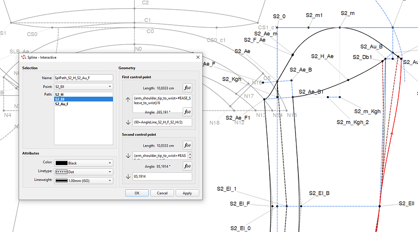

Interactive Spline Properties window
Interactive Spline Properties window is a little bit messy when I expand the field for angle or length.
And while we are at that, are there plans to make this a part of regular properties?
And if not, would it be possible to make those fields self expendable or maybe that we can make the whole window bigger (and that it stays bigger after reopening) or some other idea where I could better use all the existing screen place and do less mouse clicks around.

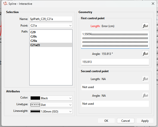

Ok… here’s what I did.
I got rid of the expand / contract buttons… so the text box is that much wider. I expanded the min height & width of the dialog window slightly, and rearranged the horizonal layout box to widen the right side a bit. I also promoted the QPlainTextEdit boxes to a subclassed ExpandingTextBox. So now the text boxes are bigger and automatically expand when they gain focus… and collapse when they loose focus. The effect is more room for the formula.

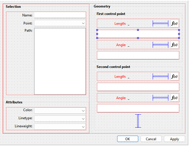

BTW… here’s what the UI form looks like… where the Vertical Spacer acts like a spring and allows the contents of the Geometry Group box to expand and collapse. Without that space there is no where for the text boxes to expand into.
