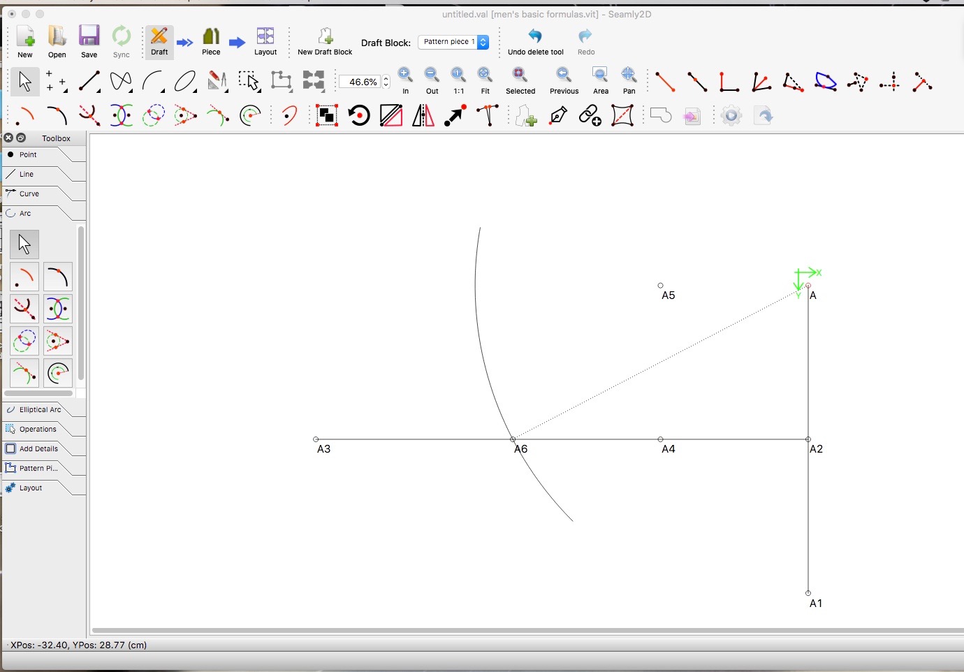

i recreated vaguely what I was doing. I created an arc, then I wanted to measure a specific amount from point A6 along the arc (downwards) , to create a point, as well as measure up wards along the arc another amount. ! can see now that I can get the info on the arc length and try to place points that way, I guess I was thinking there must be a way when doing that to input the point to measure from.

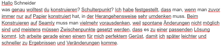

Hallo Schneider was genau wolltest du konstruieren? Schulterpunkt? Ich habe festgestellt, dass man, wenn man zuvor immer nur auf Papier konstruiert hat, in der Herangehensweise sehr umdenken muss. Beim Konstruieren auf Seamly muss man vielmehr vorausdenken, weil spontane Änderungen nicht möglich sind und meistens müssen Zwischenpunkte gesetzt werden, dass es zu einer passenden Lösung kommt. Ich arbeite gerade einen einem für mich perfektem Gerüst, damit ich später leichter und schneller zu Ergebnissen und Veränderungen komme.

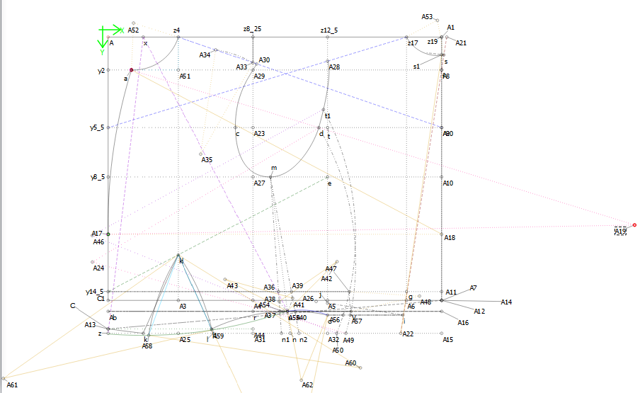

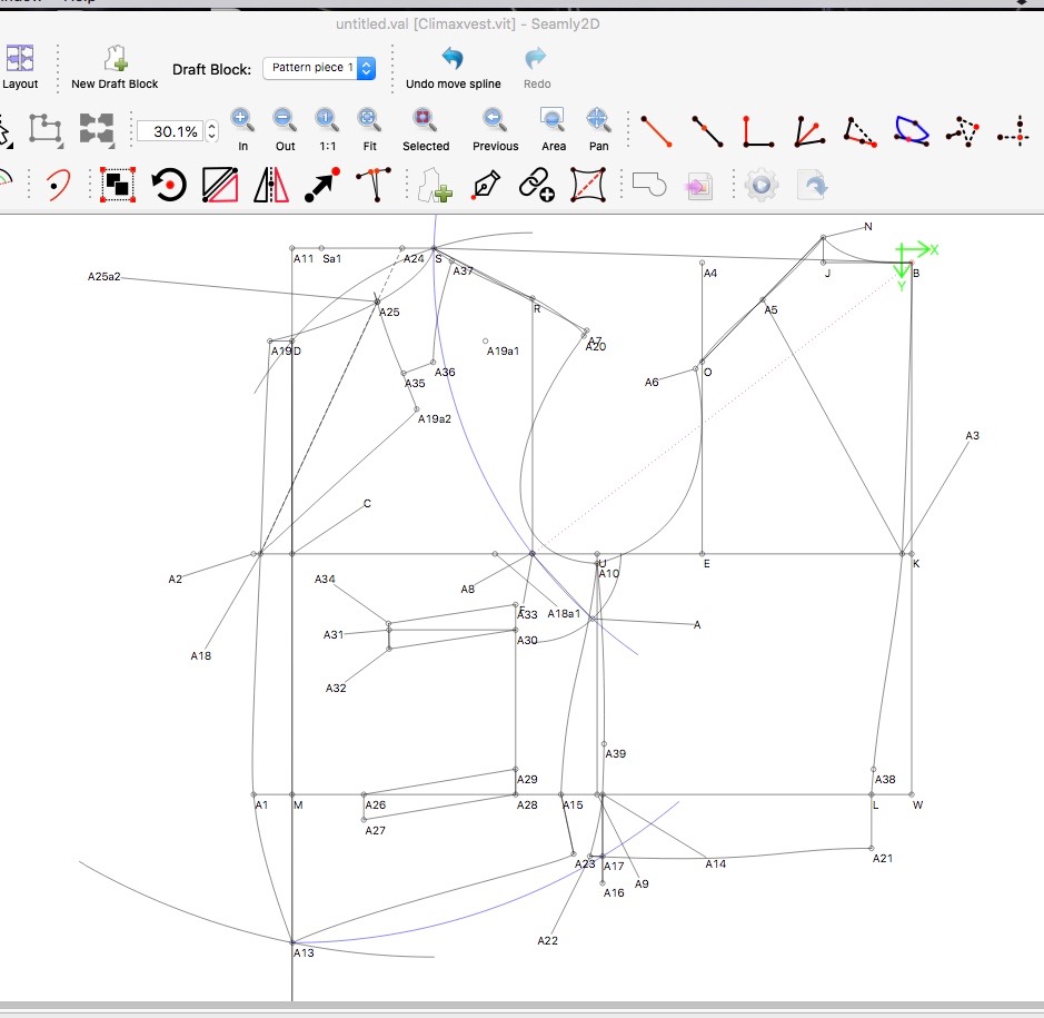

This was what I was working on. A waistcoat from TheClimax System c.1920 I am merely using these as a means to learning the software. I can usually figure out a way through trial and error, but I am also like to know if I am missing the obvious or the easier way to accomplish a task! I have way more pattern making experience than software experience! I do want to thank everyone who responds- it makes for a great sharing experience!

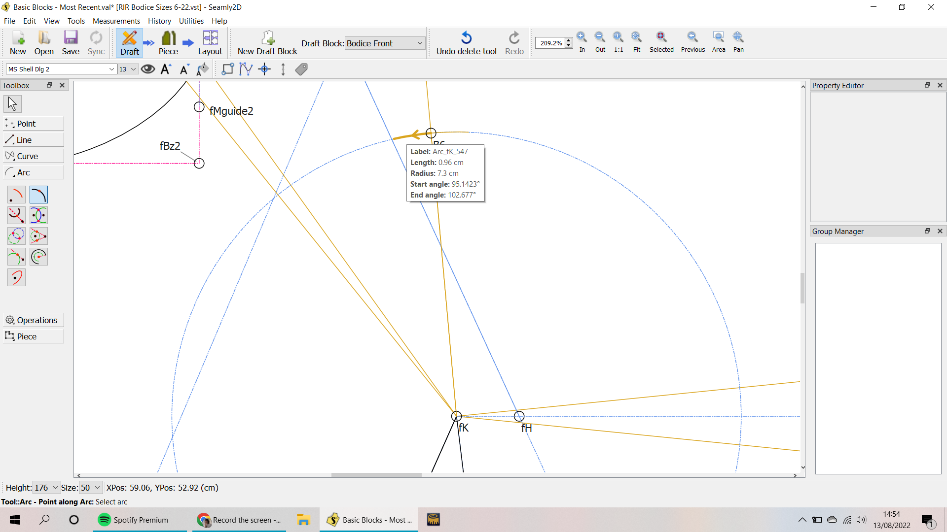

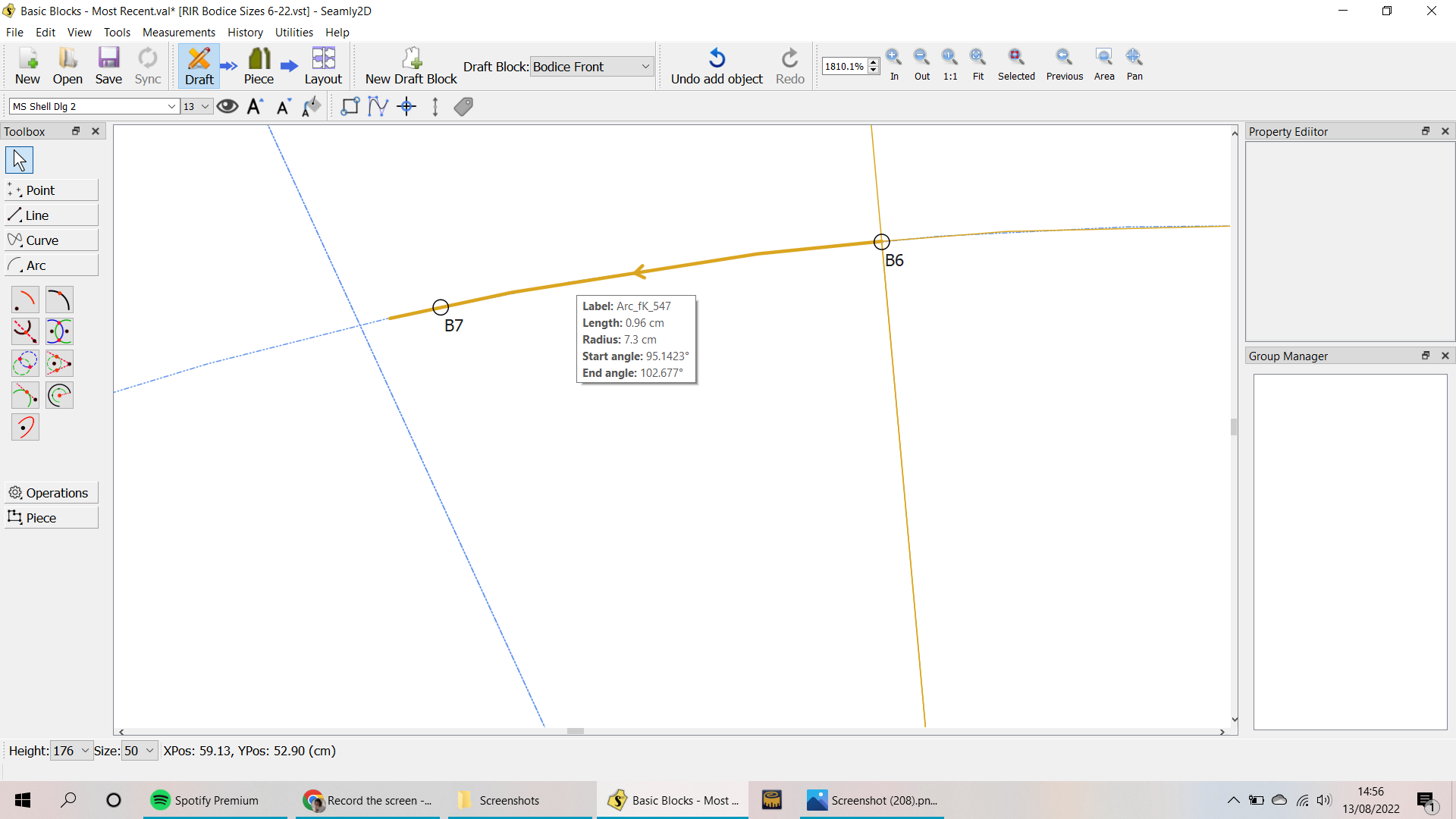

Thanks so much for getting back to me so quickly! I really appreciate the help. For some reason it’s not putting the point on the end of the arc though, and I can’t for the life of me understand why! I’ve screenshotted the steps I did: So, it’s this arc I want, which I select with the Point Along Arc:

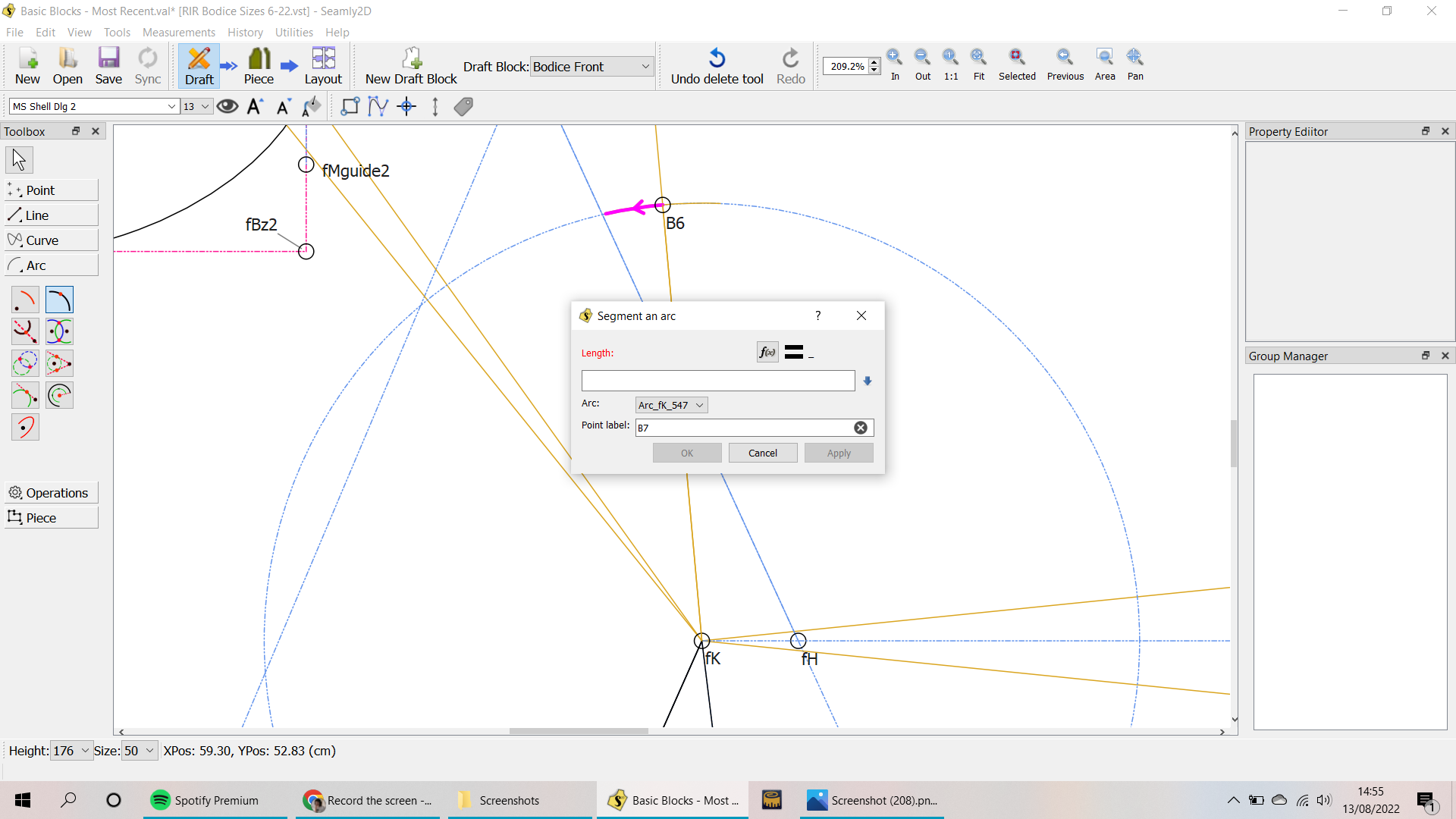

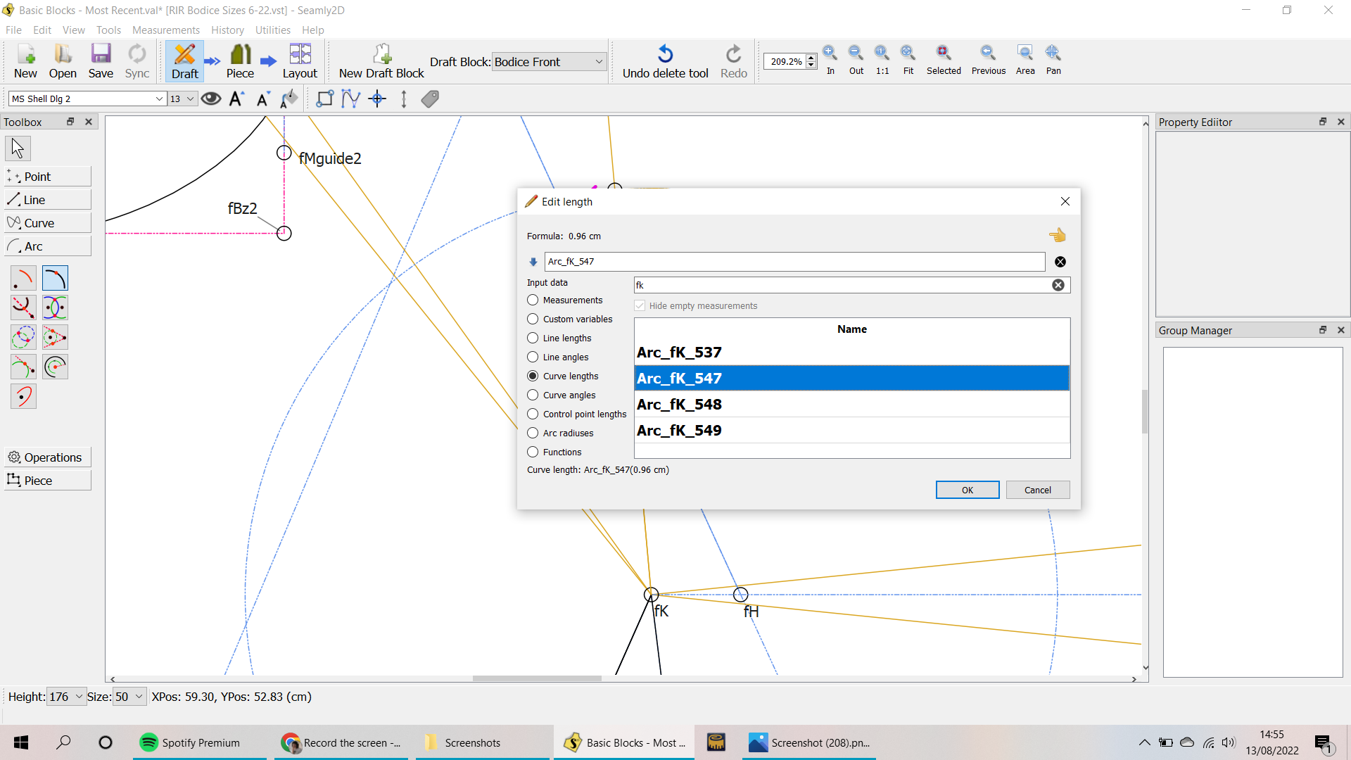

And for the length I select the length of the arc…

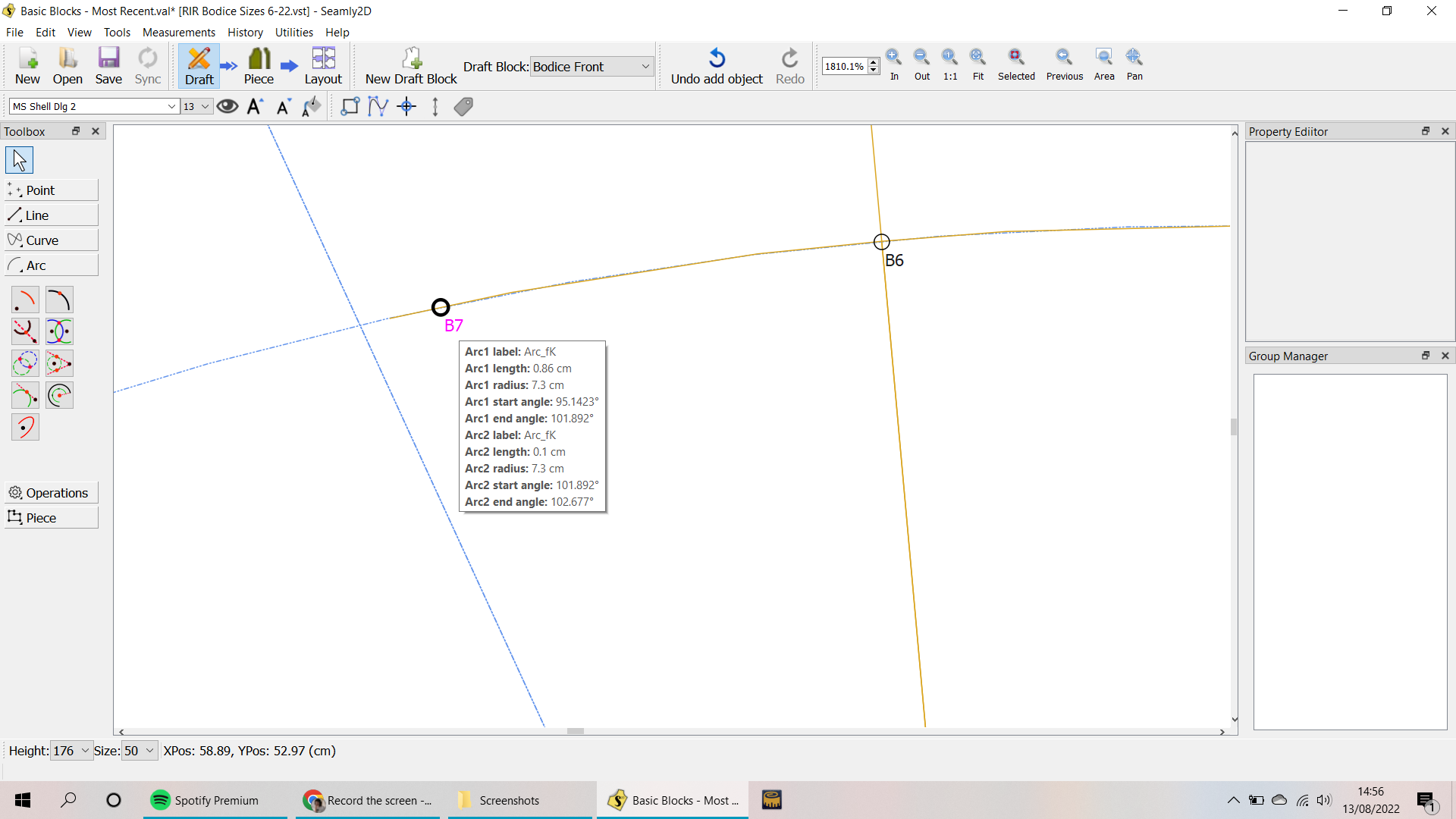

But the point isn’t placed at the end of it when it appears…
I don’t know if I’m being stupid but I just don’t understand it! Any thoughts?
Ahh. I see now. The bad new is you aren’t doing anything wrong. I think @Douglas made a comment about why that is some time ago, but I can’t find that post right now. My only solution is, if millimeter tolerances matter in your pattern, I see that the point gets placed exactly a mm in, so if you added a mm to the formula for making Arc_fK_547 it would come out how you wanted. If mm tolerances are tolerable in this portion of the draft, it’s probably best to just be disgruntled at it & hope it will be eventually fixed, (& try not to look at it closely.)
Could you post your pattern and any vit and I can take a look at it?
Yeah… I know I addressed this before, can’t recall if it was something I fixed and was justing waiting to push the changes? Off the top of my head I do seem to recall this might be one of those fuzzy math things, where with the floating point math you can’t rely on 2 values exactly being equal, so the 1mm might be the tolerance when comparing 2 points.
