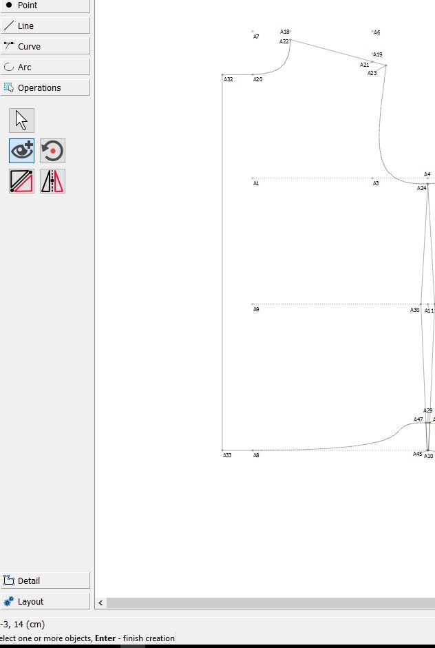

Basically if I understand good I have to create new layout from part that I want to cut and to rotate and re position? I do have option Operations under my tools but it doesnt allow me to use it on layout to rotate whole piece just on drawing and than he doesnt allow rotation of more points at the same time.
I do have latest version at the moment.
You should do all transformation in Draw mode. We do not support transformation pieces.
Use tool Group if need to hide some objects.
Ok I understand now that part but I am still confused because in that mode it doesn`t allow me to choose object just to select point.
When you make an operation: rotation, moving, symmetry etc. you can select only point and curve.
is there a tutorial about using group tool? It is saying select OBJECT but how can I select object in drawing mode?
I dont understand using of this tools. Look down in left corner. It said select one or more objects and I can only select point or curve. Is there a tutorial for this?
In Draw mode an object is a point and a curve.![]()

Yes of course. Yesterday I have made complete pattern from scratch and I like everything that I came across during that process. I used pattern maker for many years. I sew to a measure for 25 years and that program was really helpful. Maybe that is why I expect some things to see in your program. For me language is barrier since I don’t know any professional terms and I see here in forum people being very familiar with it. Your colleague told me to use my language and you can maybe translate. Regarding group tool,does it give an option to group points so that they can be rotated as an “object”?
No, for this we have separate tool. The Group tool help you select objects and control visibility. For example when you rotate a rotation angle can be small. This creates a lot rotated objects above original and if you don’t want to see a mess you hide some objects.
But in option for each point I can decide about angle and directions. What tool do you use to group points? Did you mean detail?
I am talking about tool with an eye icon.
This is the Move tool.
I do understand that just I don’t know why to rotate point but it’s just because until now I never came across task to need that. I think it is better that I wait for video that you mentioned you will make so than I can better understand this.
