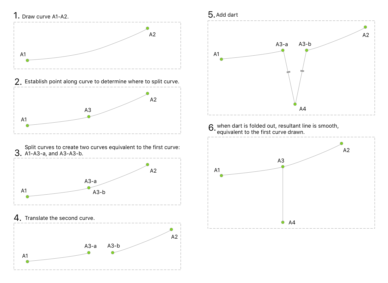

I’d like to draw a curve, split it at a point, translate the second curve (e.g. 1.5 along +x axis) to insert a dart. The end result that I want is a the original continuous curve when the dart is folded out.

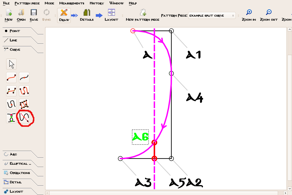

I am not quite sure what you want to do; but it is possible to insert a point into a curve and then move or flip that curve including that point; later on you can just take a part of the curve in your detail:
You have a frame with the curve and the point where you want to split the curve (here A5)
  1. click point intersect axis tool
  2. click on the curve, then on your point (here A5)
  3. select the angle the axis should have

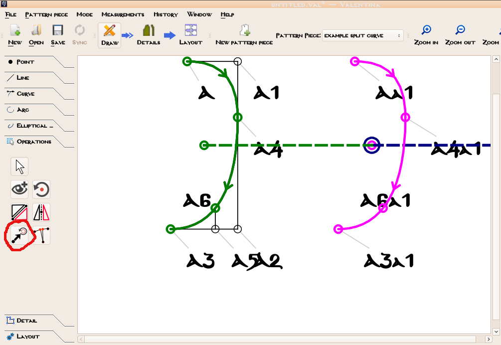

Then you can move or flip or rotate the curve including the new point on the axis; here I took the move-tool:
  1. click move-tool
  2. select every point you want to include (here A, A4, A6 and A3) and the curve, press ctrl while selecting
  3. confirm with enter
  4. move for desired length and angle

@Sue, @moniaqua many thanks for your quick reply! I understand the tool that lets you create a point along a curve. It’s pretty neat. However, i’m wondering if it’s possible to do is something like this:
In other words, is it possible to take an existing curve and split it apart by creating two equivalent curves (ostensibly with new control points)?
I tried to sketch out what i’m trying to do, in case it helps. The ultimate goal here is to make sure the resultant curve is smooth when the dart is folded out.
If it’s not possible to split curves, is the best way to get this effect as @moniaqua suggested — by translating the curve and then selecting the relevant points as necessary in the detail view? If so, how do you keep the draft from becoming cluttered with unnecessary lines?
