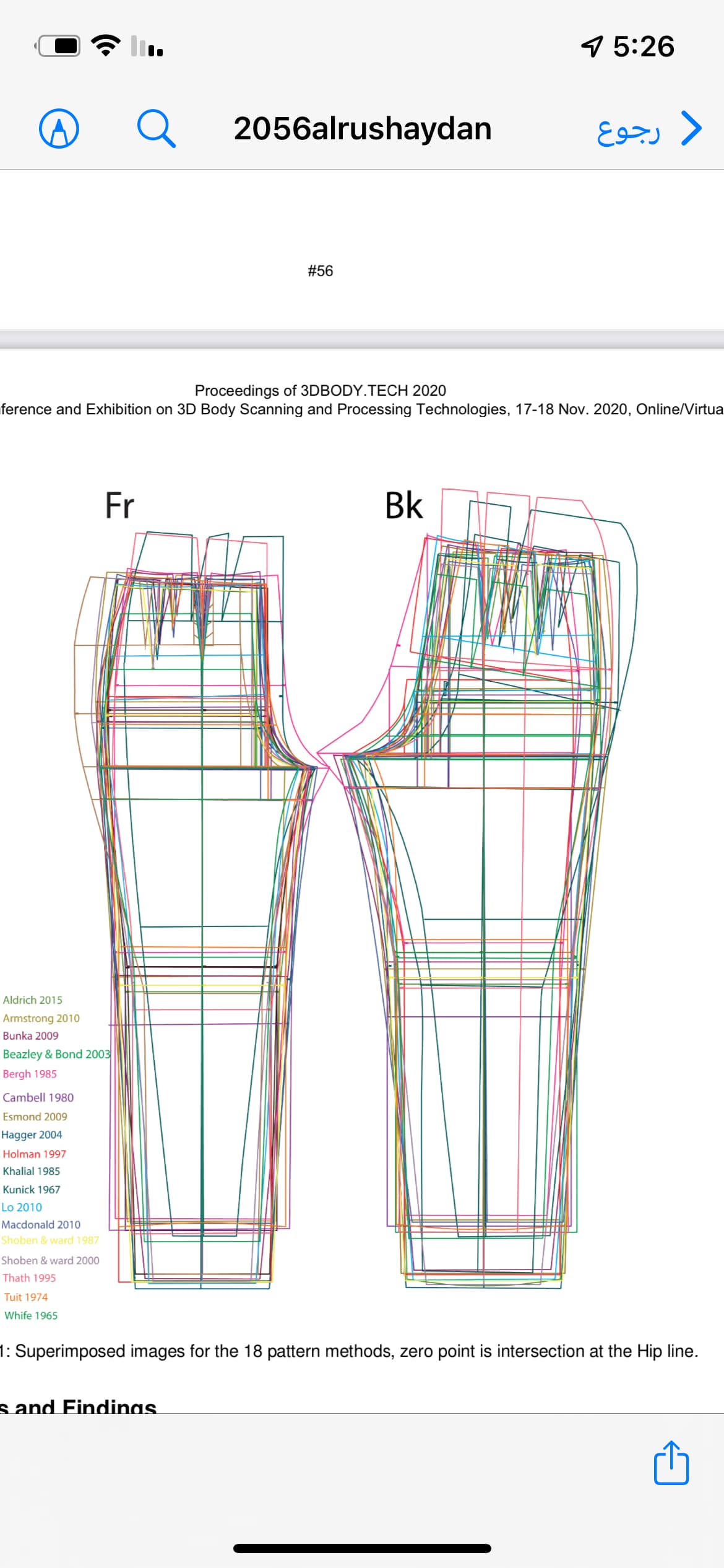

Hello Is there a tool in Seamly2d allowing me to see the changes in the pattern after doing changes in measurements table but with keeping the original pattern ( for comparing 2 size
) Please see attached diagram
No… not yet, but you could export the pattern pieces or a layout - as an svg?, and then import and layer the different sizes into an app like Inkscape. You could change the seam and cut line colors for each size vefore exporting… a little awkward, but it could be done. Might be easier to change the line colors in Inkscape.
Eventually we’ll get to implementing a nesting tool / module.
Thanks for your reply. This tool is very important for Academic research. I wish adding it soon.
