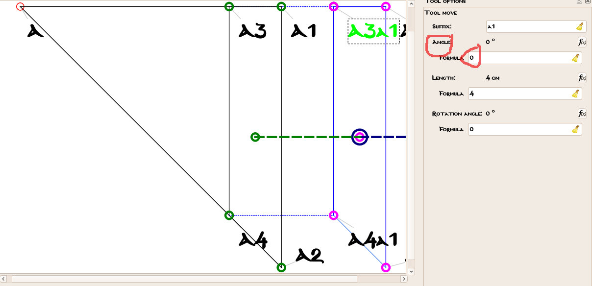

Yes, there is. The “move objects”-tool is exactly what I would use for that. Just make sure, that the angle you move is the same as the angle of the line 90° to the line you are moving:
In my case A - A1 - A2 was the original triangle, I added a line for the pleat A3 - A4 and moved that and points A1, A2 parallel; along line A - A1 (that’s to say with the same angle).
You can do that with holding the shift key while moving or with writing the right angle into the field “formula” under “angle”. Then it is exact :wink:
