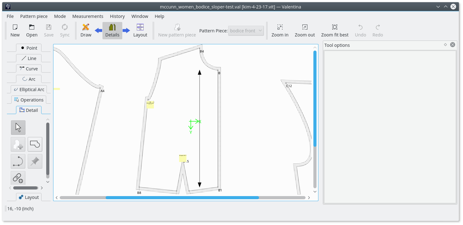

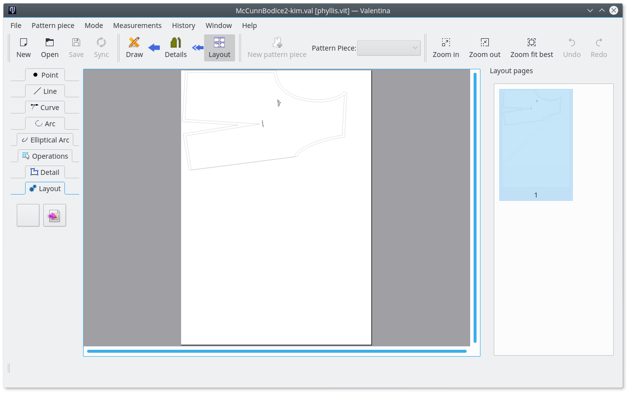

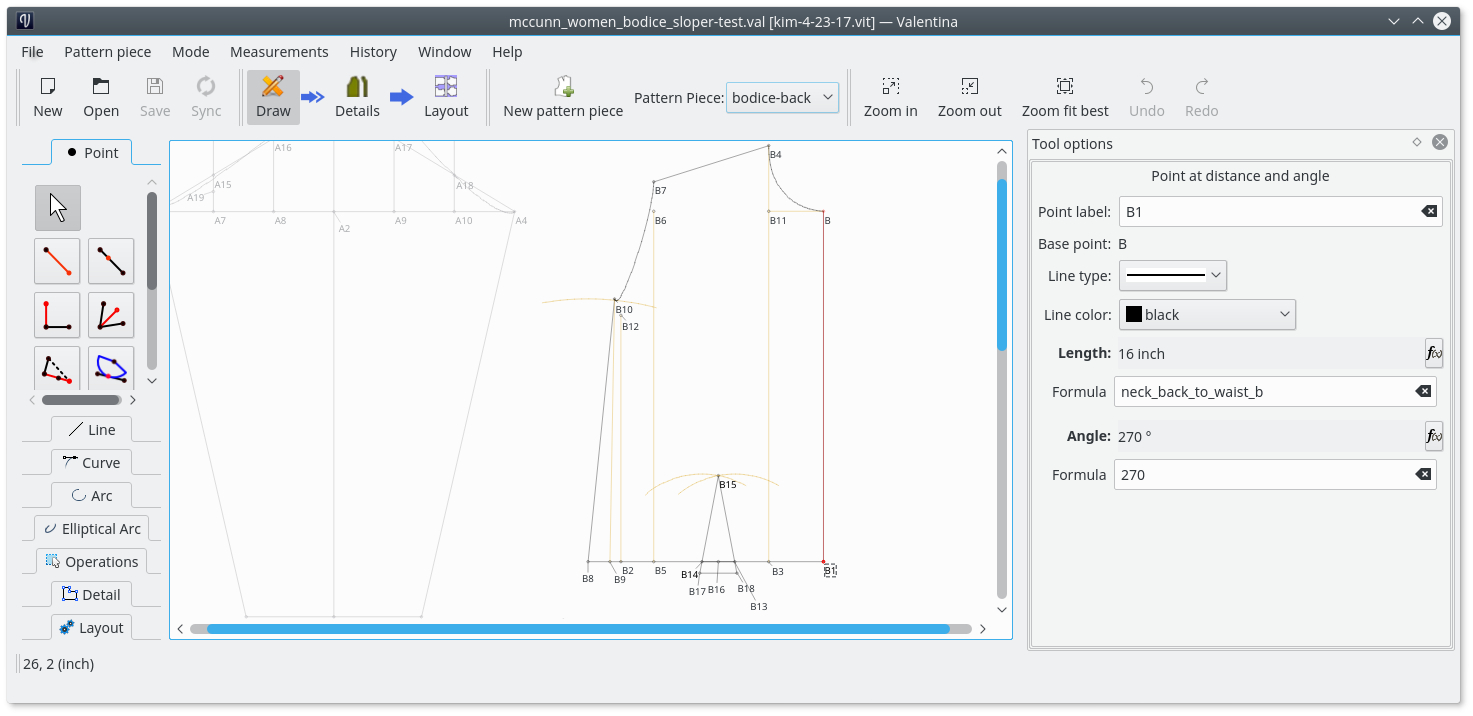

I have gone through all of the steps and begun to print actual patterns to check thee validity and fit. I have created a basic bodice block and it will not print to scale. I have read all about issue 297 which is closed and this seems to be the same problem. I have tried printing (created a layout on A0 and saving it as a tiled PDF then printing the PDF). I have done this both on Ubuntu 16:10 valentina built on Mon Apr 17 2017 at 16:29 and also on Windows 10 valentina built on apr 24 at 8:21:35. The center back measurement is 16". on Ubuntu it prints as 14 1/2". on Windows it prints as 12". Is there a tutorial somewhere that I have missed? I am providing screenshots from the Ubuntu version of Valentina and I can provide the pattern file or other detail if it is useful. I will open another issue if you want me to.

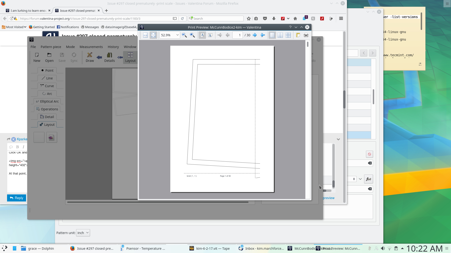

I think I have found a way to get a printout, which is to “preview tiles pdf” then print from within the preview. Unfortunately, that works for a simple 4x4 square test pattern I made but will not work for my fairly simple pattern (simple bodice with front, back, sleeve pieces). It failed and I have a commitment I have to keep, so I will try more options later. I have spent a lot of time “doing my homework” and reading what others have tried. It may have been solved and documented somewhere on the forum but I have been unable to find it

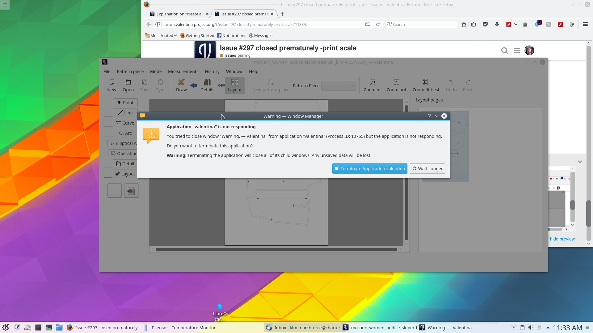

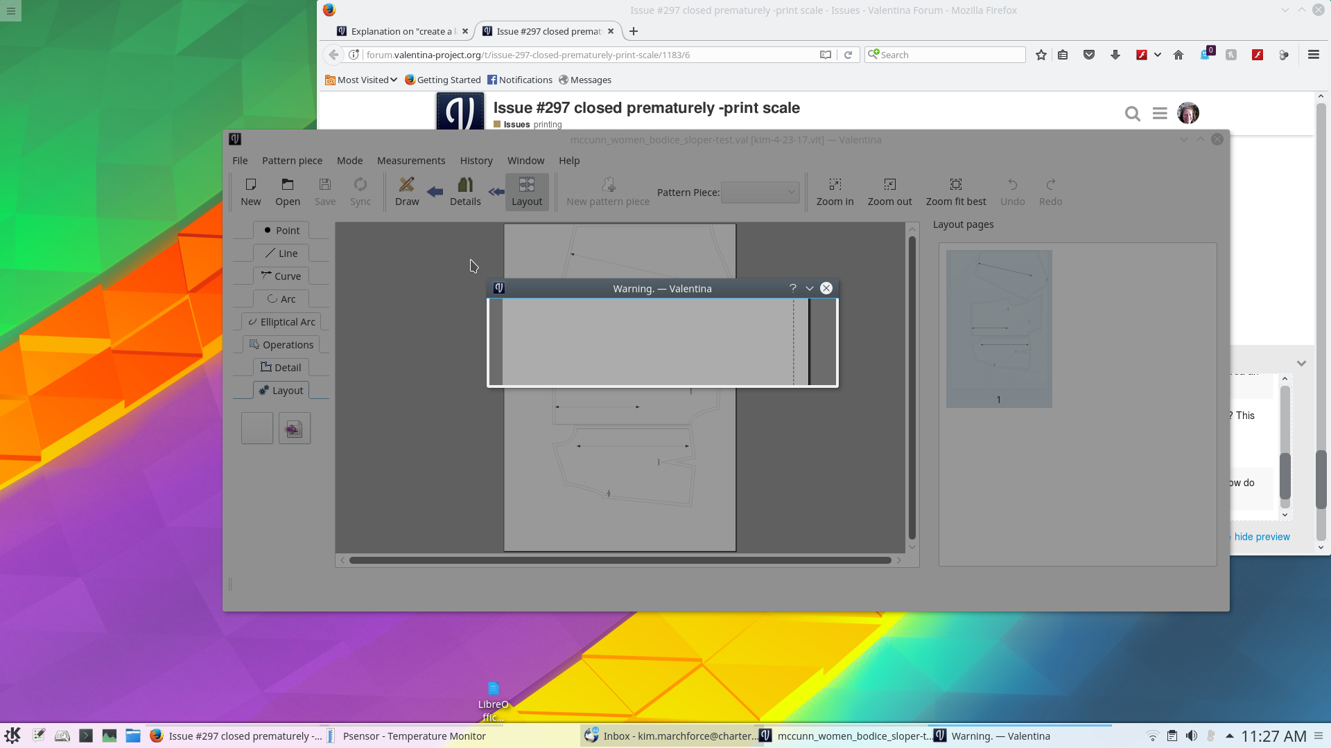

I am not sure what are the big doubts to which you refer. I set the layout to “ignore fields” and am now able to print a correctly scaled pattern. There are still problems, though. I used preview tiled pdf and printed individual pages. Valentina went “out to lunch”. Here is a screenshot
after 8 minutes, I clicked on the X to close the warning window. This resulted
