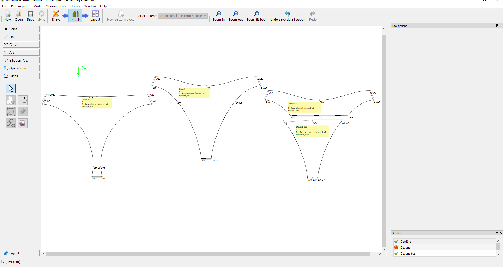

this is what I get opening the file

Hello @simoncotelapointe

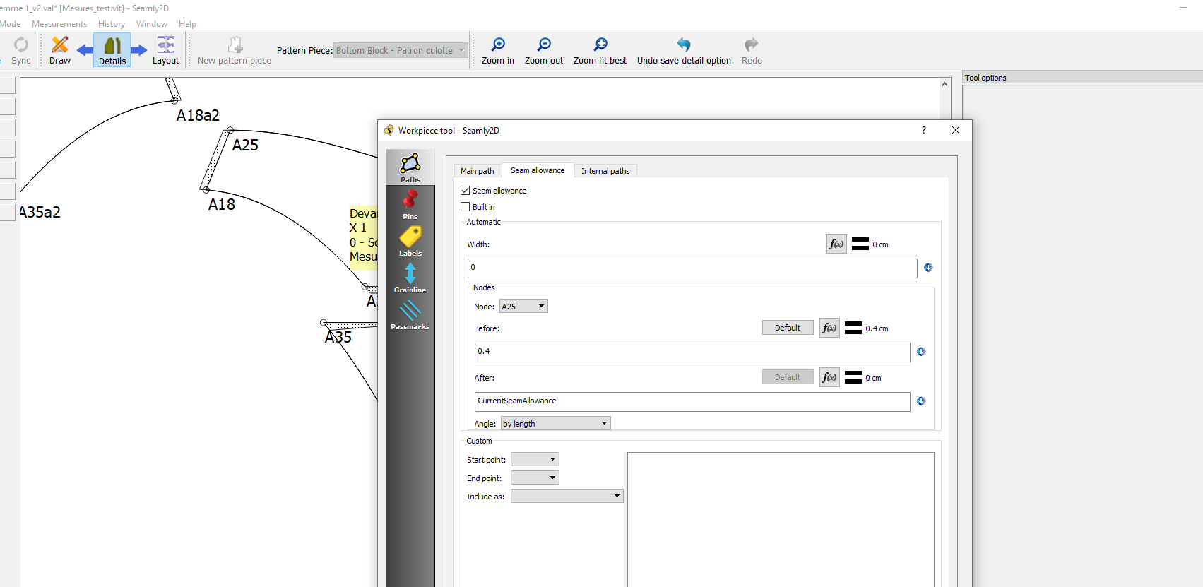

I see what you mean… image
You are trying to correct these seam allowances and the numbers are greyed out as if they won’t work and you can’t change them. And you’re right! Even though you have the amount in, it doesn’t want to change.

Yes, the numbers are also greyed out in all my other patterns and I can change the numbers, but with this particular pattern, I cannot change the numbers and the seams A35 and A35a2 are displaced and not removable.

Thanks for reminding me to mess with the actual pattern @Grace! The problem was not what I understood y’all to be saying, & was in fact the same in Linux.
The numbers could be changed, but they had no effect on the outcome. SO it felt similar to the problem I think of as “The Compass Rose Issue.” Therefore I slightly altered the curve that A35 attaches to, & I believe that, (at least with the measurements which were included,) it renders properly.
So, @simoncotelapointe, is this right? 0 - Sous-vetement femme 1_v2.val (26.2 KB)
Wow! @Pneumarian, that’s amazing!!. I tweaked one curve handle by about ,5 degrees and it all came right… Like magic :star_struck: :star_struck:
