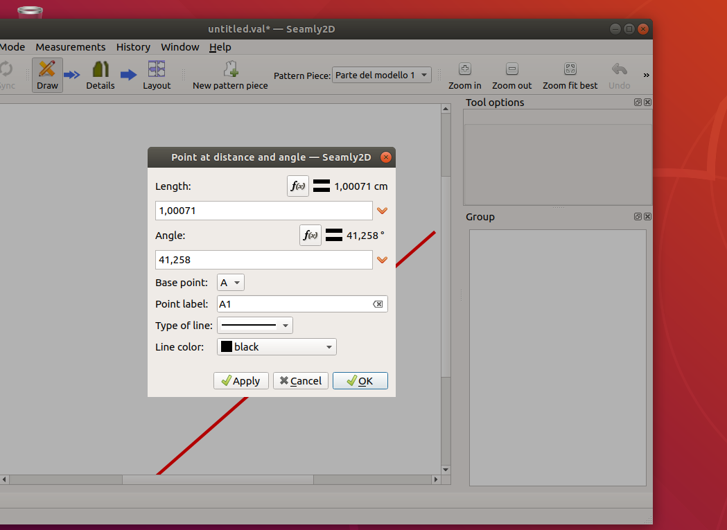

I use Seamly2d on Windows 10 without any problems. I installed Ubuntu on my new laptop and then I installed Seamly2d with the commands:
 sudo add-apt-repository ppa:susan-spencer/seamly2d
             sudo apt-get update
             sudo apt-get install seamly2d
When I use some tools, such as Point at distance and angle, a window will open. Usually in Windows 10 I can take the window with the mouse and move to see the paths below. But in Ubuntu I can’t do it, because all the Seamly2d window moves and change size.

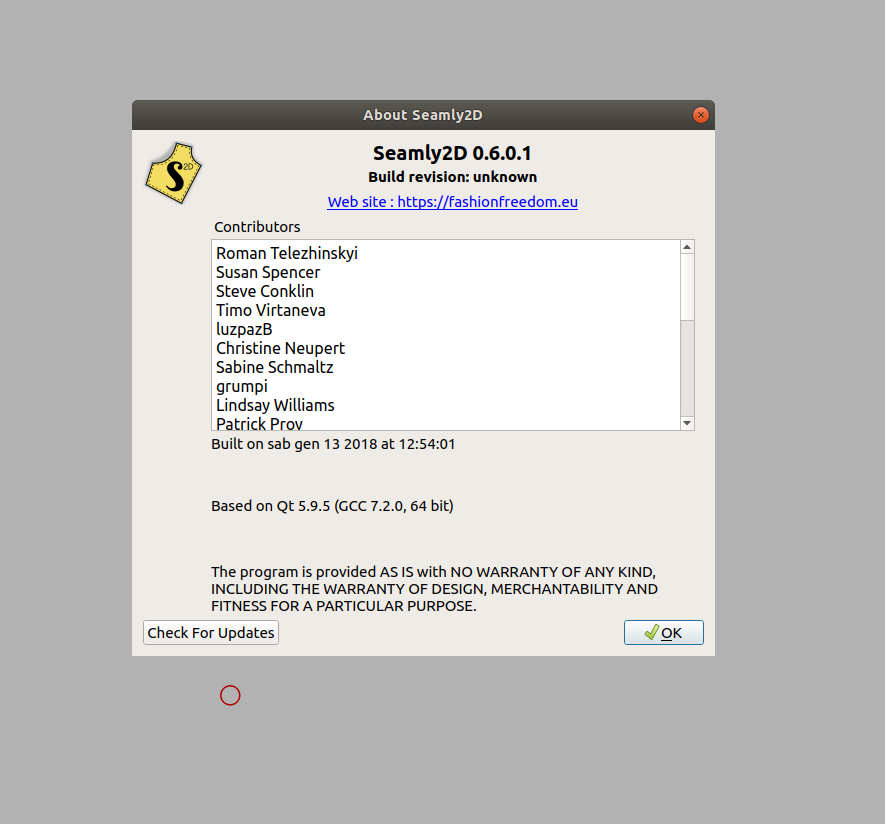

Can you please start with the Help menu item and tell the date and time of the build and version of Qt. These can be found in the window shown when you choose "About Seamly2D from the help menu

Thank you for your reply. I attach the screenshots. Qt 5.9.5 (GCC 7.2.0 64 bit). I try to attach a video, too. Because with the screenshots is difficult to understand the problem.Schermata%20del%202018-10-05%2008-54-47
