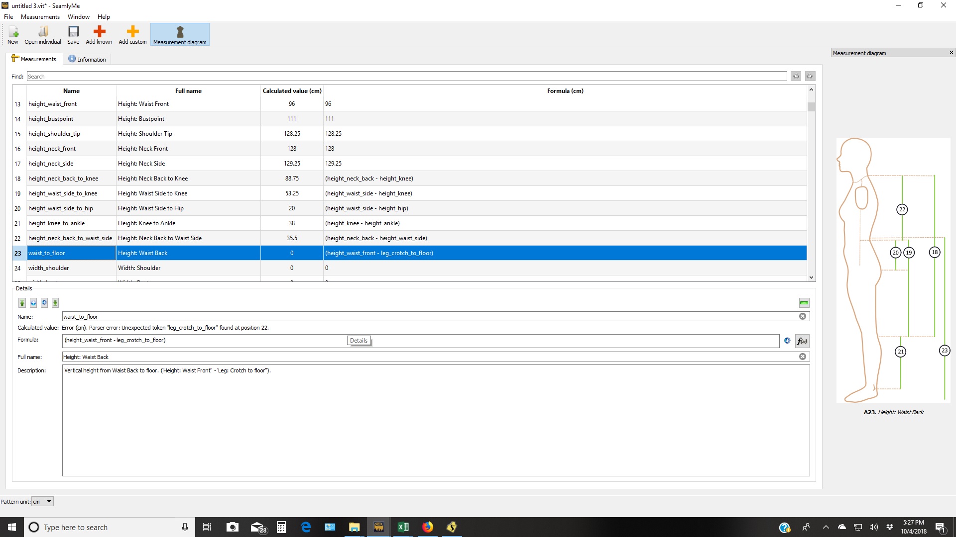

I could be wrong about this but I believe I have identified a flaw in the pre-existing formulae in SeamlyMe. I am in the process of entering an exhaustive list of known measurements to create a complete profile of my friend’s measurements. there are several measurements in the list with pre-existing formulae. I found this feature very helpful because it saves time and effort when entering the full list of measurements. I did encounter a problem when I got to measurement A23 Height: Waist Back. this is one of those examples where there is a pre-existing formula, however the formula reads: (height_waist_front - leg_crotch_to_floor). unless I am reading this incorrectly it cannot possibly provide the measurement intended. It seams more appropriate for calculating measurement N07 Rise length front. I understand that I can simply overwrite the formula and enter the actual measurement I took but I would like to use these formulae as often as possible when creating new profiles.

It is true. The formula in this case is incorrect. That fact is a documented issue in the queue to be fixed at some future point. For the time being, the workaround is to delete the formula and enter the measurement.
