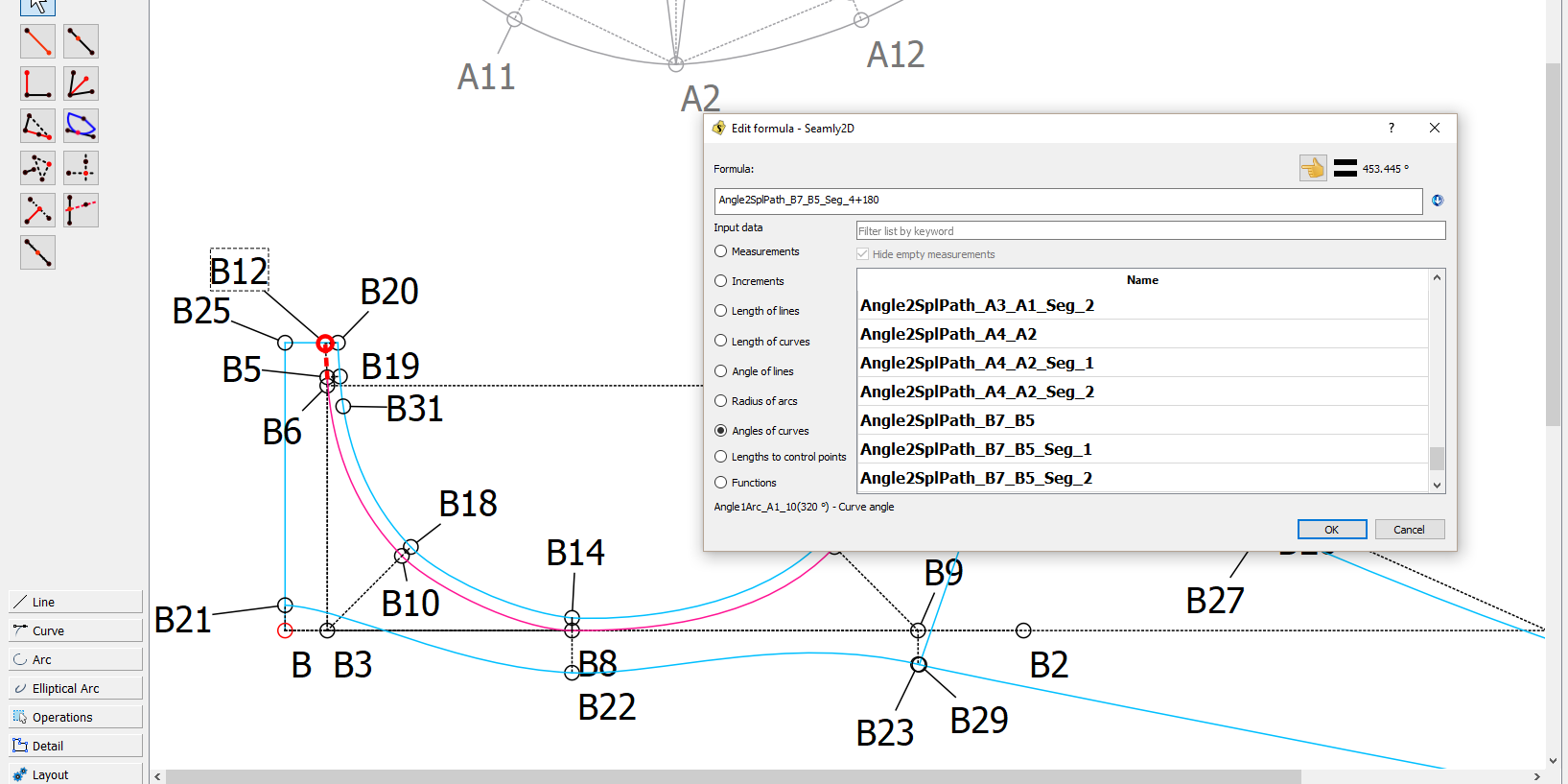

Can you scroll down in your formula window?
As you can see, after all the A’s you will find the B’s
Using the tool Point at ‘Distance and Angle’, create point B12, 0.8cm distant from B5 using the angle of segment 4 of the curve B7 to B5 and adding on 180 degrees.

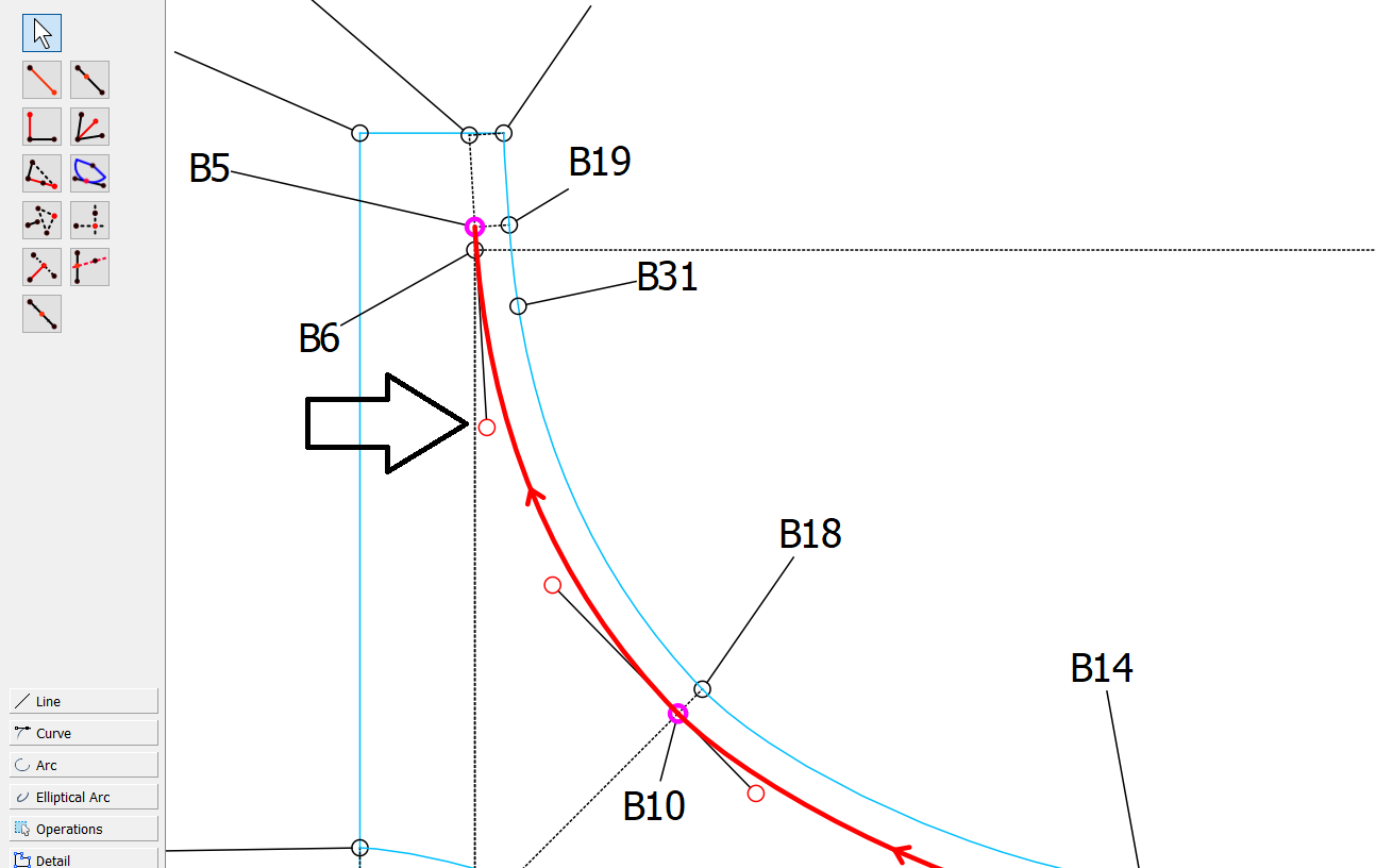

On your drawing the ending of the curve seems to have a little bent in it at point B5 Can you check if your handle for the curve B7_B5 is pointing downward in point B5?
Here you can see the handle is almost pointing straight down.

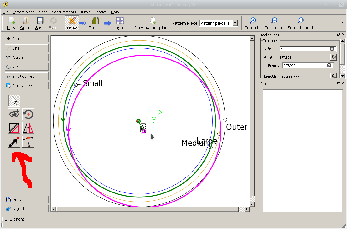

slspencer posted a video on how to use the move tool, please note this will move points and curves, you will have to draw new lines.
If you want to pivot, you can use the rotate tool
@AmandaClarice I have a hint that might help you with the move tool. As with all of the tools, look at the left hand lower corner for the prompt to tell you what to do next.
to use the move tool, you must have at least one object (a line will do) in a pattern piece in draw mode. Click “Operations” to open up that sub menu of tools. Click on the move tool icon (Indicated by the hand drawn red arrow on this screenshot)
In the very bottom left of the main Seamly2d window, you should see a prompt that says select one of more objects… You can click on an object (or objects) to select it, then press the ENTER key to confirm the selection. After that, it should be intuitive to move your mouse pointer until the object is where you want it. There will be additional prompts if you want to define an exact “sticking angle” for the move. A mouse (left) click should stop the movement and display a dialog box. It you are happy with the position, simply click “OK”
