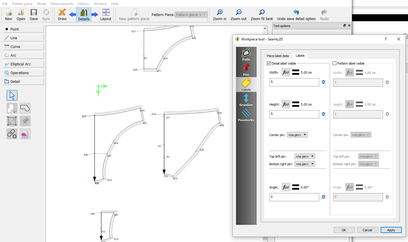

Hi everyone, I cannot seem to get my labels to be visible in V6. This is not an issue when I open an old pattern that already had the labels visible, only with the newly made patterns in V6.
What am I doing wrong?

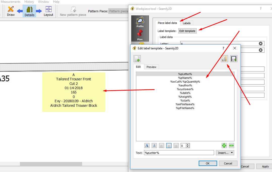

I’m not having any problems with mine. Have you setup the label template? I’ve made one for ‘On Fold’ and ‘Not on Fold’ that I use for all my patterns:
Here are mine, to get you started:
On Fold.xml (1.0 KB)
Not on Fold.xml (1.0 KB)
Thank you very much Grace, that fixed it.
