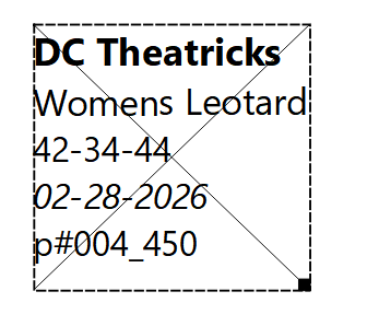

I have created labels and I have noticed an anomaly.
The file name var “pFileName“ contains the value “p#004“ although the real file name is “p#004.2_450(.sm2d)“ The var “mFileName“ does not appear to be filled at all.
Are there constraints upon the file name structure / permitted chars?
I have no idea why my text has been substituted with chars that I have not typed!

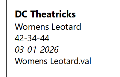

What is rather perplexing though is why the file extension does not show? :thinking: Anybody else think we should show the file extension?

Yes, I think that would be a good idea
Probably because there is (was) only one possible extension & the extension is not part of the meaning which the user has given the file.
But at the moment using that tag isn’t part of my workflow, so I can only imagine that it might be annoying either way. But there are still the Pattern Name & Pattern Number fields, & the Pattern Number is quite happy to be “bob”, so I think that gives sufficient options for anyone not wanting the extension.
There are 6 possible extensions - .val, .vis, .vst, .sm2d, smis, and .smms. IMO the label should show the extensions to give meaning to anyone else using the pattern.

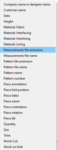

Ok… I feel dumb now… there already are file “extension” place holders for the pattern and mesurement files… Doh.
Screenshot 2026-03-01 113921
I probably never associated “Pattern extension” with the “Pattern file extension” and “Measurements extension” as “Measurements file extension”. :roll_eyes:

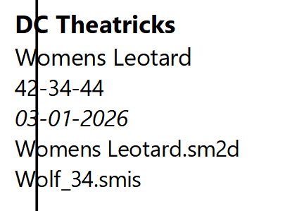

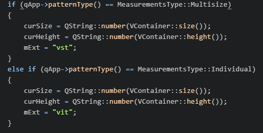

Big problem is…
Anyone see the problem?
The extensions are hardcoded, not read off the files. So they aren’t applicable to modern Seamly files.
Bingo! I made a Github issue and I’m already fixing it… will know in a few minutes when the compliler finishes. :slight_smile:

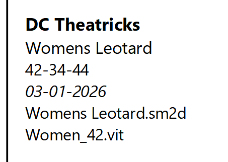

Fixed:
Ok - to make it cleaer - Besides correcting the typos of “Measurments” which apparently has been there since before forking, :roll_eyes: I also added “file” to the extension item texts in the placeholder drop down:
And made all the lupdates.
And just because it was driving me nuts… I made it so the placeholder list is sorted:
It was a bit tricky as the list is not a combobox, but rather a pushbutton with a popup menu of actions, which unlike a combobox, the items are not automatically sorted when inserted. :roll_eyes:
