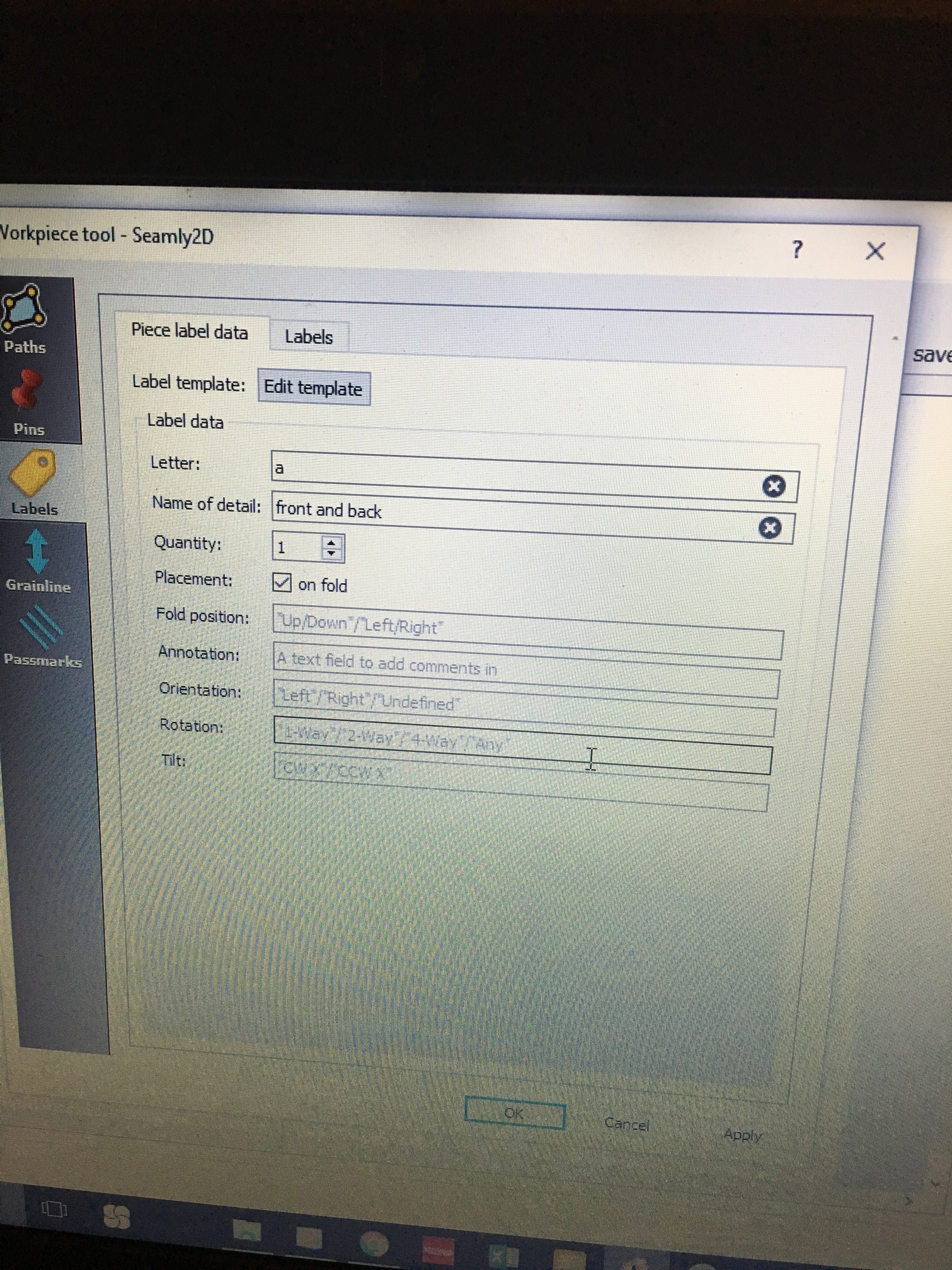

Hi everyone, I am new here and do not know how to upload photos. I have tried to label my pieces but it does not allow my to. My computer or labelling page seem to be different from the menu picture.
Does anyone have the same setting as mine?

Yes I have the same screen and problem; if anyone could help, many thanks in advance.
You might want to have a look in the other thread about this topic. Maybe the answer there helps you?
Hi @Angela , and welcome to Seamly2D
Since I wrote the ebook, things have changed a little. The programmers have made it possible that we can now add more data to the labels. To do this, you need to go to Edit Template by clicking on the button at the top of the image that you posted.
