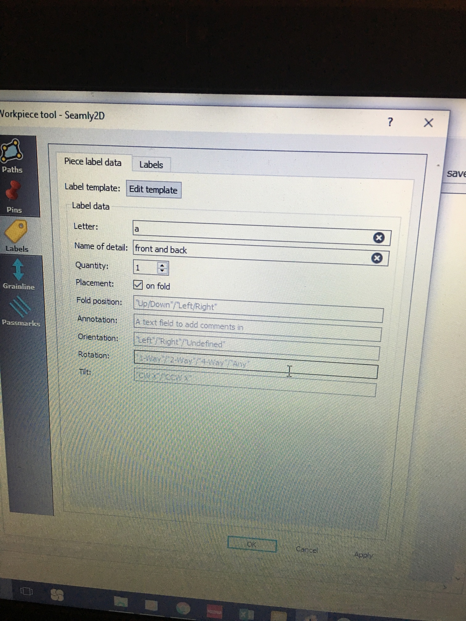

@Grace hi Grace, I am new here and found that you are rather active here hence the sending this message to you.
I am having problems of labelling the pieces that I have created. Picture here show is not the same the ebook menu. Can you help please?
Hi @Angela, and welcome to Seamly2D :sunny:
Since I wrote the ebook, things have changed a little. The programmers have made it possible that we can now add more data to the labels. To do this, you need to go to Edit Template by clicking on the button at the top of the image that you posted.
