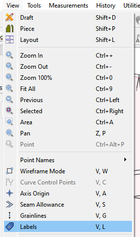

I’m going to assume you have created a template for both the pattern and piece labels and have checked in the option to show them. So I’m guessing that you have the label visiblity toggled off. You can toggle them back on with the View->toolbar:
The View menu-> Labels:
Or simply type V, L for View Labels.
And just a note… you can also toggle the Grainlines, Curve Control Points, The Seam Allowance, the Axis Origin point… and Wireframe mode (which will make a bit more sense with a pending update). For now this only affects the visibilty in Piece Mode, which is why you can see them in a Layout / PDF export.
The reason for being able to toggle these items off is for users that want to export different sizes to an SVG and then make a nest of all the sizes in another app like Inkscape or Illustrator without having multiple labels and grainlines.

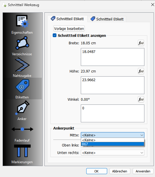

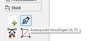

As far adding and setting anchors points… You can add an anchor point to a piece with the Anchor point tool:

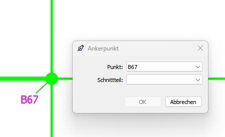

Select a point and which piece you want to add it to:
Then in the Pattern Piece Properties → Labels you can set which anchor point(s) you want to anchor the label(s) or grainlines to:

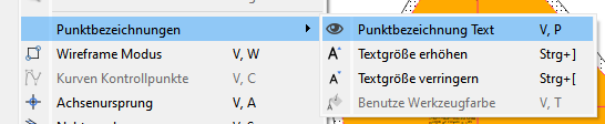

BTW… while we’re on the subject, and just to be thorough - the Point Names have their own toolbar:
But they also have a View menu item:
Thank you Douglas, that toggle button, hiding in plain sight in the middle of my screen, did the trick! Thanks also for the additional handy hints. Used them already :smiley:
