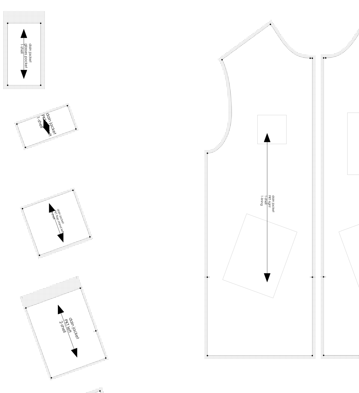

has this feature been implemented? i am also projecting the patterns so it would be helpful if grainline would rotate in layout.
i have angled pockets.
