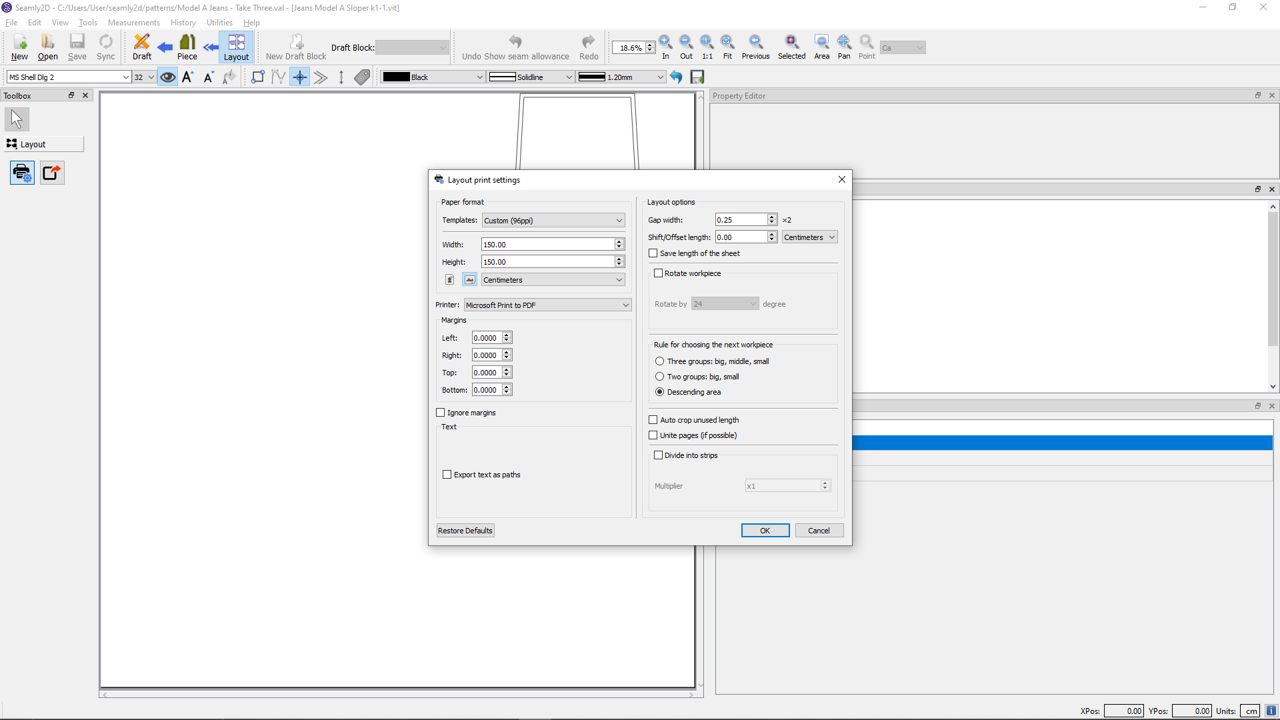

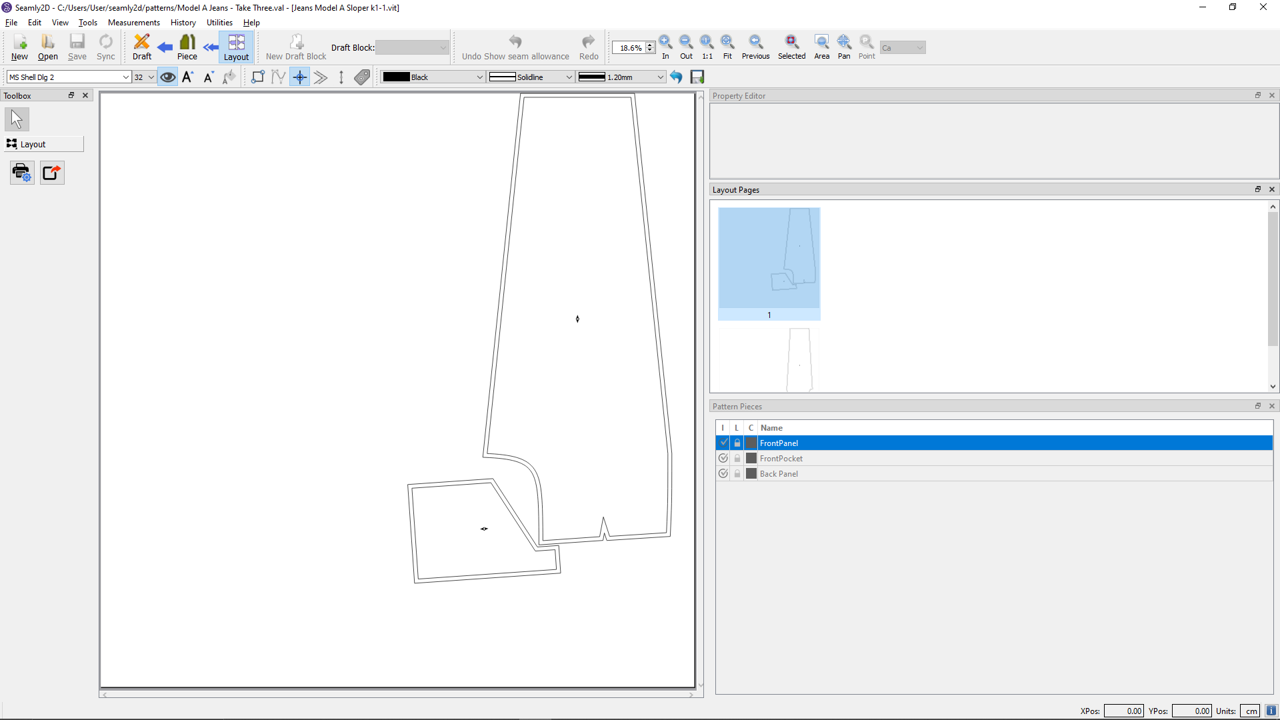

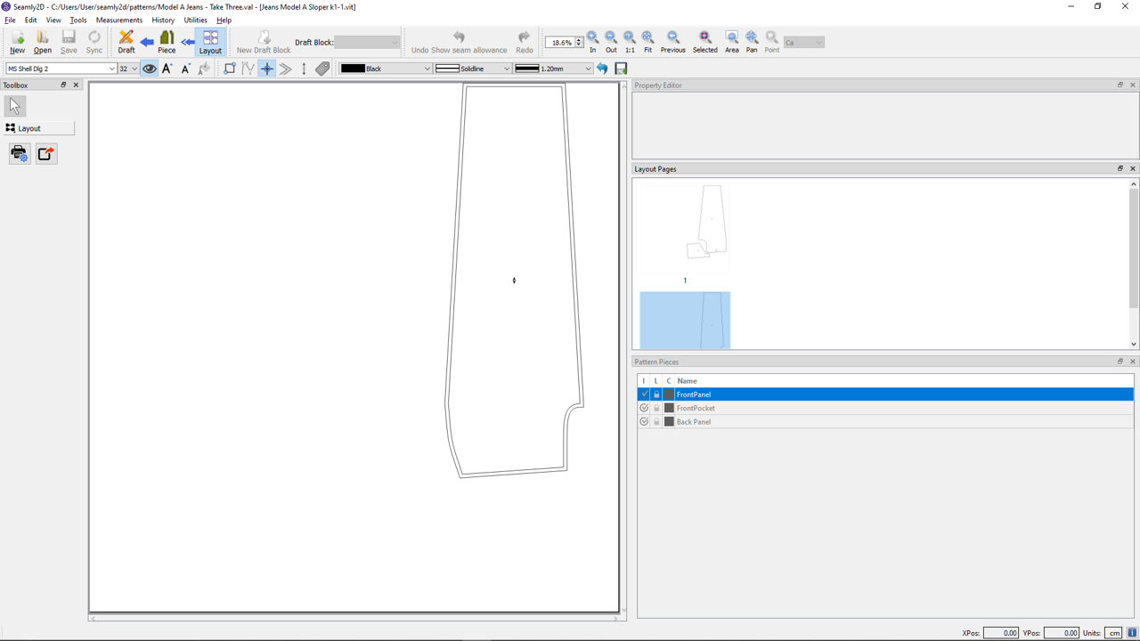

But the layout tab insists on separating the pieces out over more pages than is necessary! As you can see there is plenty of room in the large 150*150 canvas to place the other leg piece, but it doesn’t want to. Even weirder - it wasn’t doing this on a previous version of the pattern!
What do I do to correct this?
Have uploaded pictures of all the settings I can think of which might be interfering - although I have no idea what most of them do.

The other option in Layout mode is to change the paper width to custom and then enter an amount that you think will fit both pieces:
This is what I used to do before we had the option of exporting directly from the Piece mode.
In addition to what @Grace said, you could try randomly changing Layout settings. It’s a bit hit-&-miss, which is why Grace doesn’t do it anymore, but at times has suitable results. Maybe with a Custom paper size, like 84cm x 179cm, which I believe would fit three A1 which is smaller than two A0 by about 60cm, if I did my maths right.

Which by the way… that’s what the “Gap” setting is for. It’s how close the layout engine will place pieces.
That’s what I would do… figure out a custom size based on multiples of 8.5 x 11. You get better at it the more you make layouts, but it can still be hit and miss. It was much easier once we figured out how to use the vinyl cutter to plot at the shop.
