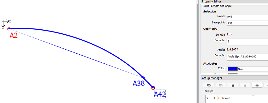

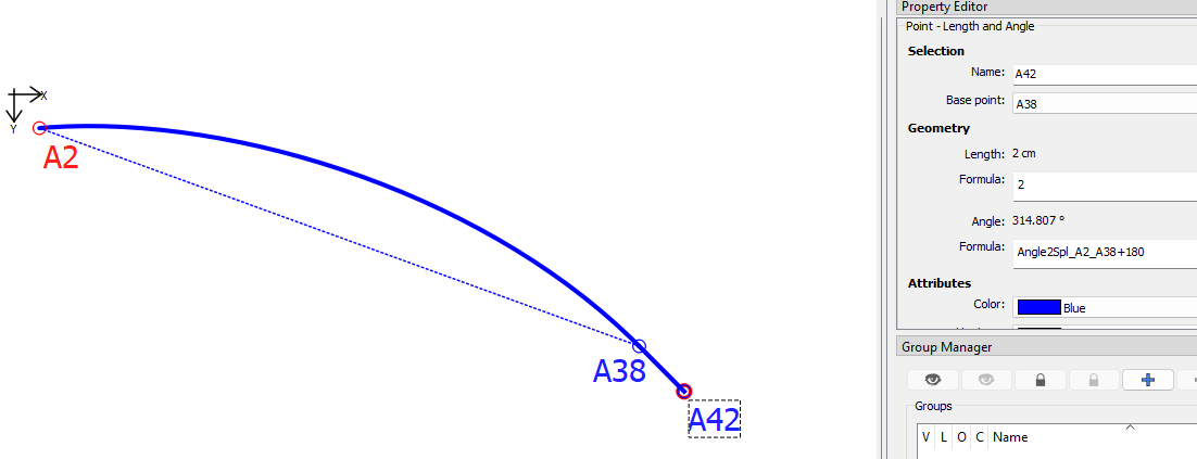

Reading the instruction, I’d create the concave curve as described and then, using the point at line & angle tool, I’d extend the line from point 38 at a distance of 2cm and for the angle, I’d use the angle of the control handle at point 38 plus or minus 180°.
Something like this:

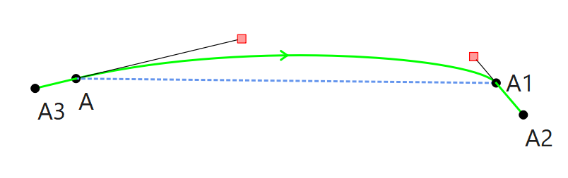

More specifically the angle of the curve’s start / end point ± 180.
Note that given only extending 2cm that this will work fine as long as the control point length is long enough so there is a smooth extension without kinking.
Point A3 - OK
Point A2 - No good.
