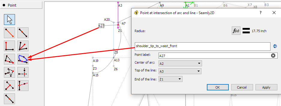

How about using the Point at intersection of arc and line?
The 48.5 would then be the radius of the arc

Your first point of the line should be A2, the 2nd on A6 because this is the line that the point needs to be on. Then the axis point is A with the distance which can be a formula.

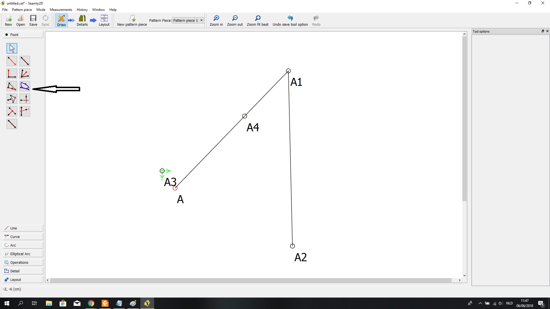

Another way would be to use the arc tool to measure an arc from A to cross the line A2-A6, from about 90 degrees to about 160 degrees and then use the Point Intersect Arc and Axis tool to create a point at the intersection.
Which is basically what the Point at Intersection of Point and Line does, it’s only quicker and cleaner since it doesn’t add to the spider web of lines and arcs that one has to see through once your pattern starts getting really complicated :slight_smile:
Hey,
I made a little video on how to do this. This basicly draws an invisible arc from your point A to where it crosses your line A2_A6
Instead of the 17.25inches you would use your 48.5 cm or formula
Afterwards you can use line between points, to actually draw this line.
