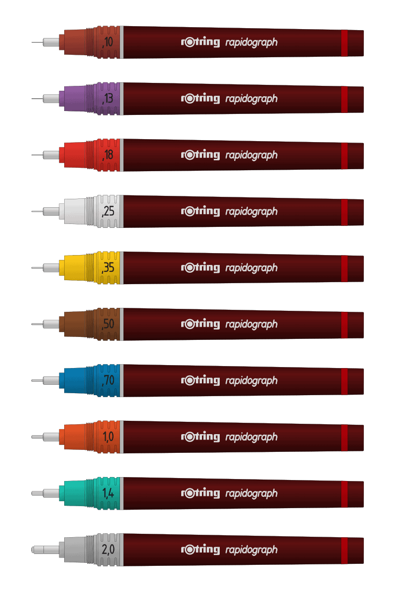

And for those familiar with drafting pens from the likes of Rapidograph, the width is color coded as per ISO 128:
The reason I mention this is in some manner I would like to add an option to semantically tie the ISO line weights & colors together… where if you select a line width it automatically sets the color or vice versa.
