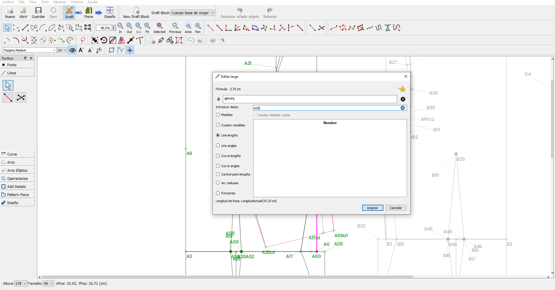

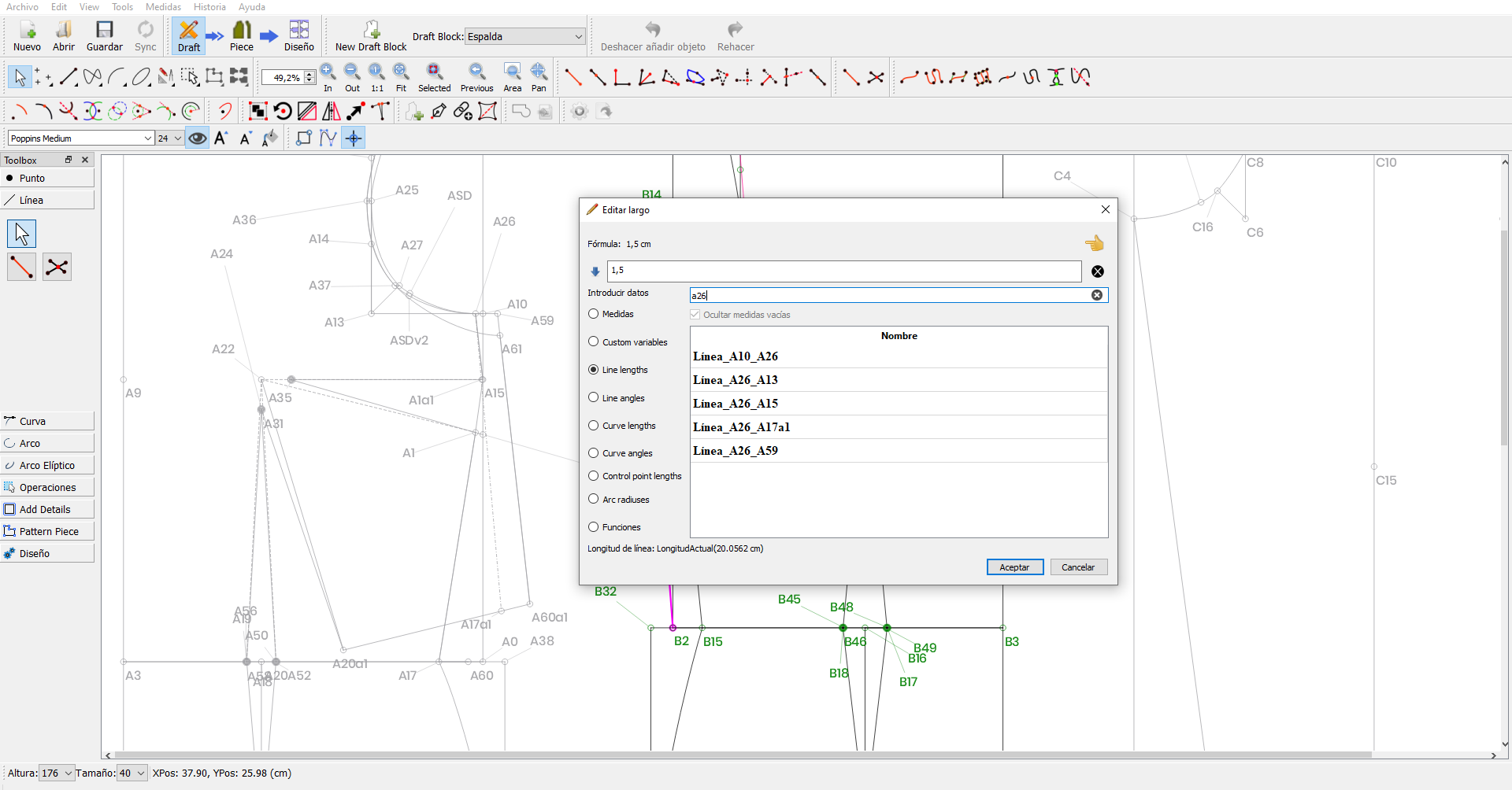

I have problems creating a formula in one of the pieces of the pattern, specifically, in the piece " cuerpo base de mujer " in the attached files (.val .vst). This is because not all the lines that are created in the pattern appear in the formula menu “line lengths”. (Screenshot 1 and 2)

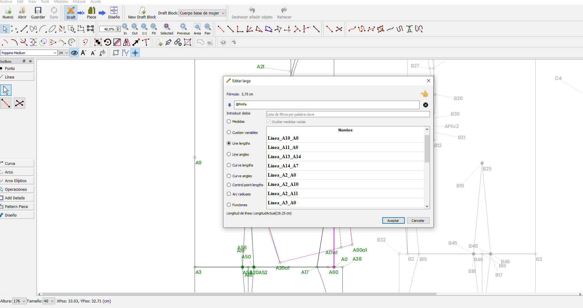

However, all the “line lengths” of the " cuerpo base de mujer" piece do appear in the formula menu of the rest of the pieces, such as “espalda” or “manga”. (Screenshot 3)
What could be happening and how can I solve it? Also, What can I do so that all line lengths appear in every piece?

Am I understanding correctly that you are trying to edit A16 to be placed using a measurement involving A26?
If so, then what we’re seeing here is a time-travel issue. The creation of a previously created item cannot be based upon the status of a subsequently created item. Looking in the “Historia” menu, I see that that is the case here. The only exception is that all of pattern block B comes after pattern block A & before pattern block C, &c. even if you drafted them out of that order. The devs have discussed implementing an algorithm to allow expanded time-travel, (as long as the time-streams aren’t crossed,) but other issues have been more important so far.

Thanks for your support. Yes, we are on the same page as per your understanding.
Does this mean I cannot use measurements created from the back pattern (B) in the front pattern (A)? Also, I can see all the measurements from A in the other two patterns but not in A itself, which confuses me.

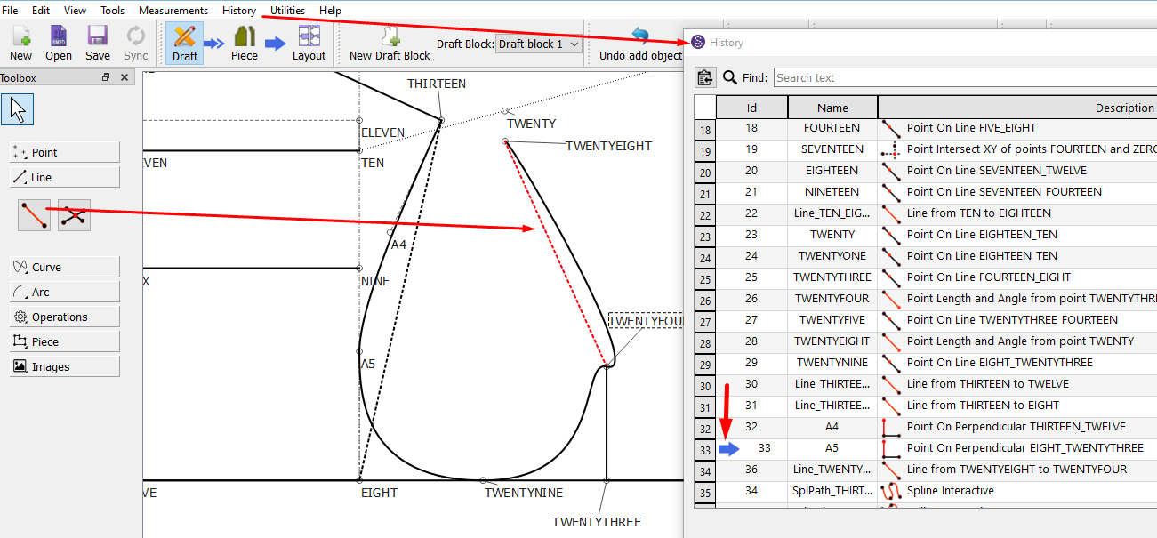

You can view the order of creation by clicking on the History tab or hitting CTRL/H:
The only way to save the certain line lengths is to create them at a point before they are needed (and this is what @Pneumarian means by Time Travel :grin: which came about when we were teaching someone to use the History).

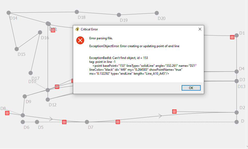

The history will crash if you add a point at a previous place and then add something else using the new point without moving to then next line in History.
I feel like I’m time travelling again, so if you don’t understand, I’ll make you some pics :slight_smile:
Once you’re done using this crash feature :grin: Perhaps you can change it to automatically move down to the current line added instead of staying in the same place and adding stuff below it.
1 « J'aime »
I completely understand. Like I said it’s actually too easy to intentionally crash the pattern randomly adding something to the history. Actually I already crashed it several times… it throws up the exception error and then the draft scene is all greyed out after closing the message box. A user has to figure out to close the pattern… if you’re lucky you can open the pattern again - possibly loosing some recent changes. The single autosave restore feature only works when the app totally crashes and you have to restart the app with xxx.val.autosave files existing. What should happen in this case where the pattern crashed and the scene is greyed out - the user should be presented at THAT point with a dialog asking if they want to restore the pattern from the autosave file - not be left looking at a greyed out screen. Back to the drawing board.

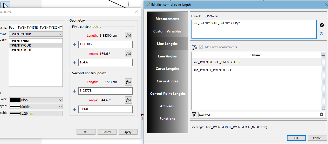

I was having issues trying to get a specific line to show up in the line length section, so I made a 45-second screen grab to demonstrate the problem. I found this question that seems similar, but I’m unsure if it’s exactly the same issue I’m facing (or how to fix it).
In short: Is what I’m facing here also a time travel issue? The line I want to base the length of the control point of the spline off of is newer than the spline itself but I face similar issues getting it to show up even when I add a random point. It still won’t let me make that point the length of the line created in the video.

You can use the Menu > History > History to place a line prior to the spline that you want to reference it in, as long as the other points are existing or that you add them before placing the line.
Click on the last line before clicking on OK:
Like this:
Then you will be able to use the line in your formula:
I hope this solves your problems at the other places, too.
