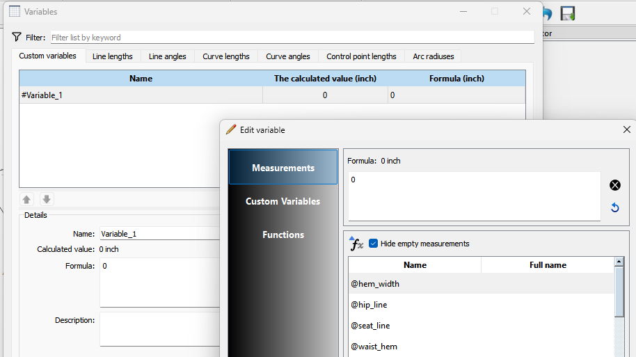

I would like to know if anyone can advise me on some ‘issues’ concerning the use of this facility.
For specific reasons, I would like to keep a track of some of the measurements maintained by SeamlyMe in the ‘Database’ and keep a track of possible mismatches of specific dimensions of pattern-piece lines, arcs and curves (Splines etc) which may occur when I change the path of a curve (for example.)
I have tried to store data from a) the current pattern that I am working with, and also from the loaded SeamlyMe database … all to no avail. This would be of great help to me if one of you Seamly2D / SeamlyMe Titans could advise me on this.

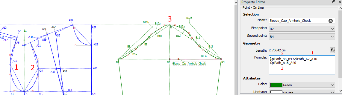

Here’s an example of a ‘trip-wire’ taken from the Zoom lessons. We checked the sleeve cap curve to see if it would fit the armhole curves:
This way, if you hover your cursor over the point, you can immediately see that it is approximately the accepted difference of 1 inch:
In this case, if you’re not happy with it, then you could tweak the cap height or width to get it more exact.

Again… Seamly uses a sequential timeline and is not like Excel, Word etc. To compare Seamly to them is pointless. You simply can’t use tool variables such as a line length in a custom variable. Why? Besides the formulas, and timeline, the “local-data” changes everytime a pattern is parsed. Anytime you do something that requires a full parsing the pattern, it clears the data, it clears the history, it clears the pattern pieces, it clears the draft & piece scenes, it basically dlete everything… then re-reads the (in memory) dom document from the start as if you just opened the file, loads the variables, and builds the pattern again one tool at a time. If it’s a lite parse it just clears the data, and rebuilds the pattern. In either case measurements never know any custom variables, custom variables never know about any tool variables, point A1 never knows about point A2, Block A never knows about block B… and so on. You asked what (custom) variables can do or not do… I answered how they fundamentally function. If you’re asking “how” or in what situations they can be used… that’s a different question altogether.
That falls under things like using a custom variable to dynamicaly define ease or number of darts. Such as:
#ease = (bust_circ > 48 ? 4 : 2)
#darts = (waist_circ > 30 ? 2 : 1)
But again something like:
#armhole_length = Spl_A1_A2 + Spl_A2_A3 + Spl_A3_A4
Is not possible, as custom variables can only use existing custom variables or mesasurements.
