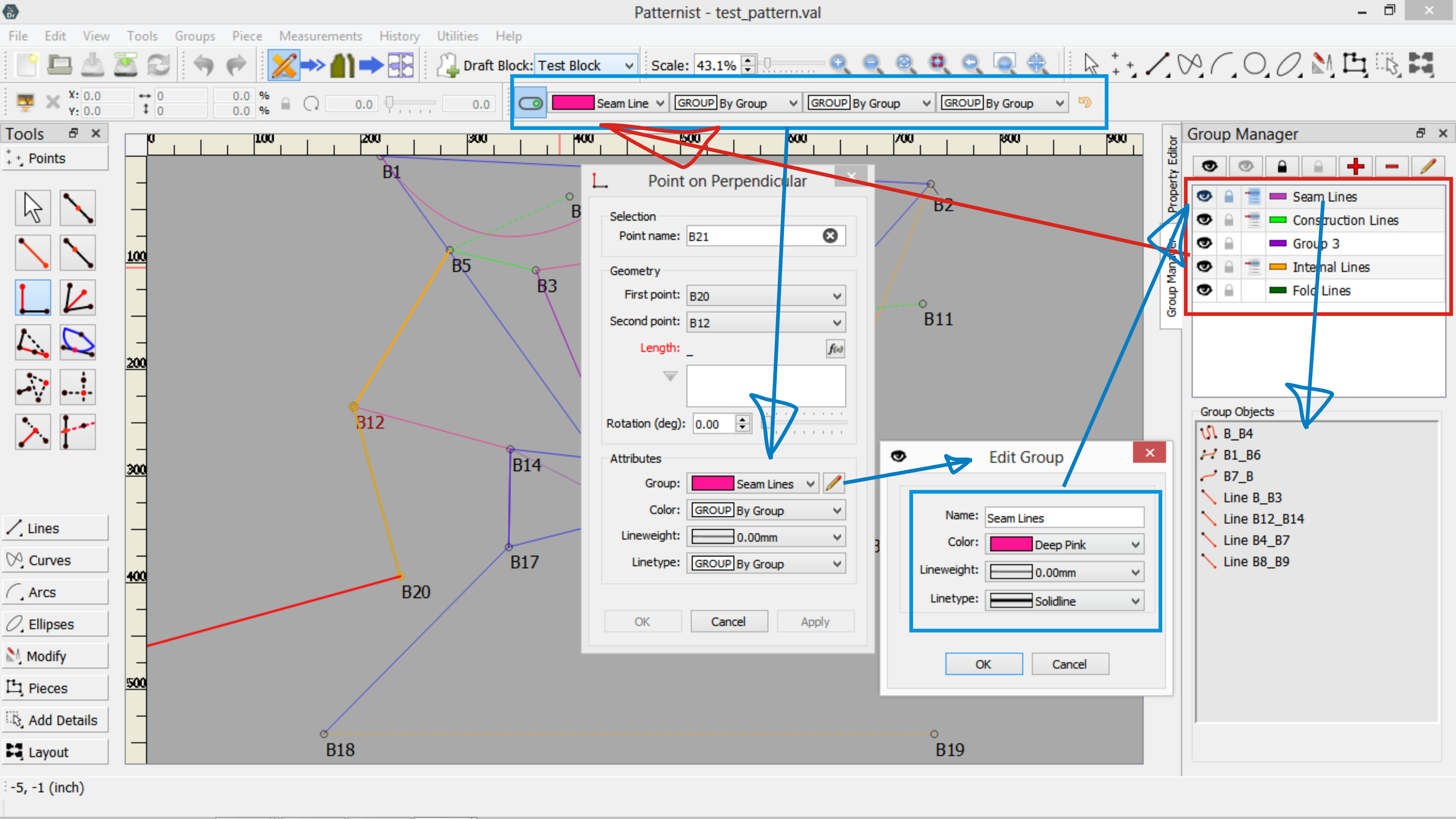

Yes. In my fork I redid the the groups dock, and there is a color icon for each group. Actually I changed the paradigm of groups … instead of creating objects and creating a group on the fly when adding objects to a group, I have a group manager where you can create groups… edit a group’s properties like color and line type. Then when you create a new tool object you can select which group to add it to. You can delete or move an object to another group by edit the objects group property. I also retained the existing manner of adding an object to a group via the drop down context menu.
In recent discussion on coloring a tool’s point name text… when I port the groups to Seamly2D I will probably impliment some sort of group style presets, so that a group of users can use a standard style preset so everyone would be on the same page when sharing or working on patterns. So if one where to say foe ex: the powder blue dashed line… might mean a construction line - which maybe translates to an internal path in piece mode. Will definitely wants some input when I get to adding the new groups features.
Here’s a screencap showing the Group manager dock… each group list item has a color icon indicating the group color. Or may change the icon to reflect the color, line type & line weight? You may also note that there are lock icons so you can lock a group. Also note that there is another widget that displays a list of objects in the group. Eventually the idea is enable drag & drop so you simply could drag an object into a group.
groupmanager

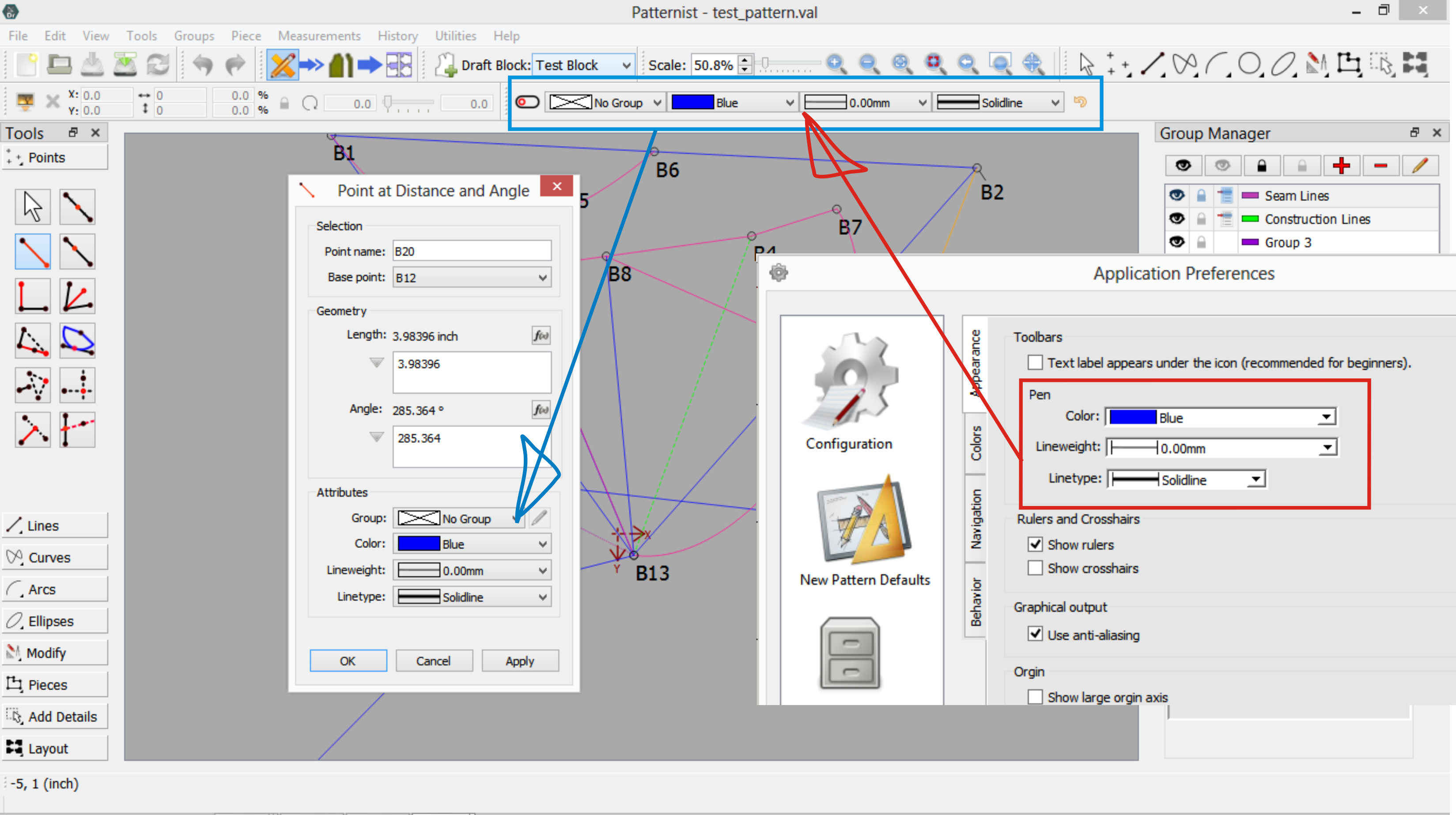

So… Here’s the Pen Style Toolbar and the Preference dialog to set a default pen that the toolbar is set to when the app starts. BTW… from a coding standpoint, I created new subclasses of the combobox to handle the color & linetypes, where instead of having to code the comboboxes on the fly, you can simply add and promote a combobox to a ui form in Creator.You may note that the comboboxes will now have a consistent look with a same sized icon w/ item names… not this mess:
mess
The Pen Style Toolbar also contains a Reset button (Alt+R), that will reset the current color and linetype combo boxes to the default settings.
PrefLA
In what is a small, and yet big change to the workflow is that now when adding a new tool, the color and linetype attributtes will initially be filled by the current pen style displayed in the Pen Style Toolbar. So if for ex: you want to draw a series of Dot / Deep Sky Blue lines, you won’t have to keep changing the combo boxes from Black / Solidline with every new tool added.
Below is an updated look of the former “Endline” AKA Point at Distance and Angle tool… the Point - Length an Angle tool. All the new dialogs will follow a reorganized clean layout of Selection, Geometry, and Attributes. Eventually this layout will replace the inconsistant look / opertion in the Properties Editor. Gone are the useless giant equal signs, as well as the “grow” buttons that serve no real function other than taking up dialog space and adding junk to code base. Normally a text box widget (set with word wrap) will automatically add (as you type) a scroll bar if more text lines are needed, so I have no idea why the expanding junk is there? Also to note, currently, if you type past the 1 line of text WITHOUT clicking the expand button you may get:
old
NOT ACCEPATBLE. Now you will get:
new
PointLA
Only about 34 more dialogs to go. :slight_smile:
