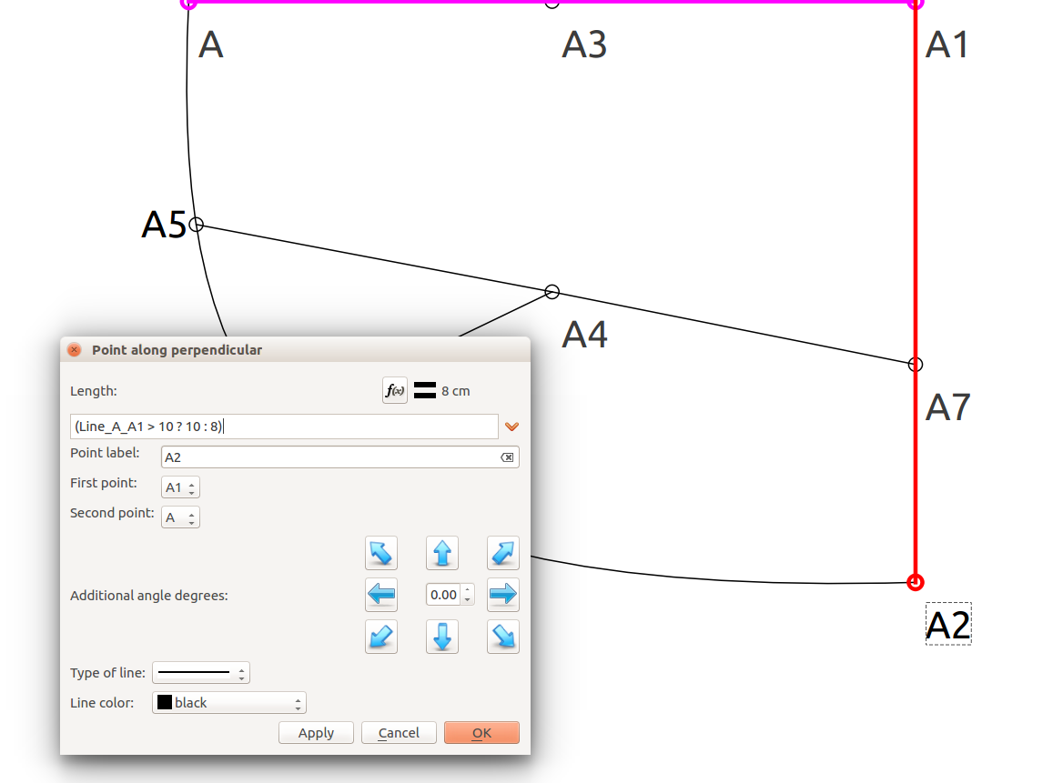

Valentina’s muparser math processing library will allow you enter if then else statements, in the form of ( (a operation b) ? c : d) Read this as: If (a operation b) is true THEN c ELSE d
This example works: (Line_A_A1 > 10 ? 10 : 8)
Read this formula as: IF (length of Line_A_A1 > 10) THEN 10 ELSE 8
