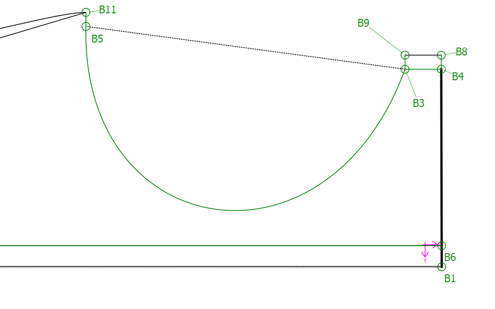

Hi, I’m drafting a bra and get stuck on getting the lowest point of curve. On paper draft it would be easy to me, but how to do it in Seamly? Thanks for your ideas :slight_smile:

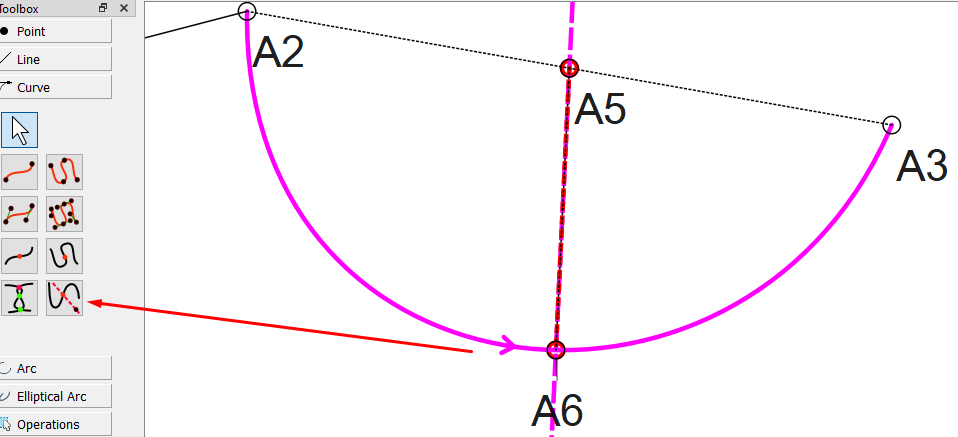

I’d make a node in the centre of the line B5 to B3 and then use the Interect Curve & Axis tool. First select the curve and then the new node and ‘eyeball’ it to the place that looks like the lowest point :grin: and press enter:
Hi, Grace, thanks for your answer, but I’ve already did this. But I really need the point to be accurate :frowning:
Could you explain why you need the lowest point on the curve? From a pattern perspective I don’t understand what that accomplishes… the lowest point is dependent on the rotation of the draft block. For example… If I rotate my laptop screen the lowest point will change.
And how would drafting it on paper be any more accurate?
That being said, if you did as Grace suggested, and then by trial and error change the angle of the axis until you find the longest length of A5 to A6, you will have found the lowest point - given the curve being relatively circular in shape.

@petulinkax I’d probably try bustpoint_to_bustpoint/2 starting from the centerline & going along the line below the curve, & hope a straight vertical was close enough.
I would think it would scale with the measurements. But again, I fail to see the purpose of the “lowest” point. If it where an an axis intersection point perpendicular to the midpoint of B5_B3, then it would make sense.
That being said, given the use of a curve VS an ellipse (circle), I don’t see a way to exactly find that tangent point of the curve and a horizontal axis with the tools available. I’m sure one could solve an equation of the curve based on the start / end points / control points to find the lowest point, but that’s really beyond the scope of the app.
If I may ask, how would you find that lowest point if you were doing it by hand? Perhaps we can translate the manual way to Seamly way.
T-square (or ruler) and triangle… line the triangle up on the vertical, and draw a horizontal tangent to the curve… and pretty much guess where the tangent point is. About as accurate as you get with what you suggested. Besides… how accurate does it have to be? It’s a bra. It’s not like machining engine parts to 1000’ths of an inch.
Problem is, without using an ellipse (circle) there is no way to determine the center so you could create a point using the intersect axis - curve with a vertical axis angle of 270 degs.
I’m more interested in why the lowest point?
I think it’s the design. From that lowest point, one needs to make 2 sections (at least) with curved edges to shape the cup to the breast. and the lowest point is probably where the 2 sections will meet, so it will need a notch on the pattern at that point.

I would have to see the big picture to understand the need for the lowest point. If it’s just a case of locating notches, accuracy on the curve shouldn’t be an issue… just use the length of a curve section to locate the matching notch.

Lowest point (as @Grace wrote) is about design and notch, but it has to be there :smiley: This curve is a wireline, wire has been cut but I don’t know the original length/width, just the position in bra… It’s disappointing :smiley: If I knew the measurements, it would be easy (with a circle) :frowning: If I locate the point 2mm and more out of the lowest point, the bra will look odd. That’s a thing you find out only when bra is on the body… The notch marks a seam on cup going to bust point and without it I can’t even make the cup pattern :smiley:
If it’s not possible right now, I’d have to guess where the point is.
Thanks
Another way would be as @Pneumarian suggests… Establish where the bustpoint would normally be & use the same tool that I suggested at a 270° angle (downwards) and this should normally be the lowest point on the curve, since it’s normally the measured distance from bustpoint to low bust line.
Well… if you’re only concerned with one size, you could print out the pattern as it is now. You can now export a draft block in the latest ver… print & draft the point on paper… measure the distance along the curve from one end or the other, then go back in Seamly2D and add a point along the curve at that length. If you need to adjust to more than one size… I’d add a midpoint between B5_B3. Find the angle between the midpoint and the point on the curve you located, and create a new point from the midpoint and an axis at the angle intersecting the curve. That way the point will scale reasonably well.

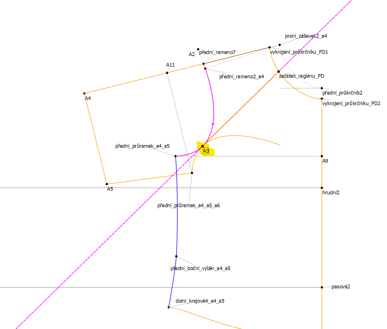

I was looking for an advice about finding the lowest/the most protruding point on a curve and I found this topic. If I understand it properly, it actually can’t be done unless the curve is an arc, is that so? :frowning:
I am looking to solve this:
I need to find A3 on my pink curve (front armhole); A3 resides on a tangent of the armhole + the tangent goes through the point začátek_raglánu_PD. Sure, I can guess A3 without much harm but resizing the pattern than doesn’t scale nicely and I have to edit the A3 location after each resizing. I would be grateful if there would be a way to express A3 with formulas.
I am using the “Point - Intersect Curve and Axis” tool for finding A3 now.
Thanks!
