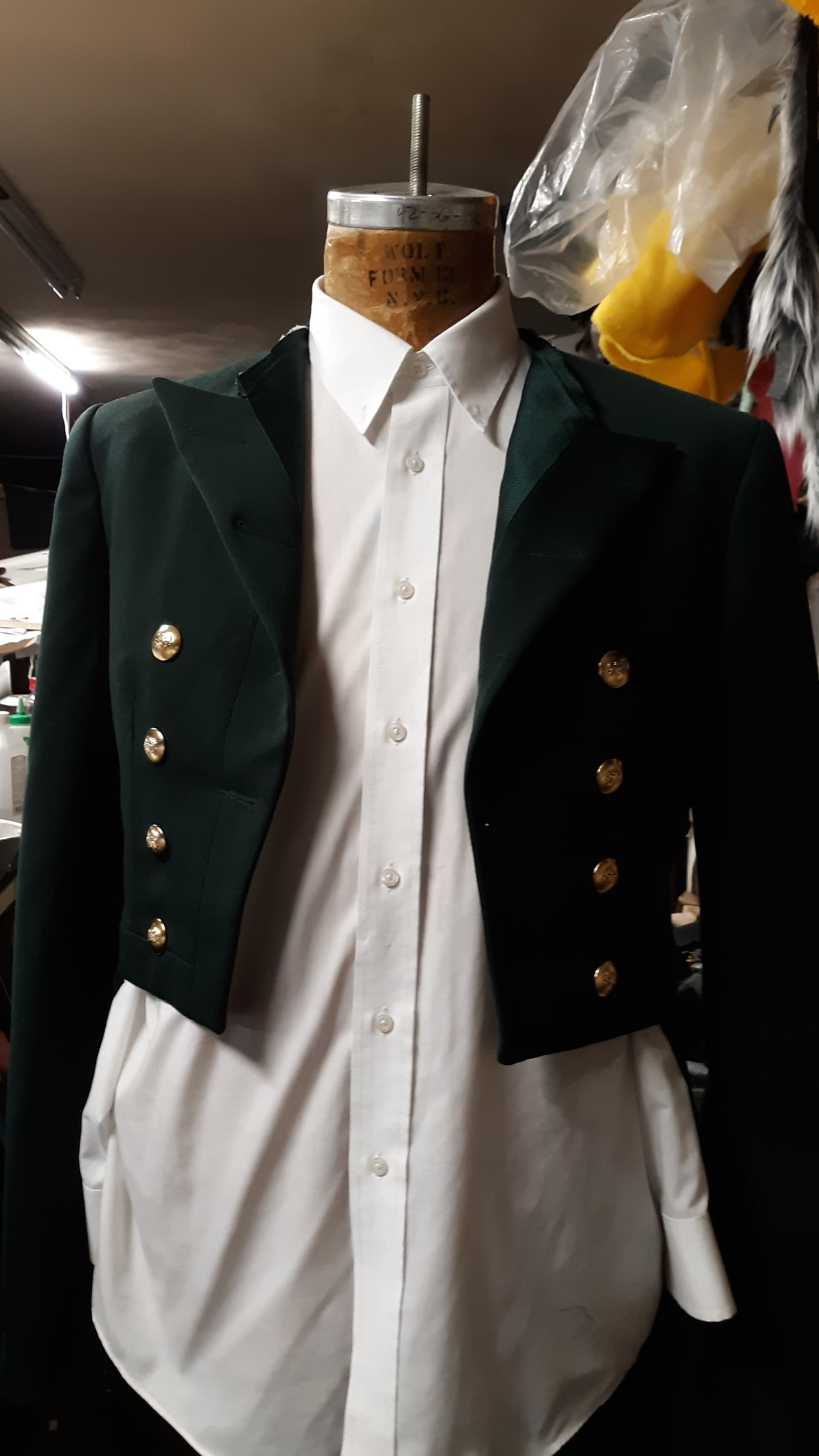

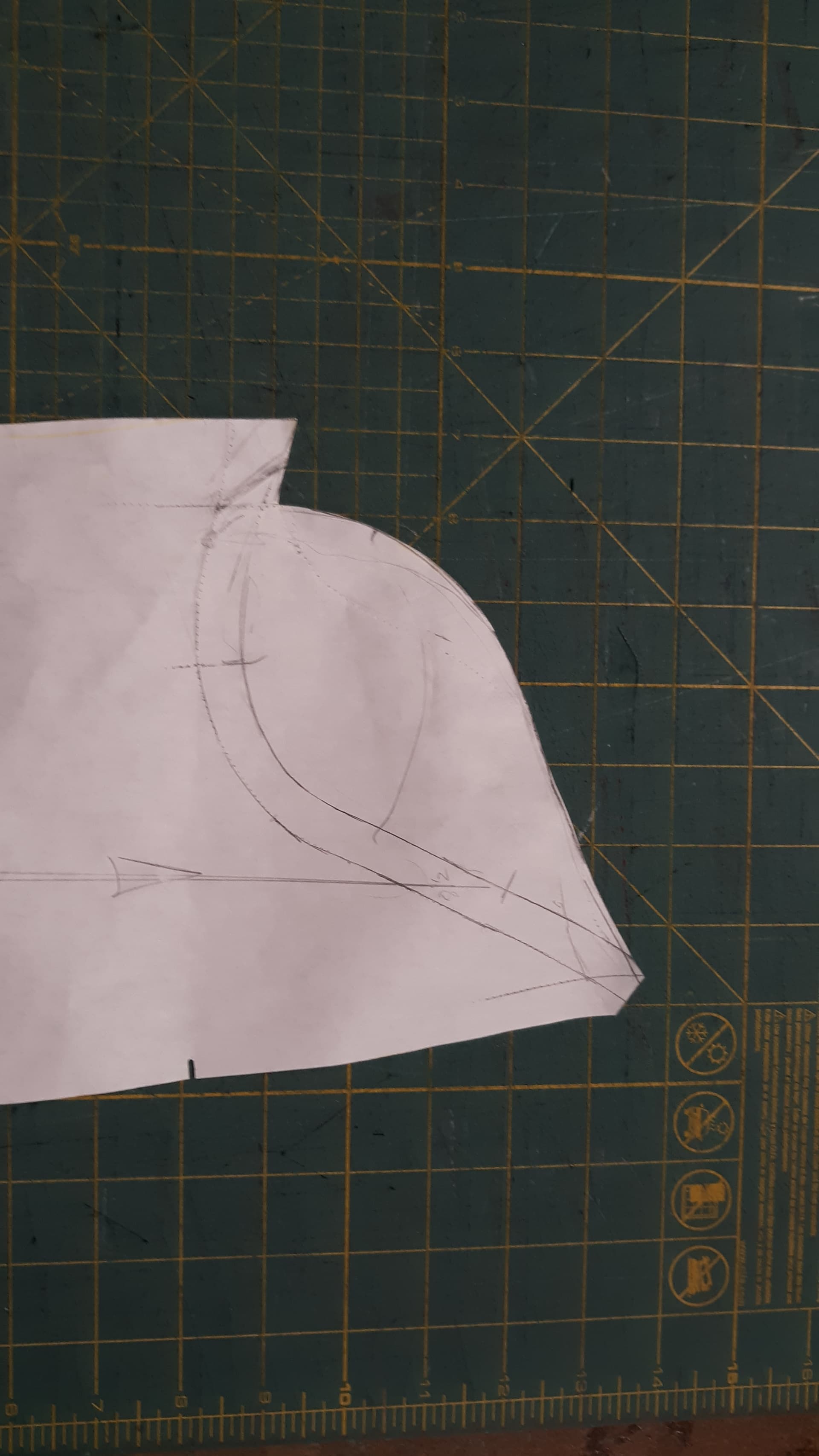

Which is PRECISELY the issue I’m faced with this very moment. I have to recut the top part of a sleeve because it needs more cap fullness. :frowning: Of course the whole sleeve pattern is compounded by the fact they need built in gussets.
Ah… yes, so they can dance and move their arms around. How would a built-in gusset look on a pattern? and especially a jacket pattern? since the side seam is normally moved a little towards the back. Hmmm… An interesting dilemma :slight_smile:
I found a bit on the subject here:
Very interesting.
This is what I love about pattern making… There’s always something new to learn about :star_struck:
Exactly.

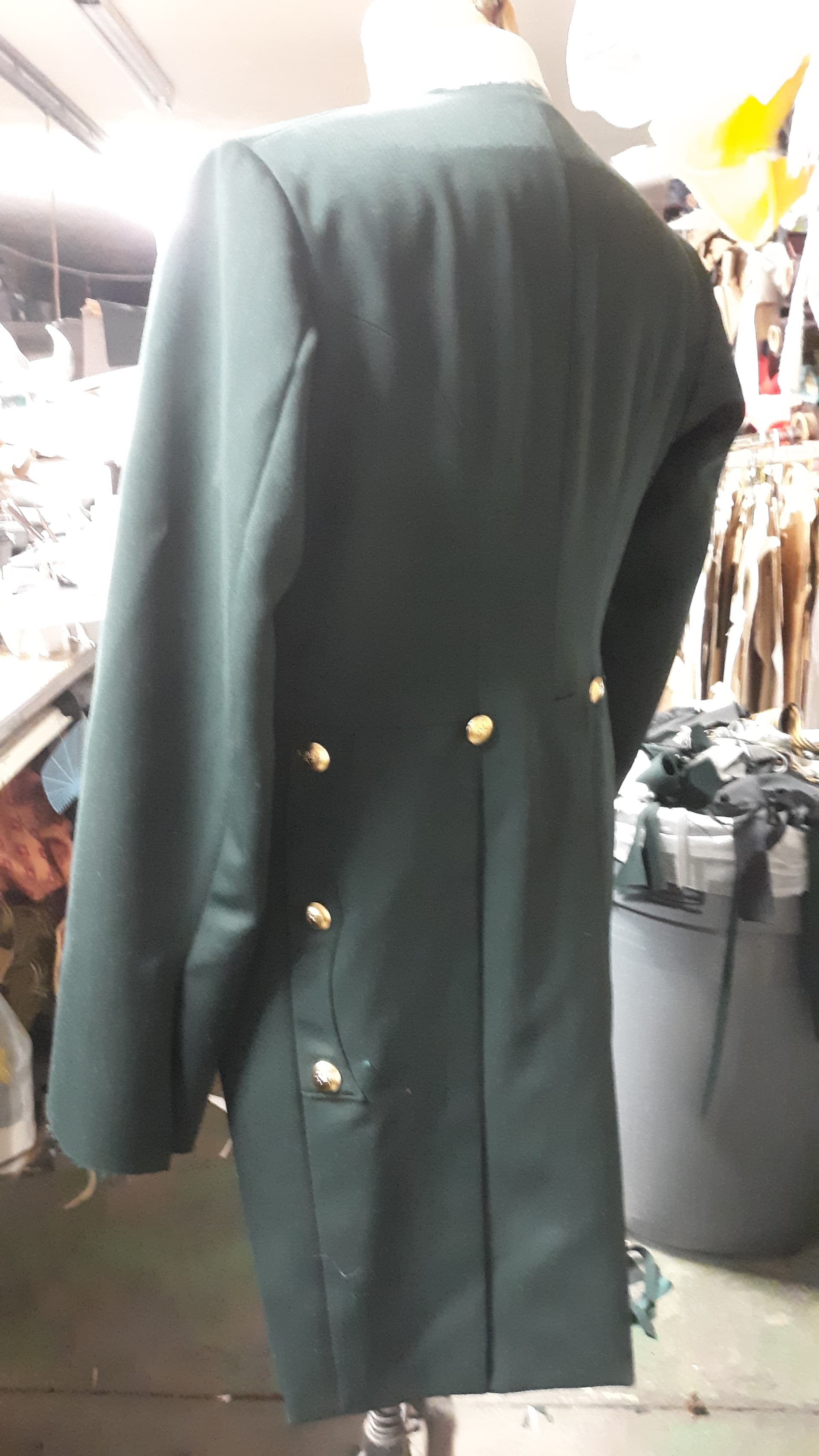

We’ve done it that way, but it looks messy with too much of the gusset on the front with a 2 part sleeve. Plus it puts the gusset on the seam… making it more bulky. Basically what I do now is flip the curve of the under sleeve s ok it creates a football shape that just folds on the lowest part of the armhole. When I go to work later I’ll post a snapshot of pattern.
If you’re dong a 1 piece sleeve, then splitting the gusset at the seam is what you need to do. Of course in both cases you can add a separate gusset piece, but again more bulky in the seams, and more work.
Addendum:
This is what I did: You may also notice compounding the issues we have to deal with are the 1" seam allowances in the under seam to allow for alterations. This is for one of the Livery (Butler’s) coats… that I putting the collar on now.
