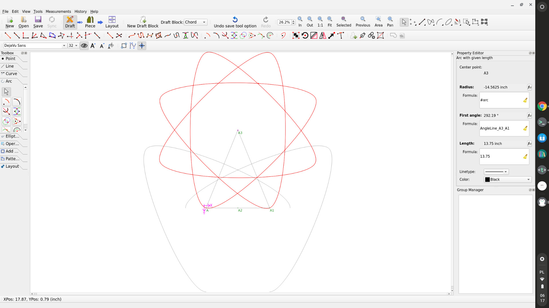

I’m having trouble working out what formula to use. Obviously this one is way off in the bleachers behind me: the radius of the #arc=13.75/sin(13.75/_pi)
Apparently -91.4991=13.75 who knew? LOL
I’m not done trying, but that flower was too funny not to post about.

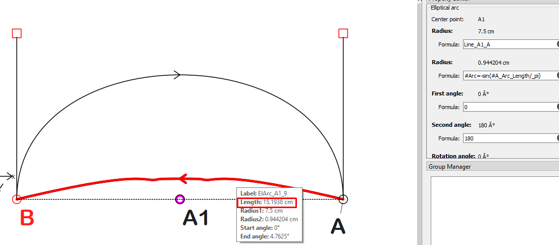

I tested your formula and it’s really good if one uses the Ellipse tool with the line to the 1st radius:
I think this is about as close as one can expect. I created 2 variables & set one to 15cmm & Arc to 0, since the formula will establish this.

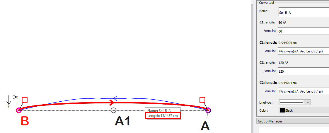

And then I changed your formula to this:
#Arc=-sin(#A_Arc_Length/_pi)
And here, I used the curve tool :grin: :grin: :grin:
I angeled the handles inwards by 30° and it actually made the curve line more accurate. Now to think of a formula to automatically set that so that the curve line is 100% accurate :grin:

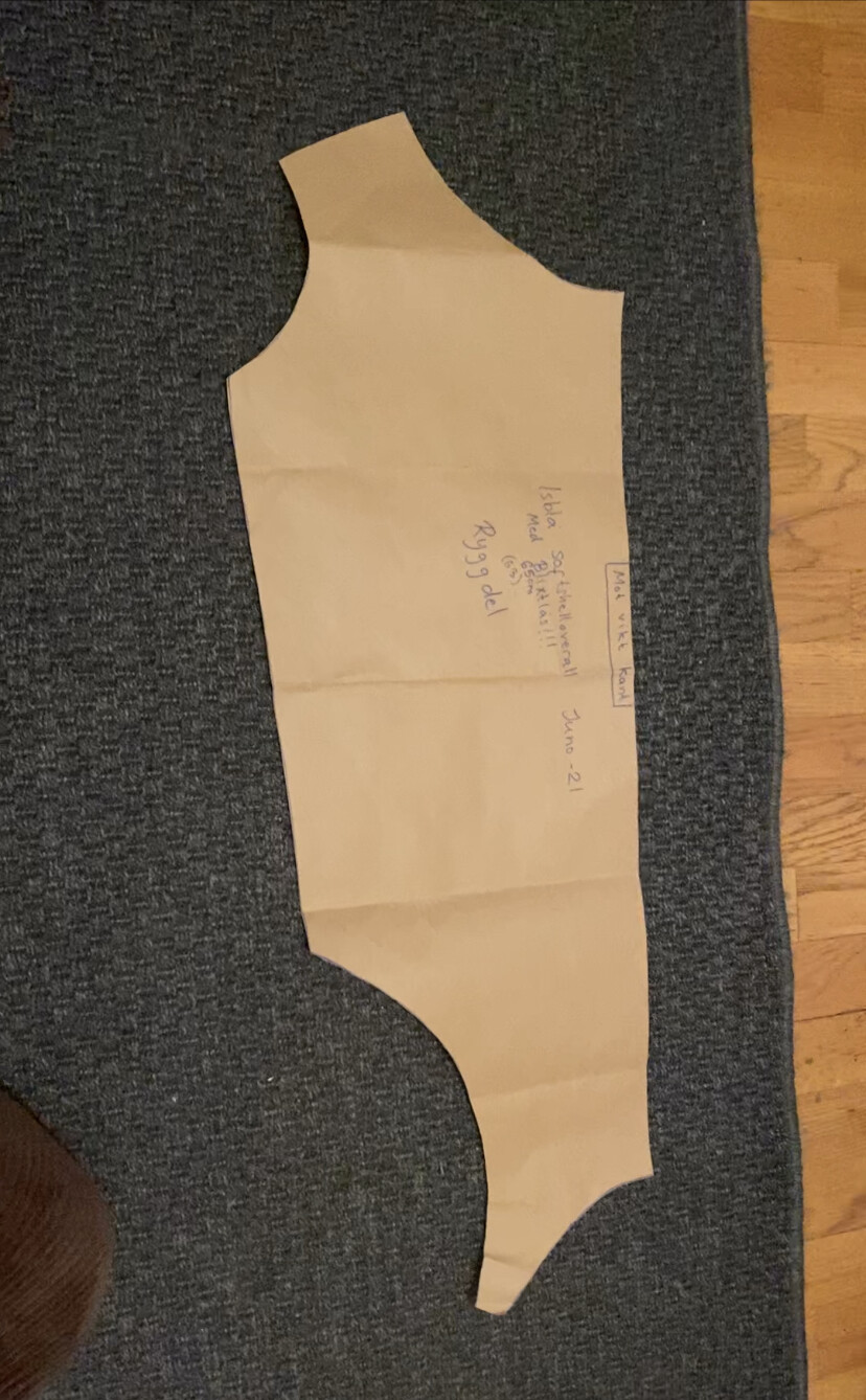

This is ONE of the pattern pieces that I’m trying to digitalise. As I said: I usually do this by hand based on the dogs measurments, but it takes forever so I wanted to use Seamly to be able to just measure any dog and put the measurments in Seamlyme and have the pattern pieces change automaticly.
