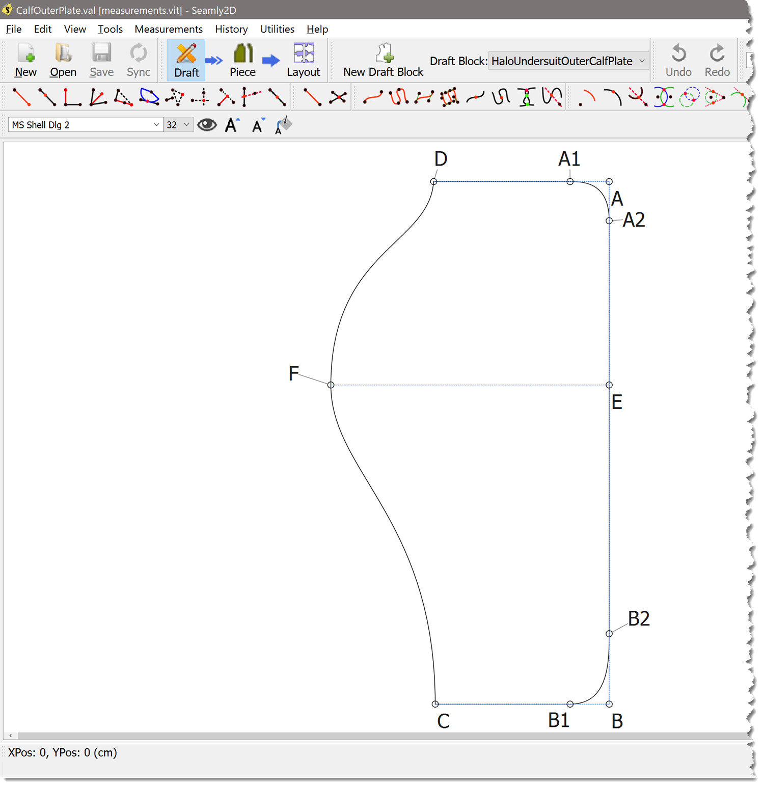

But some YouTubes to get me started - Did a measurements with SeamlyME and I made this basic design. And yet can’t seem to do a thing with it.

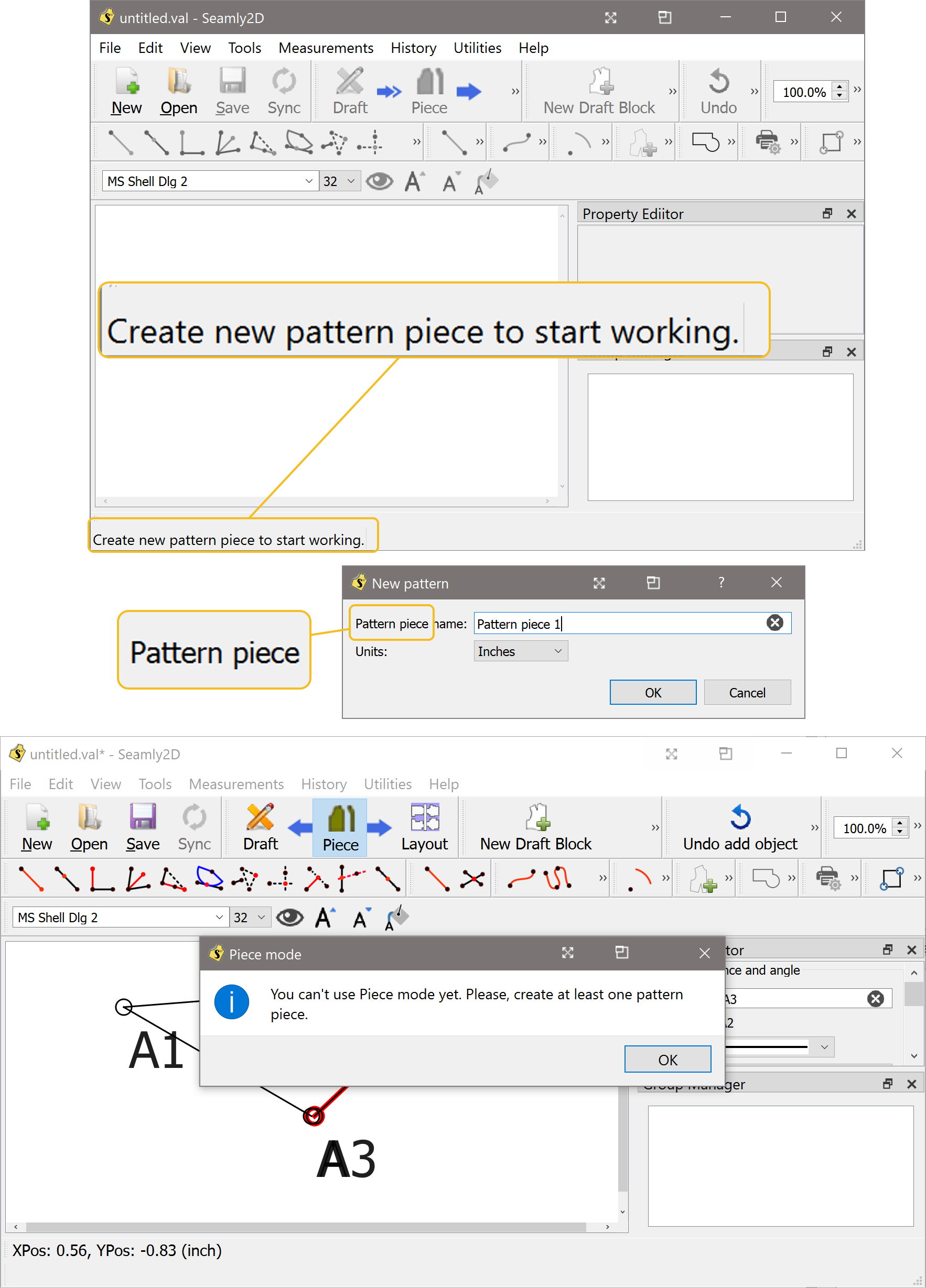

I tried adding a label. I did the label template as directed in a YouTube. Did the pattern properties for name and so on. Got a message about making at least one pattern piece. Well huh? Didn’t I just do that. But I realize it is showing as a “draft block”. Ok. Now what? Can’t click “piece” without it saying “Make at least one pattern piece.”
So I try the workflow again. New. New again. And it says right on the window “new pattern piece”. I’m not an idiot, I can read. And yet when you try to go to ‘Piece’ it says “make at least one pattern piece”. Well what did I just make called “a pattern piece” if it wasn’t actually a pattern piece?
Is there some conversion process you have to do from ‘draft’ to ‘pattern piece’?

With Seamly, you have 2 boards… The 1st one is for drafting your pattern pieces, as you have been doing, and the 2nd one is for the actual pattern pieces that make up the pattern - the one that you’re battling with.
Once you have drafted your pattern, you need to define the different pieces by using the Add New Pattern Piece tool. Click on the tool and select the nodes and curves of the outline of the pattern piece in a clock-wise direction. After selecting the last node or curve, hit Enter. Click on OK on the menu that comes up.
Once this is done at least once, the Piece board will be available where you may add seam allowances, labels, grainline, notches, etc.

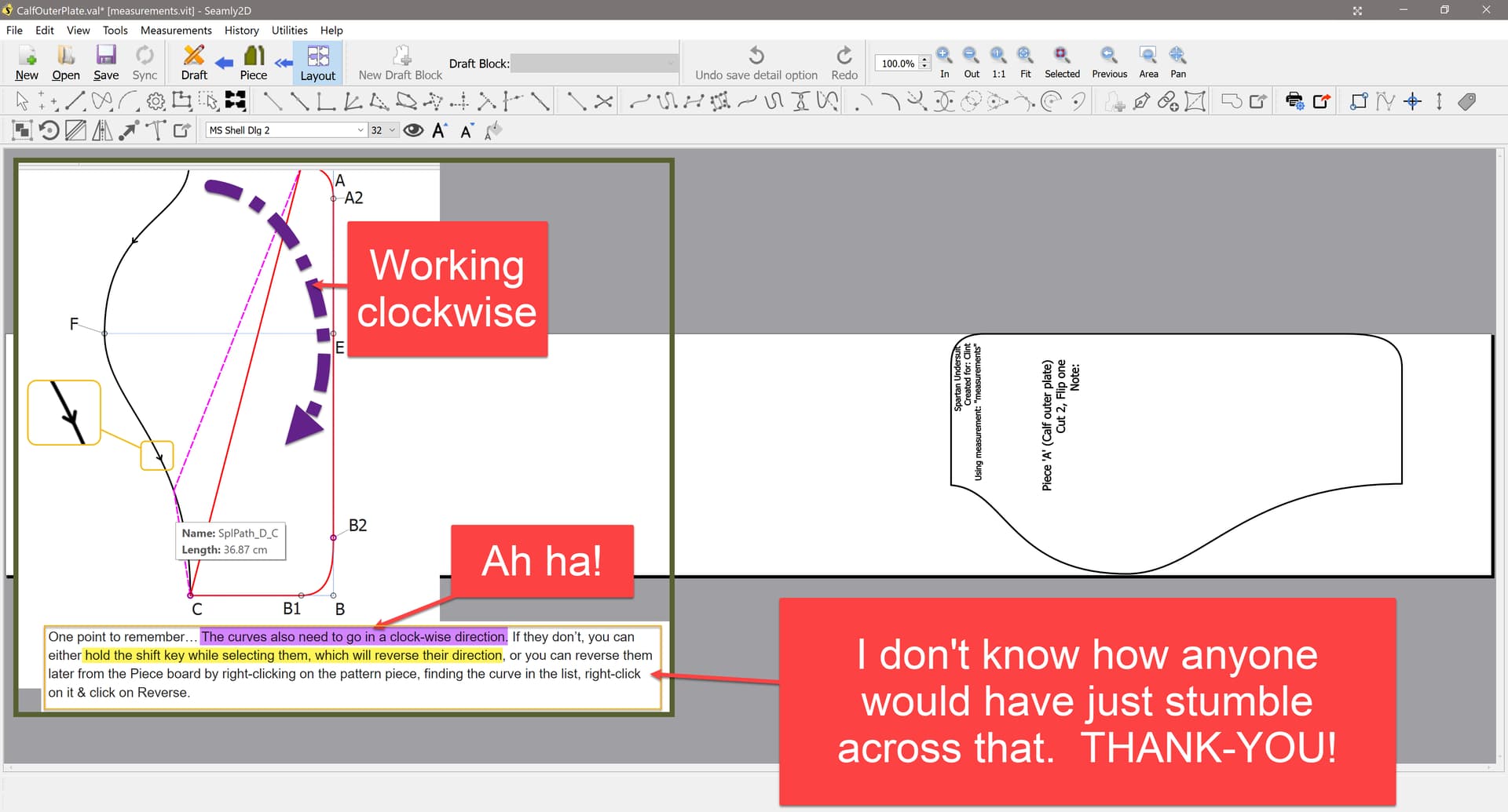

Thanks all for the @Grace -ious welcome. I really appreciate that in-depth explanation. In all the videos I went through, not once did they get into ‘boards’ or the idea that there was a draft and real part space. That’s a little odd to me, but whatever I’ll get over it.
Toolbox… Yeah I have them all out there, just as toolbars instead of a pallet. Better use of space. Primary monitor is 4k. Secondary is 2560 as a 32" ultrawide. So might as well use the real estate.
At one point after 10 different “I wonder about this” experiments I did get to the selecting clockwise stage @grace described. Which again without any context … So while I was selecting and trying to be a good boy and do it in a clockwise order of selection it wouldn’t have occurred to me that the lines themselves have a directionality to them that also had to be clockwise. So you saved me on that!

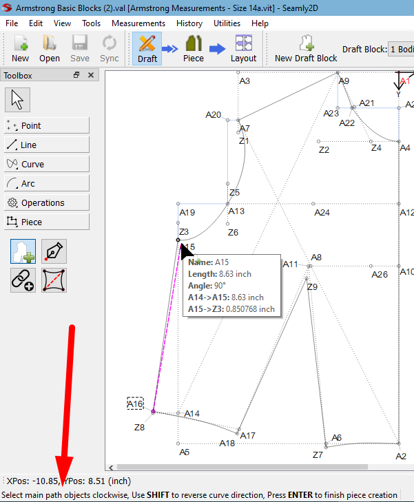

A very small tip… When you’re doing something and wonder what to do next, there is a “Help Text” at the bottom left of your screen:
