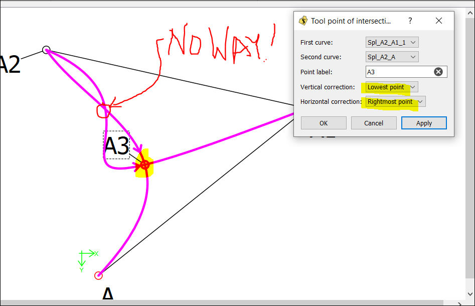

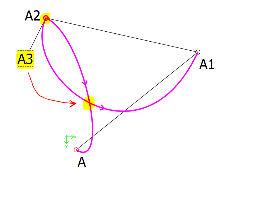

I just tested it for a particular edge case where the two curves share an endpoint. A3 is the intersection point of Spl_A2_A1 and Spl_A2_A.
Should we improve the definition of ‘intersection’ to exclude the endpoints if a non-endpoint intersection is found?
Another edge case where there are multiple points of intersection.
Should we ask the user to choose ‘1st intersection point’, ‘2nd intersection point’, ‘3rd intersection point’,… ‘nth intersection point’?

Yeah there’s no way to select the other intersection point:
Like this…?

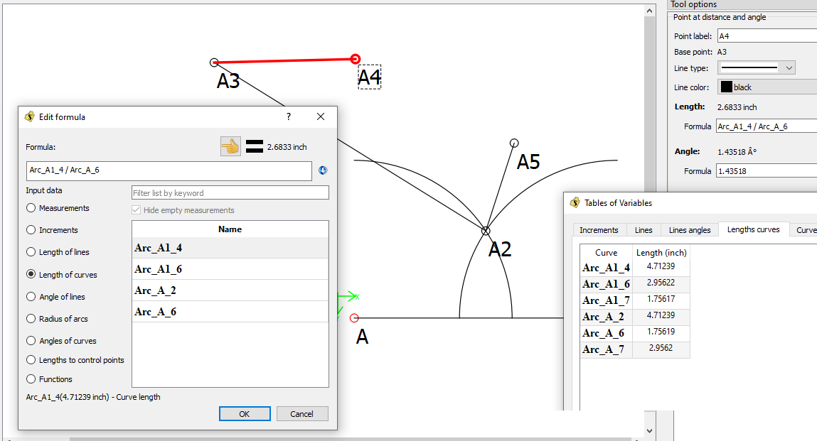

arc1 arc2
In this case by moving the arcs away the intersection point A2 is no longer an intersection point and the origin is used as the place holder so the pattern doesn’t crash. Since the arcs no longer intersect there are no arc segment lengths in the variables table->curve lengths.
Edit:
One thing I did discover is that the arc segments will become ZERO as the intersection point is removed… and if you were using the curve lengths in a formula as a divisor you’ll get an error.

Didn’t look at that… was using the point of intersection of curves tool using arcs vs using simple or bezier curves.
But yes… in the example I posted simply moving the arcs away to a point where they didn’t intersect, the point is replaced with the origin… and in one case the arc segments disappeared in the variables table… other times they were there, but the length value was zero.

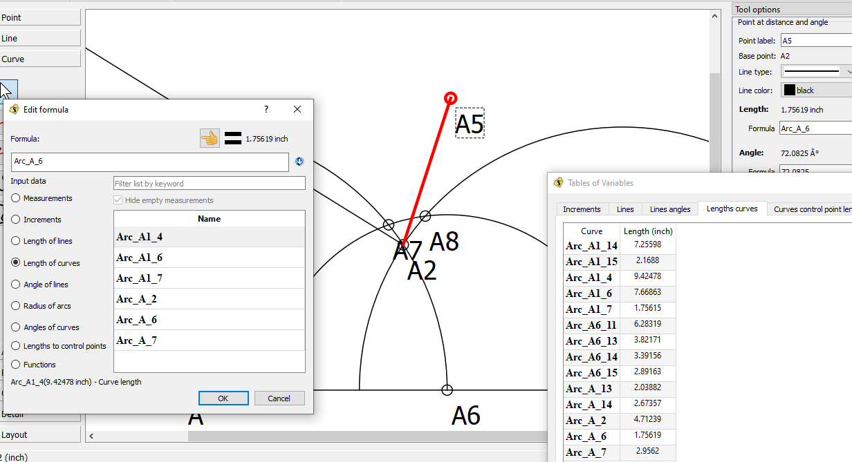

In testing this some more I found another issue with it… There is a discrepancy between the Table of variables Dialog and the Edit Formula dialog. Oops.
There’s an even greater discrepancy the more intersect points you create on a given curve…
