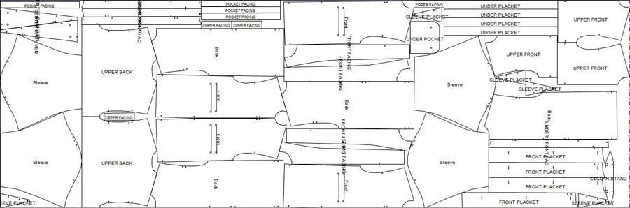

Basically, its an “advanced” layout of pattern pieces in all sizes that are planned to be produced, arranged for the optimal cutting of a fabric (usually several layers at once). It has specific size (length x width) corresponding to the fabric width, print (if exists) and grainline, and also to the length of the cutting table of a production facility.
Something like this:
