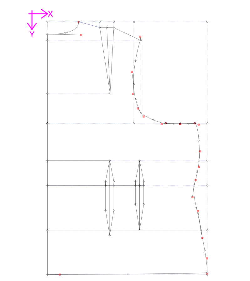

hello - i probably should have mentioned I’m a mac user :slight_smile: I’ve just seen the thread about how Mac crashes when you use measurements via seamlyme (and yes it still does) Anyway - for now I’ve drafted this block inputting measurements as I go per line which was fine. So much more left to figure out! Proper armscye curve, true-ing neckline and armhole seams, turning this into a pattern… figuring out dart manipulation… that’s my weekend sorted I guess! Still it’s fun

One thing I noticed off the bat are the curves - specifically the control points. You should formulize the control points so the curves adapt to the pattern to create smooth curves. For ex: Generally you would want the control point of the endpoints to be at a right angle to the seam it intersects. Also the length is important.
I’m currently on my phone, so maybe @Grace could illustrate what I’m referring to, and I suggest you read the thread of Keith’s on smooth curves - it helped me a lot.

Yes the curves are very “just do it” over do it well! I’ll read that thread and try again. I just wanted to see if I could approximate the physical block ( I did) and identify my areas of learning needed so I could focus on finding those videos ( I did) so all up a successful evening and looking forward to playing more later.

Here’s an image of mine where I put all the lines in for the dart rotation, etc.:
:rofl: I see that I only did the front :rofl:
