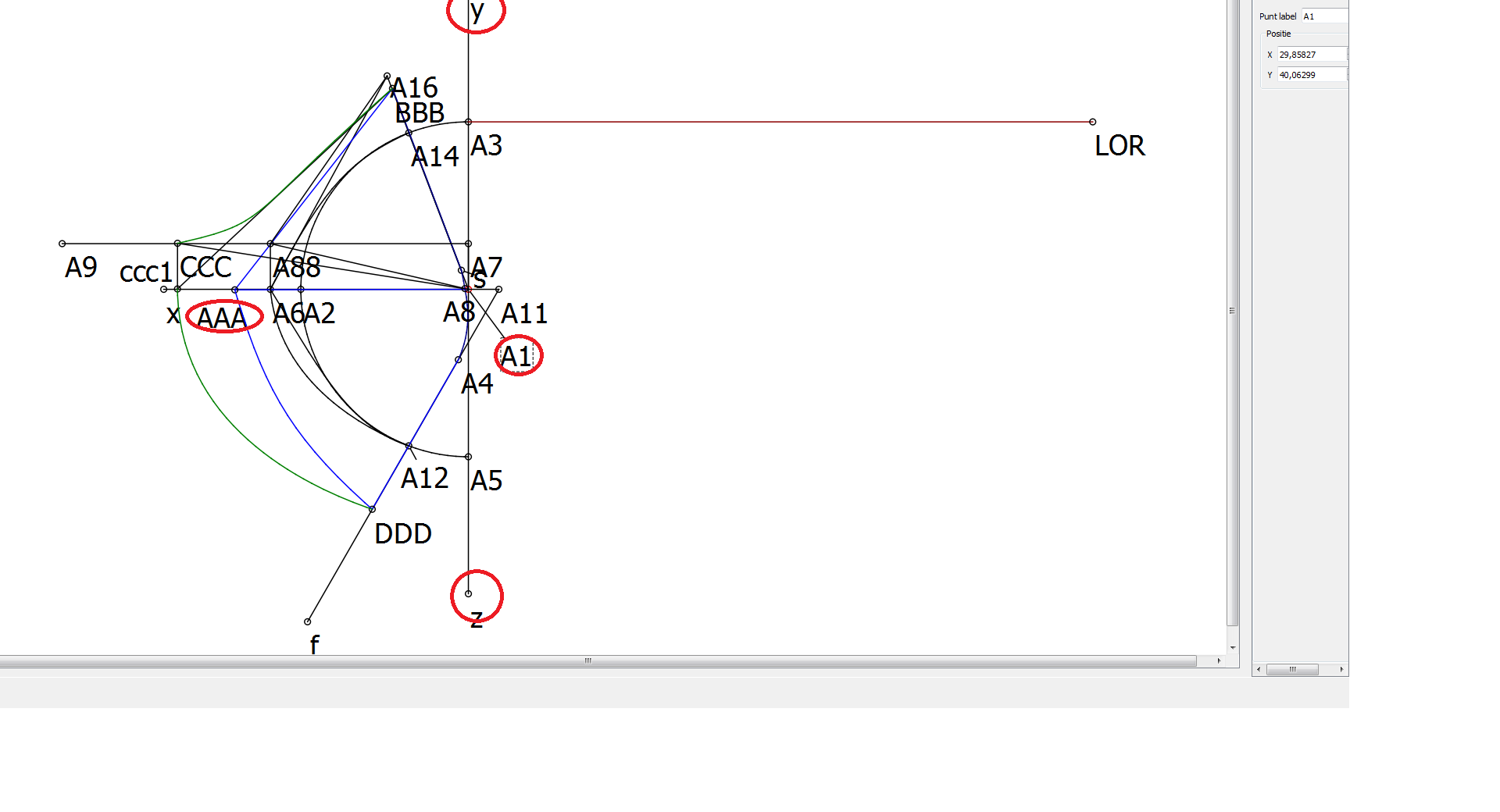

my english is not that great. but i think im in the right topic. i want to print my drawing with some helplines and markpoints. is that possible? or can i only print the pattern itself? is there an easy way to help me out? for lingerie the help lines are verry usefull somethimes. thanks
Hi,
Can provide an example?
We currently provide some helplines, some will be very soon.
hi, thanks for answering so fast. i would like to see the horizontal (AAA-A1)en vertical line(Y-Z) on my print. mainly point A1 is verry important. now i can only print the pattern itself ans the seam alliance.
Okay, i think i understood. Unfortunately right now no, you cannot. Watch issue #509. Right now i am doing redesign that will bring this feature. Watch my progress in thread Redesign Seam allowance tool.
