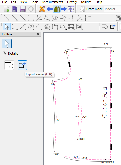

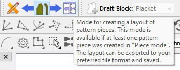

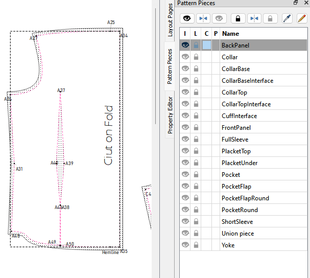

Curently Seamly supports creating layouts for print, not an actual cutting marker. I’m currently working on a marker feature. To create a layout you select the pieces you want in the layout while in Pice Mode.
Click the Layout Mode button:

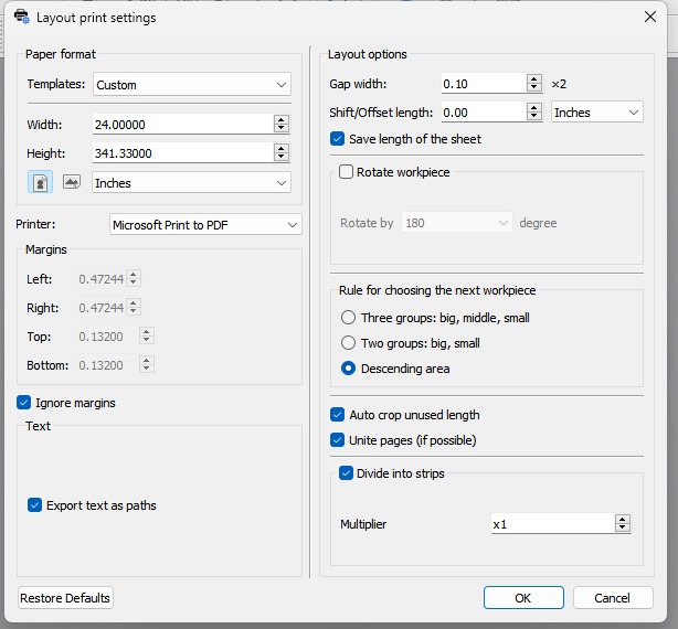

Select your settings:

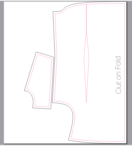

press Ok, and it generates the layout:
You can then export the layout:
Or print it:
OR you can just Export the pattern Pieces in Piece mode - such as an SVG - and then use it in other app like Inkscape.
