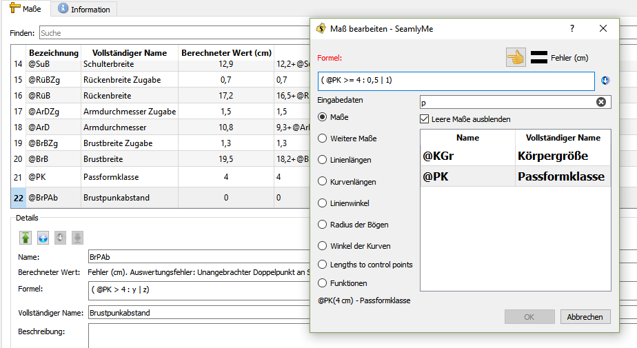

hi, can someone help me to apply the if then else function? I tried, but I am not really getting anywhere. In excel I would type my goal like this: =IF(PK<=4;0,5;IF(AND(PK>=5;PK<8);1;1,5)) I copied the expression like stated above and tried, but it wont resolve. ( a > b : y | z) Can I achieve this with Seamly? For now it seems the program doesn’t like the colon. I replaced that with a semi colon, but then it didn’t like the straight dash (not sure, how that is called coorectly). Also, I tried with removing the spaces, but nothing seams to bee a proper function.
Thank you, Évi
Hi, I figured it out :slight_smile :slight_smile: It works with this expression ( a operation b )? c:d
In my case the formula is now like this
(@PK<=4 ?0,5:(@PK>=8 ? 1,5:1))
Hi @Evica! Fantastic nested if statement. Thanks for posting your solution.
  • if a<b then c else d looks like ( a<b ? c : d) in Seamly2D formulas.
  • if e<f then f else g looks like (e<f ? f : g)
  • When d is another test, then it looks like: ( a<b ? c : (e<f ? f : g) )
