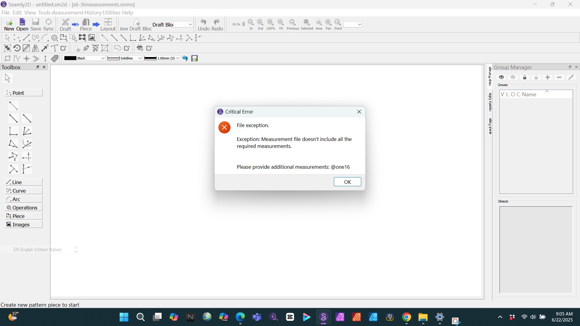

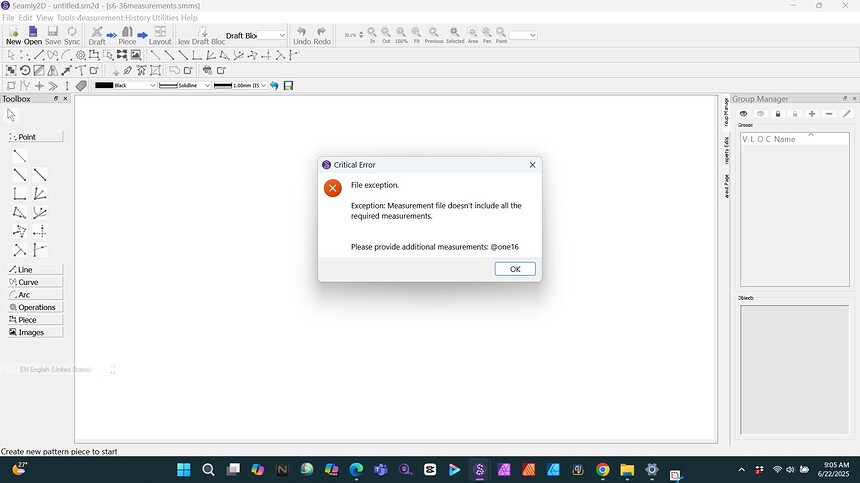

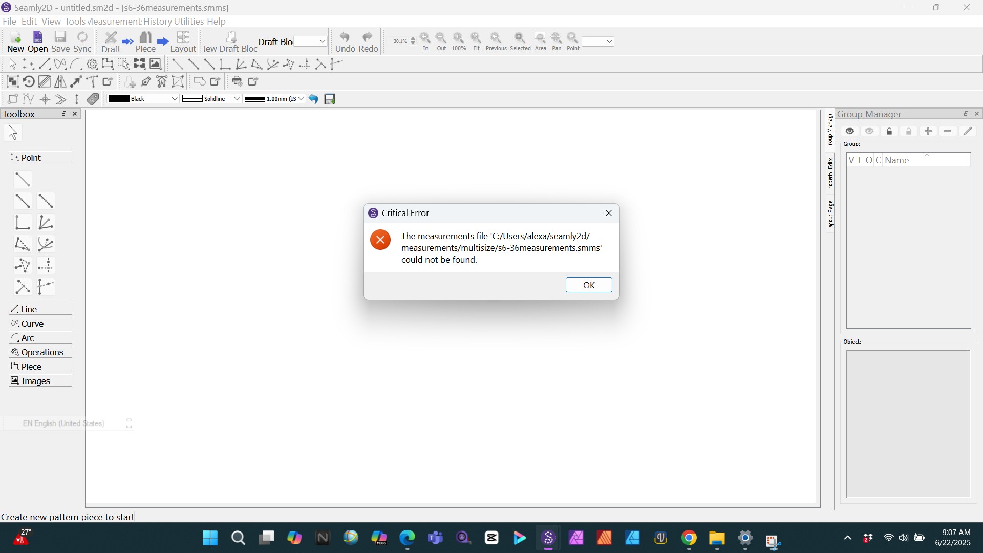

Hello . I am learning Seamly 2D. It is amazing, Except I can not open any of my files now. It sending me two msgs. Snip shot below. I will appreciate any help. Thank you very much.

Right… the pattern is looking for the measurement @one16… there is no measurement @one16… but there is one named @one_16. Which leads me to believe instead of using the fx editor to add the measurement to a formula, you typed it in manually incorrectly?
Just edit @one_16 to @one16 in your measurement file and it opens fine.
Thank you so much!! It is working !! You made my day!!
