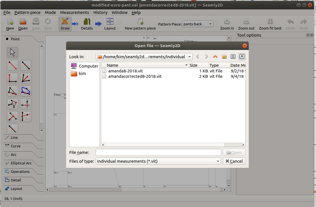

If you follow the suggestion @AVI wrote, I will give you an example of how to use two measurement files. Example: You created a file using SeamlyMe and entered your measurements. You will have a file called mine.vit and another called sister.vit. (You may call them whatever you like)
You will then use the program SEAMLY2D and open your pattern file. If you open a pattern that you have used before, look at the top of the window to see what measurement file (.vit) is being used. If you want to use a different measurement file with the same pattern, go to the top menu and select Measurements - Load Individual. That should pop up a window to let you select from the measurement files you created with the SEAMLYME program.
The specific folder where those .vit files are stored can be changed by changing preferences in SEAMLY2D. Here is a screenshot showing the two .vit files I created and the window that I see when I use the “Measurements -Load Individual” option
