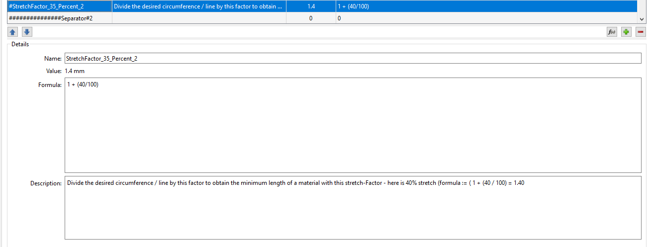

Local Variables Table: (.SMD2)

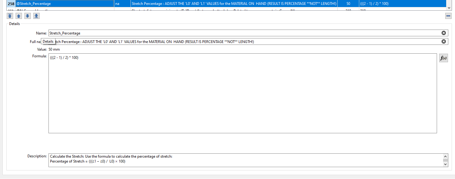

Included Measurements File: (.SMIS / .SMMS)
(please note: the example text in the above ‘Description’ is quite extensive and describes in detail the steps required to reach the desired results: [ *Example Formula: (((2 - 1) / 2) * 100) :: (((Stretched_Length - Relaxed_Length) / Stretched_Length) * 100)
To calculate the percentage of stretch in an elastic material, follow these steps:*
Measure the Original Length (L0): Measure the length of the material before stretching it. This is your starting length (L0). Stretch the Material: Extend the material to the desired length. Measure the Stretched Length (L1): Calculate the Stretch: Use the formula to calculate the percentage of stretch: Percentage of Stretch = (((𝐿1 − 𝐿0) / L0) × 100) ]
  • The above is only a minute sample of descriptions which include instructions for use.
These two areas store measurement data: formulas, (descriptive) names and descriptions of the item. I at least use these quite extensively as do many, if not everyone else!
I also need, when I have created an entry in the dim and distant past (yesterday?), to be ably to see exactly what this does and if it also need modifications - I create entries with ‘Place Holder’ data and provide detailed descriptions of what this does and what need to be altered for a specific use.

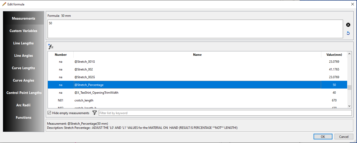

Unfortunately, the data displayed during formula editing does not include any description text, The name is there (but not copy able), I think the addition of Copy-Able description text field/box would be of great help and benefit for all of us.
Formula Edit Dialogue:
Having resize-able text-boxes and / or copy-able text, would be ideal.strong text

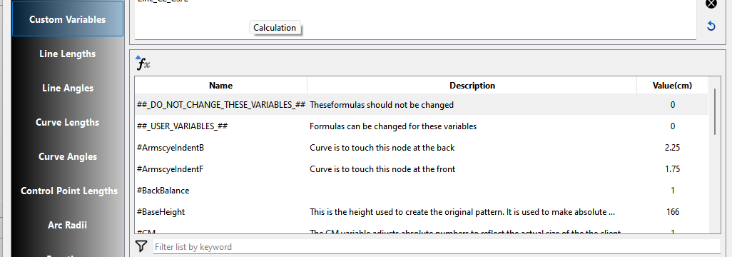

What vesion are you using? I already added the description column to custom variables. I can easily “un-hide” the description column for measurements:
And add a QTableWidgetItem for the measurement description data. What I would do is also add the description text as a rollover tooltip so you could see any long descriptions that are likely to get elided, as I would not want to set the cell to word wrap as the priority of the fx editor is to see & select the measurement by name - not reading descriptions .

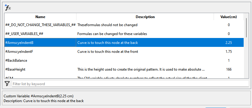

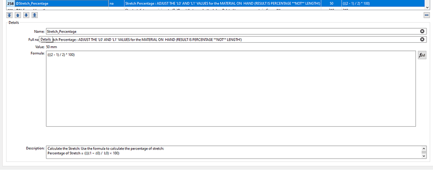

Hmmm… I’m stumped at the momment. I supposedly had already implemented showing the description for measurements along with the custom variables, where the description would be displayed in the box like below:
For some reason when loading the measurements through Seamly2D the descriptions for measurements are getting lost and just end up an empty string. :thinking:

Yay!.. I figured it out.
Just have to resize the columns better, and I’ll have to see if I can make them copyable in the lower text box.
Note… that the way ME is writing the measurement descriptions it is not feasible to write the known descriptions to the file, but I did figure out how to access them in Seamly2D. :slightly_smiling_face:
Aaaahhhh, I knew you’d find a way :partying_face: :woman_dancing:
Well done!!!
While I was at it I added the “Full Name” field. :slight_smile:

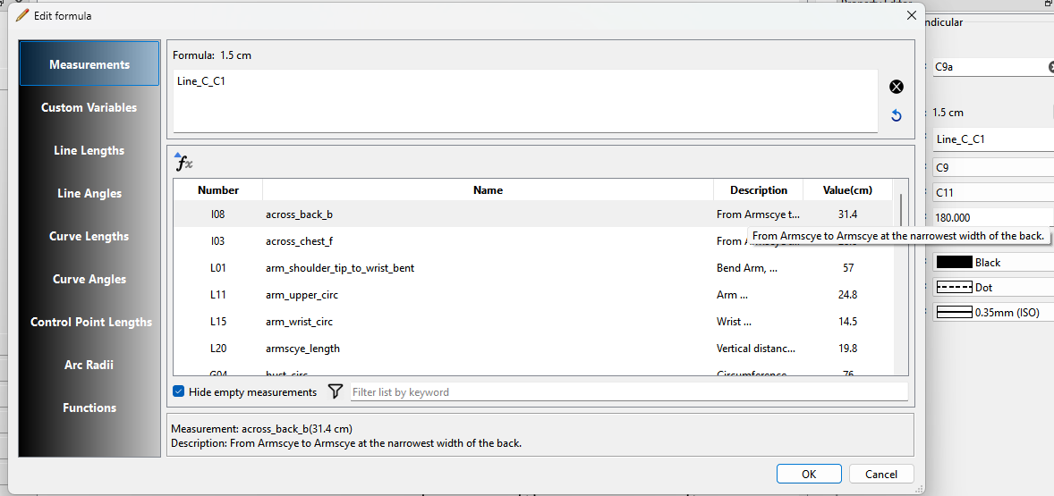

And now the columns are sized better:
And for @DavidDeb:
You will be able to copy the text in the label box. It’s not a QPlainTextEdit as I thought so the setReadOnly does not apply, but with a Qlabel you can set it to interact with the mouse to copy.
