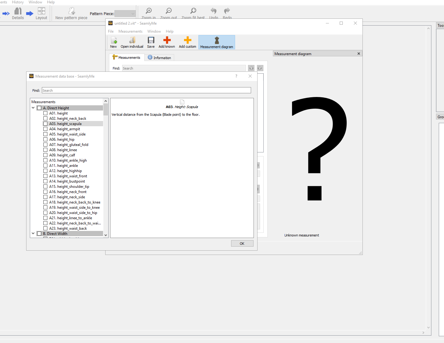

Have you tried turning the diagram on? image
I always make my own directories in a folder on my desktop, so I can find them easily. This way, when I’m helping people on the forum, I don’t have to go all the way to the C drive and then the programs, etc. etc. :slight_smile:
Yes I have tryed it I cannot see the picture as for the dirs I did create them I just wonder why the installation program does not create them
Please send me your measurements file so that I can see what it’s doing. :slight_smile:
that’s what i get no diagram at all

I think @Pneumarian is correct. It is a similar problem to the one with the languages that is only with new installations.
I’m thinking that the programming team are currently working on these bugs that crept into our new release and soon there will be an update released but I’m not too sure if it will only be Linux or will it include Windows, as well: 20200619 Linux Appimage Test Build! - #10 by Frederico
In the meantime, perhaps you can reference the images from the lists here: Measurements - Seamly2D
I have created an issue for this: Measurements Diagrams not available in SeamlyMe in new installation · Issue #273 · FashionFreedom/Seamly2D · GitHub
Yes the images and translation files were not included in our latest build instructions. We are working this issue as quickly as possible.
Thanks for your patience!
ok it’s fixed – Download the New Release with Translations & Images FIXED!
