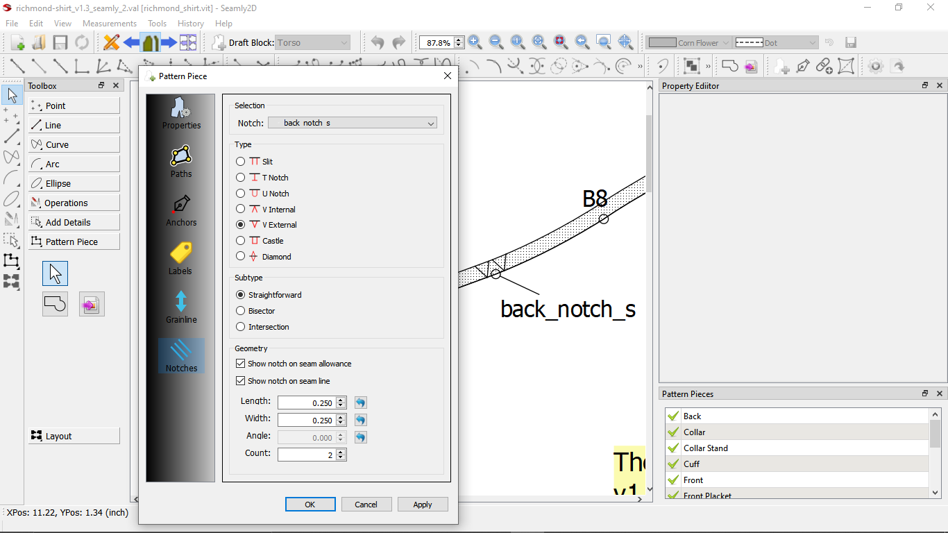

Hey @koshaugh,
I was playing around with the shirt pattern, and I found it interesting how you used a arc as an internal path to simulate dot symbols for notches. :slight_smile:
That being said, don’t know if you’re aware but the current Seamly2D handles notches in a proper manner. You can select the type, size & number (1-3) to create standard front, side, and back notches.
Here you can see I used a typical commercial pattern V notch, with a count of 2 to indicate the back half of the sleeve,
