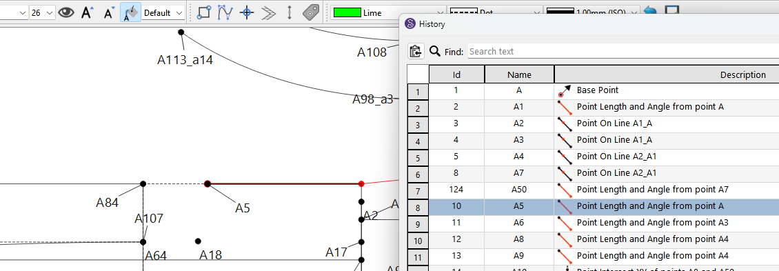

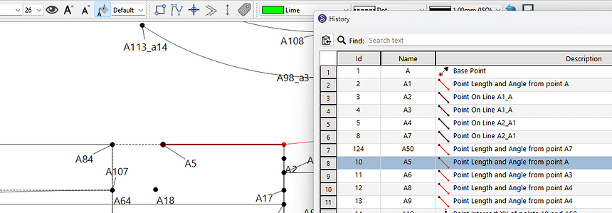

Also if you open the History and select an item, it will hilight the tool in the draft block:
I could easily make the History also zoom to the selected object.

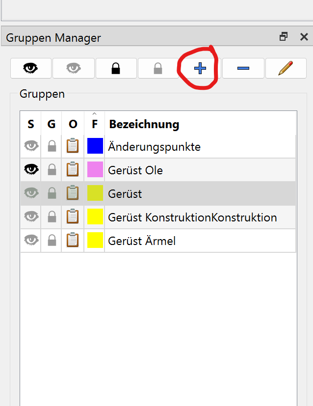

Might seem simple but could maybe all the objects be added in a group by default to start? I didn’t know that I should add them to groups for this to work and I think this would help out with anyone trying the app out at first to see the full functionality just having a default group made and items added to it by default, until the user want to select and separate them into more finer detail?

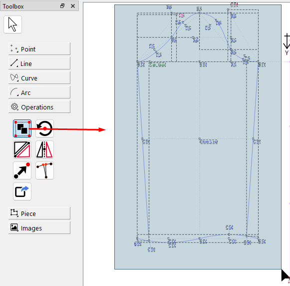

You can use the Group tool under the Operations tools to drag a large selection of objects and add them to a group in one swipe.
Then you can sort them out afterwards.

Dafür muss man zuerst Gruppen definieren in die man sie zuordnen muss. Das ist auch jetzt schon möglich. Bei einer Konstruktion entstehen nicht immer Punkte, die in einer gruppe später landen sollen. Ich arbeite von Beginn an mit Gruppen und ordne zwischendurch immer meine Punkte gewissen Gruppen zu, damit ich sie später gleich finden kann. Viele Punkte landen auch in mehreren Gruppen, um damit weiter zu arbeiten oder für Maßanpassungen leichter zu finden sind.
Der Arbeitsaufwand wäre so rum aber größer.

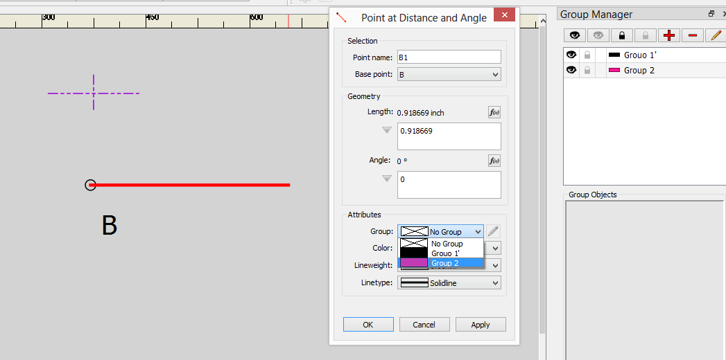

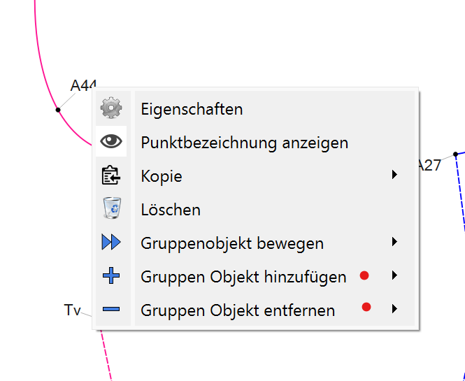

I think we dicsussed this issue before… I was working on a feature where you could add a tool / object * to a group when created, but ran into the issue of which group color to use if a tool / object is in more than 1 group.
  • The app itsdself distinguishes between a “tool” and an “object”. For most tool’s the objectId is the same as the toolId. Operational tools on the other hand are a group of “objects” where they share a common parent toolId. For our use we can just refer to each graphic item as an object as each objectId is unique.
You don’t have to add objects to groups… it just makes for a cleaner pattern as you can hide / show different parts of a block which can get rather messy when you have 100’s of point names with many over lapping one another. Because I was able I added the group Object list, and made it so you can double click to zoom to that object.
The History though IS the place where you can see the items in the current BLOCK in chronological order… as that’s how the app works - on a single block at a time with each tool in chronological order. Could I take and turn the History dialog into a tree based dock… sure, but my time is better spent on other bugs / features. BUT, it certainly makes sense to improve the History by zooming to the selected object, and not just hilighting the object as one may never see it if zoomed way out. To be honest I didn’t know the hilight feature existed until I actually worked on the History dialog and saw:

Like I’ve said I started work on being able to assign a new tool / object (at least those that open a dialog) to a group, but ran into issues with trying to maintain the ability to put objects in more than 1 group.
I’m not suggesting that it does it for all of them and that the app decides. I am suggesting that there would be a default group that objects get placed in when starting out the pattern similar to a root note in a tree. Though this analogy might not be the best if the groups are not hierarchical
That’s precisely what my group attribute would have done… it would add a tool to group upon creation - and just like the pen attibutes, there would be a default group.
Also what was intended for further development of the groups was saving / loading group presets so you don’t have to keep creating groups for every new pattern… just a load a preset with either a user defined preset, or a “standard” preset that has semantically defined groups… i.e. specific names, colors, linetypes & lineweights. Of course you could always create an empty pattern with a bunch of groups, and save it as a template.
