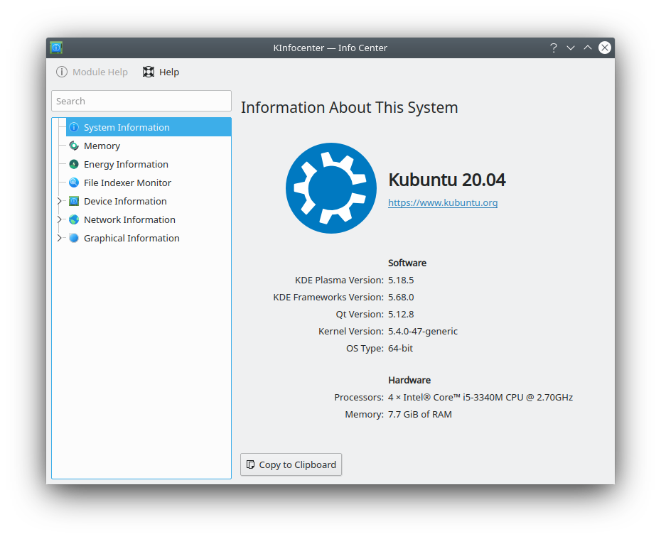

Which version of Linux? In Ubuntu 18.04.5 LTS I’m not getting that error.
However, loading the July 30 appimage, I get the same “no updates available” message, so something definitely is a little wonky at the moment.
Thank you @Douglas I got the correct version from the GitHub location.
@Pneumarian this is the version I am running.
