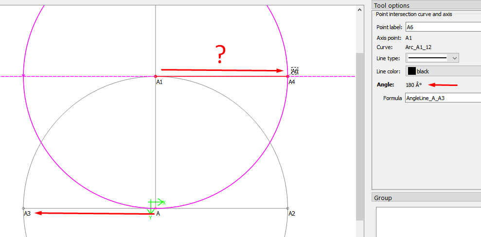

I’m using Windows 10 and Seamly image
The 1st thing is that the symbol for degree has an A with a ~ on top of it before the small circle. You will see it in the image below.
The 2nd thing is that I’ve created my 1st circle using an Arc, with 3 points at 0, 90 & 180 degrees. And then created a 2nd circle off the 90 degree node of the same diameter. I need points at 0 and 180 degrees. Creating the 0 degree node was fine, but creating the 180 degree node keeps putting it at 0 degrees. If I plus or minus 0.001 degrees, it places it correctly, as in the 2nd image.

I have to put my thinking cap back on for this one (that is I’ll have to go back and find / read some old posts) … this popped up in a discussion like 2 years ago, and if I recall it’s not related to the program per se, but rather one’s fonts settings. It a UNICODE thing. I looked at the pattern you posted and it displays the degree symbol fine on my Windows 10 laptop. You’re getting that extra A circumflex I’ll take a look tues eve and get back to you.

Hey Grace…Sorry I didn’t get a chance to look at th his last night, but it’s starting to come back to me. I downloaded the most recent Seamly2D build and it had the same issue with the deg symbol that you experienced, where when I use a build done on my machine it’s fine. It’s definitely something to do with the Unicode encoding. Not sure how (yet) how to get a correct build off of Github. One thing I need to check is if this happening everywhere the deg symbol is used, or if it’s just in the property browser dock window.

Anyhow, now that I’m home I was able to look at the issue again, and it’s all come back. The problem is that Github is encoding the source files as something other than UTF-8
I use the Atom editor and the files are set to UTF-8 encoding. Here you can see the string definition and it displays correctly:
UTF-8_1 UTF-8_2png
Switching the file encoding to ISO 8859-1 it throws the extra A char in.
ISO_1 ISO_2
I believe we need to figure out how to configure Githhub to use the source files as UTF-8 in the builds.

In the example Grace provided you can either use the “Point intersect arc & axis” or the “Point intersect curve & axis.” But if you notice in both cases the Tool Option says "Point intersection of curve and axis.
So is it a curve? An arc? An intersect? An Intersection? Not to mention is it a “Line type:” or “Type of line” or “Pen style:?”

Anyhow… I’ll have a fix for the 0 - 180 degree issue and we’ll work on the inconsistencies in grammar & terminology.
Update on the Intersection point… It was a simple fix to correct the erratic behavior leading to being off by 180 deg.
Intersect
But testing the fix I discovered several other issues, one that I will correct, the other I’d like some feedback on how others would like to see the issue addressed. The first issue is that if the axis center point is outside the arc / circle or NOT intersecting a curve, the visualization wants to connect to the absolute zero point (center) of the scene. IMO the tool should not exit until either a point on the curve is created or esc is pressed to cancel the operation.
Intersect2
The other issue is that again if the axis center point is outside the arc / circle or the axis passes through a curve more than once, only the first intersection point is available.
Intersect1

Hi @Douglas, once again I look upon all of this in awe. Thank you very much :star_struck:
IMO…
Yes, most definitely. Something that at least works is much better than something that doesn’t and does strange, unexplainable things (like whizzing off to absolute point Zero) when you’re only learning how to use the program.
And also, yes. It would be nice to be able to choose either the 1st or the 2nd or even, perhaps, both in this instance. However, the “both” may not be deemed feasible.
