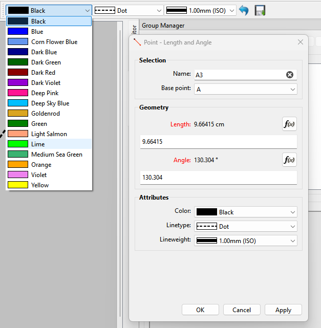

For ex: I opened the Point - Lenght and Distance dialog… changed the color in the pen toolbar:
But the dialog does NOT update.

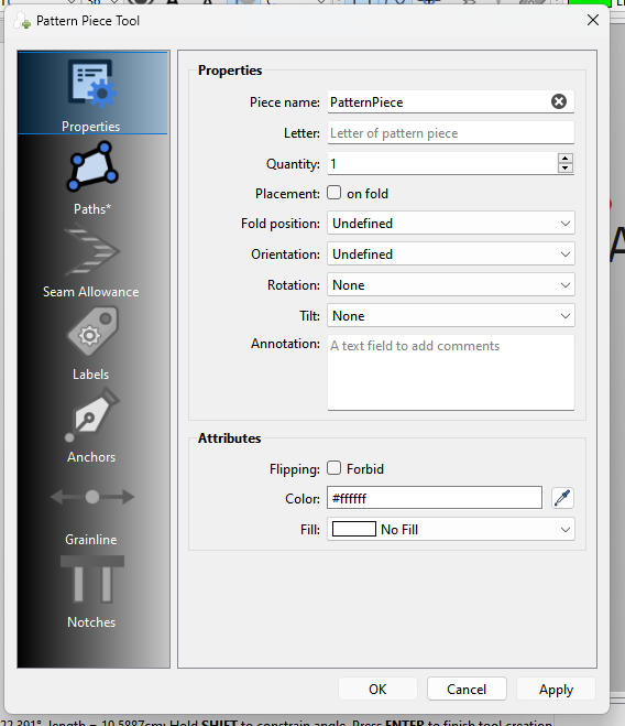

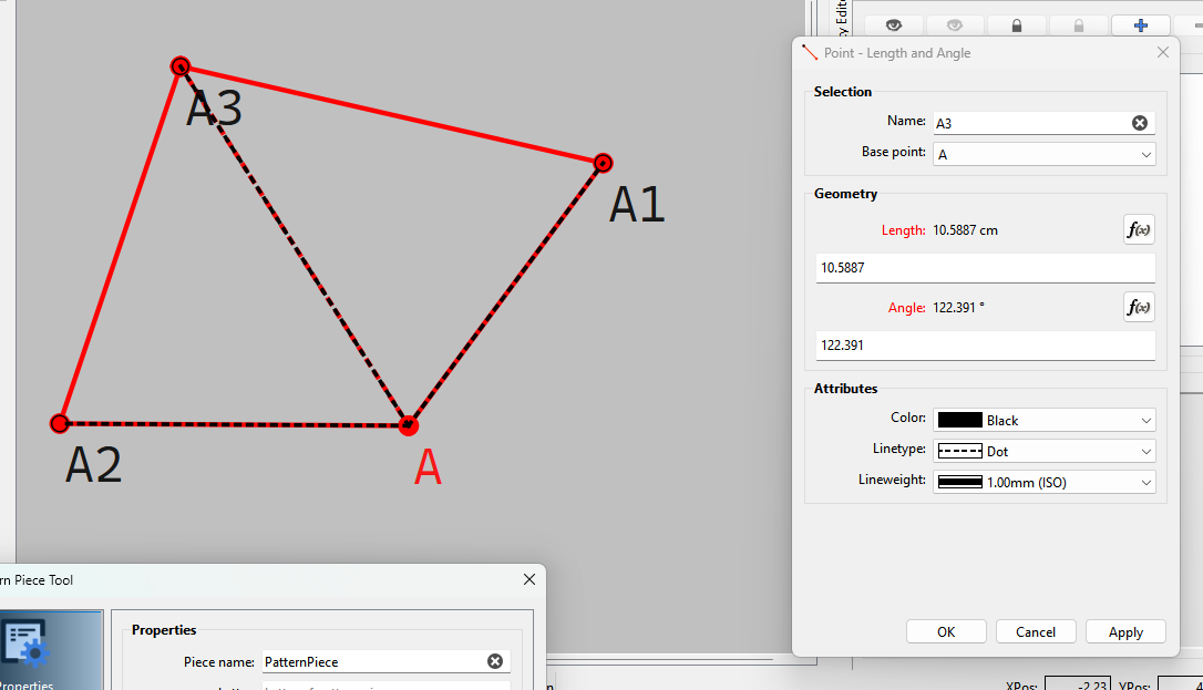

Another ex: With the Point dialog open… I tried to create a pattern piece while the dialog was still open:
But the Pattern Piece dialog is locked out:
Which then by closing the dialogs lead to a crash.

OK is disabled. It can’t create the Piece.
Not a bug. When creating a Pattern Piece you can only edit the Path as the Piece has NOT been created yet.

Create a Point - Length & Angle… when the dialog opens change the length. Click Apply.. Now create a piece including the point just created. The Pattern Piece dialog Ok button is disabled, and it won’t create the Piece. Closing the Pattern Piece and Tool dialogs crashes the app.
