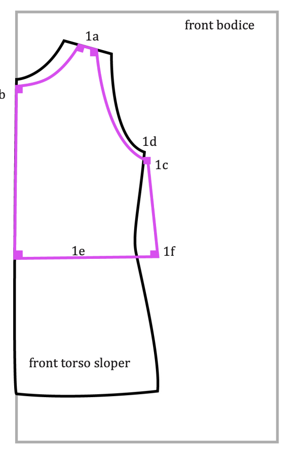

So for example, if I were to want to edit my sloper like this, how would I do it?
You first need to draft the black lined sloper in Seamly, then you can add the points for a lower and wider neck line & armscye to match the pink lines.
I would love for someone to post a tutorial of how to edit a sloper.
I know how to do the black lines, but if I want to go in and modify my sloper to make something new (like the pink lines), that’s where I’m not clear on what to do.

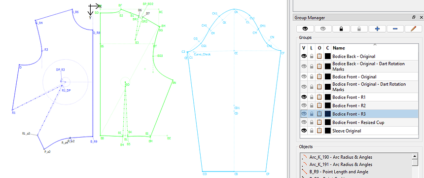

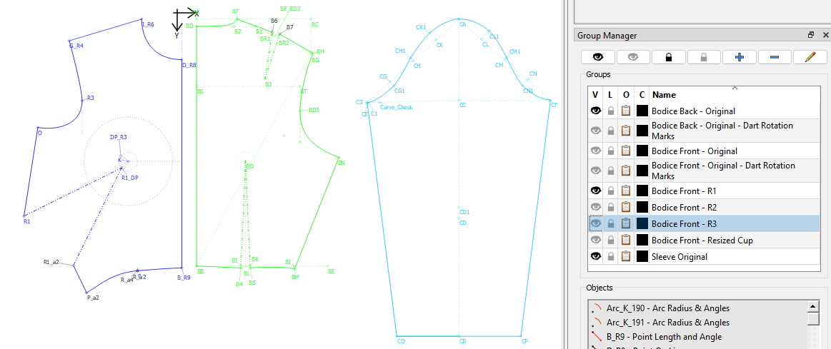

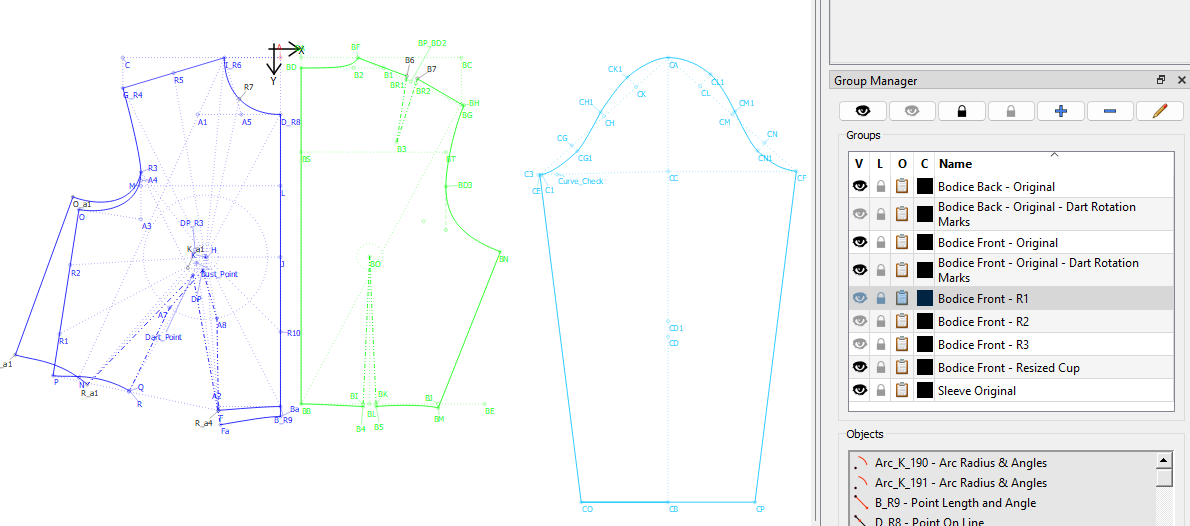

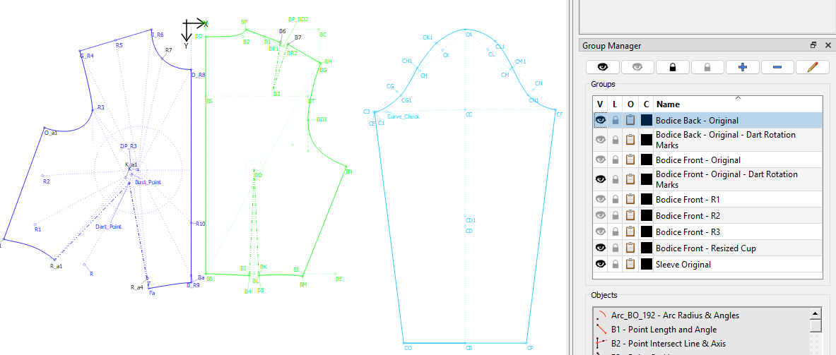

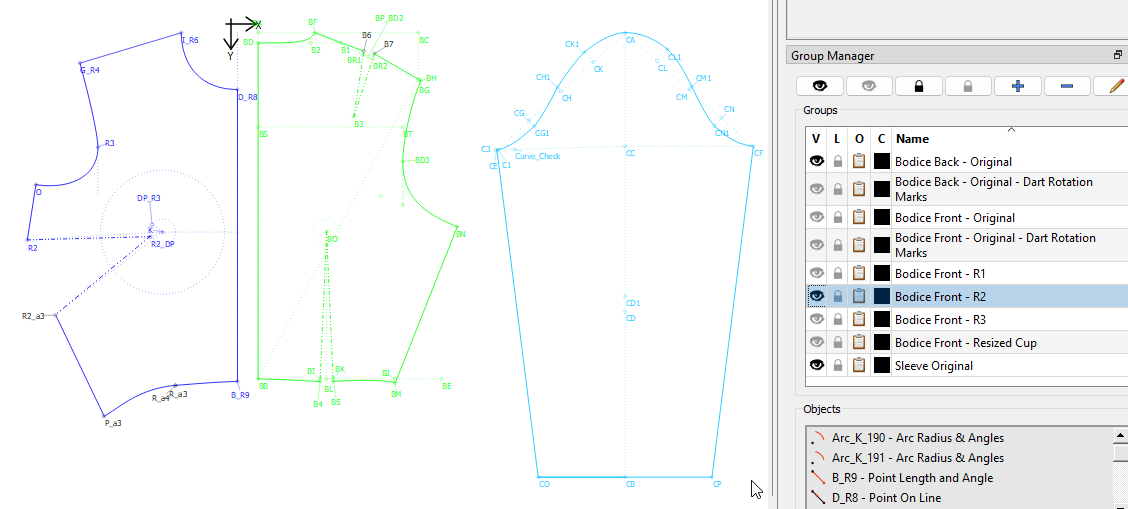

What I do is, I put the basic draft into a group. Then I make changes to the design by adding points to the existing draft and rotating parts around to change the position of the darts, etc. etc. Here is an image of my HJA basic sloper with the bust adjustment:
Here is the same image but the basic sloper is hidden by closing the eye on the group:

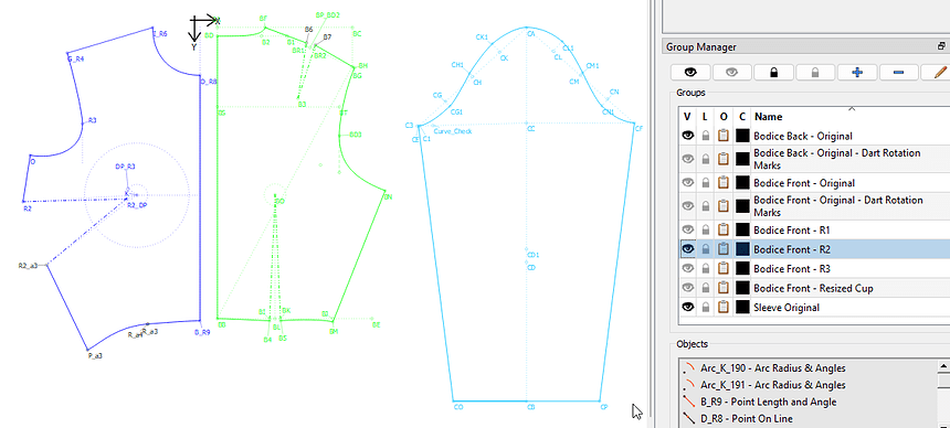

The same again with the dart rotated to the side waist:

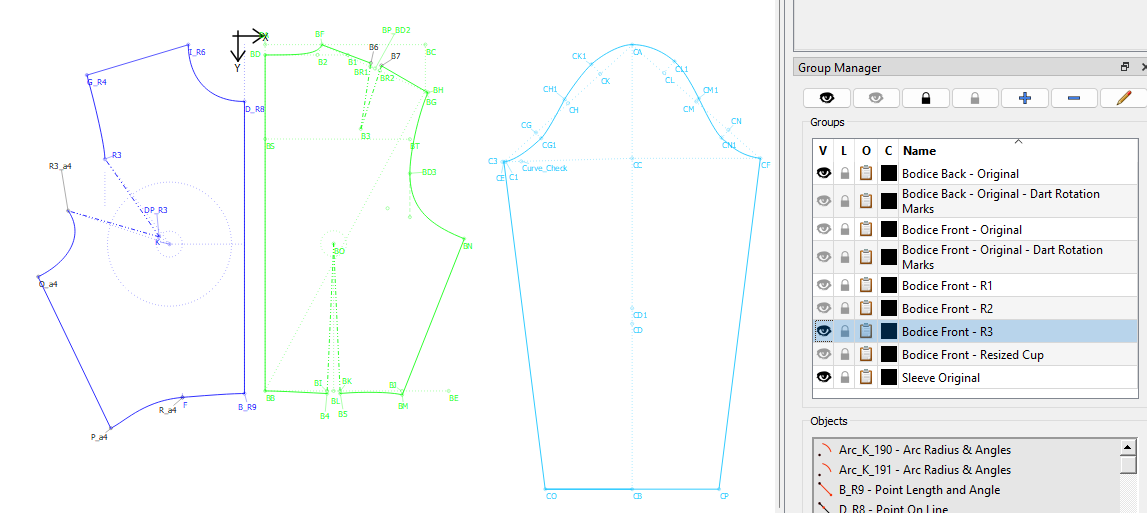

Same with dart at the side of the bust:
Same with dart at mid armscye:
If you follow the instructions in the HJA book, and practice using the tools in Seamly, you’ll be able to do the same.

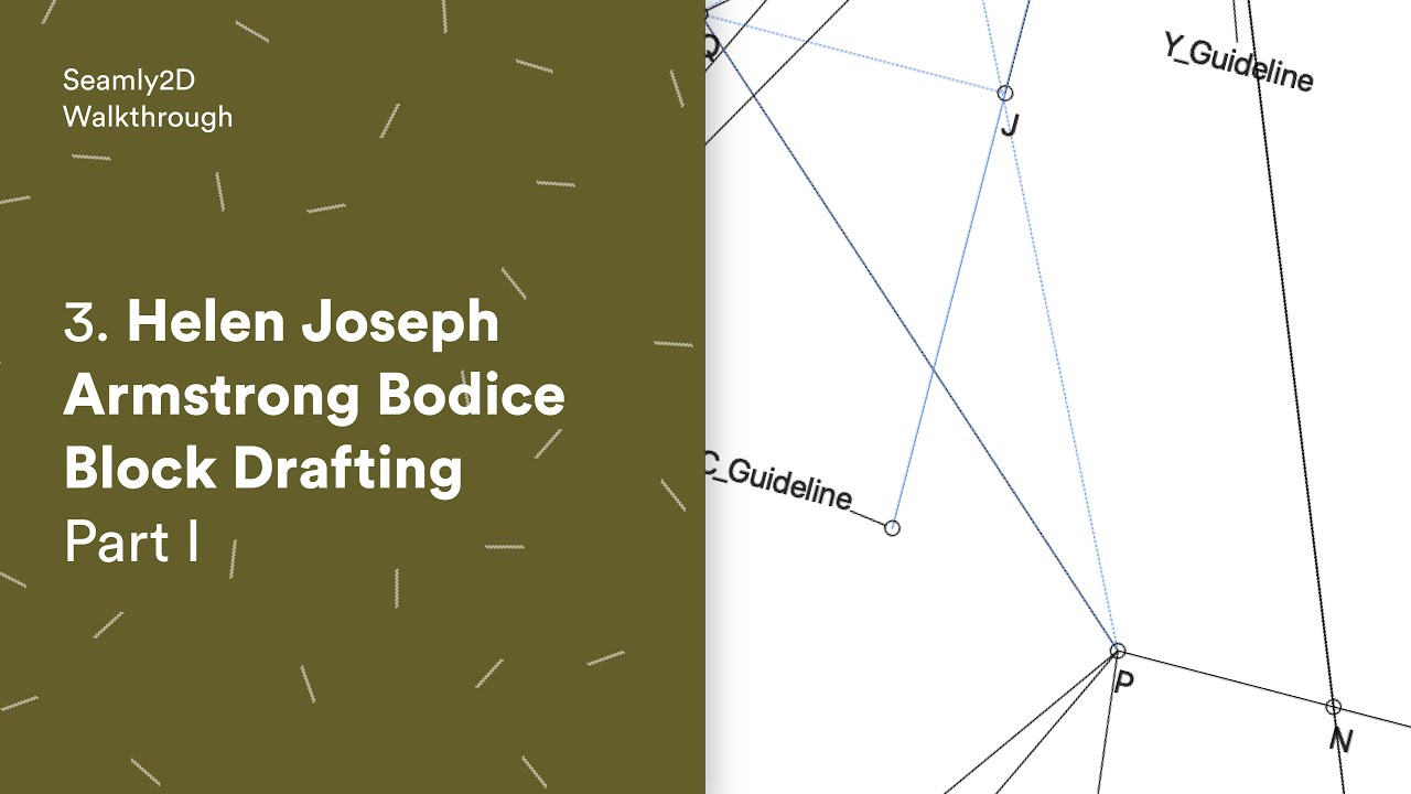

This is the tutorial I’m following.

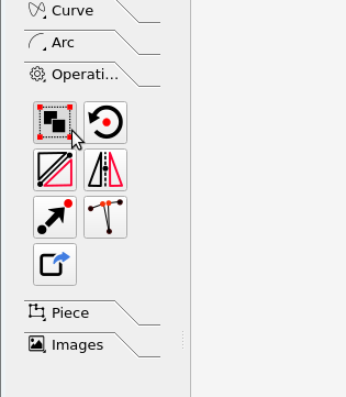

If so, is there an easy way to put all your moulage points/lines into one group, or do I have to do it point by point and line by line? When I select all of them, right click and “add to group”, it only adds one point to the group.
To add multiple items to the group at once use the Add Objects to Group tool. You can find it in the top-left corner of the Operations toolbox.
With that active you can select multiple items, either by lassoing them with the selection box, or by clicking them while holding ctrl & then hitting Enter when you’re done.
