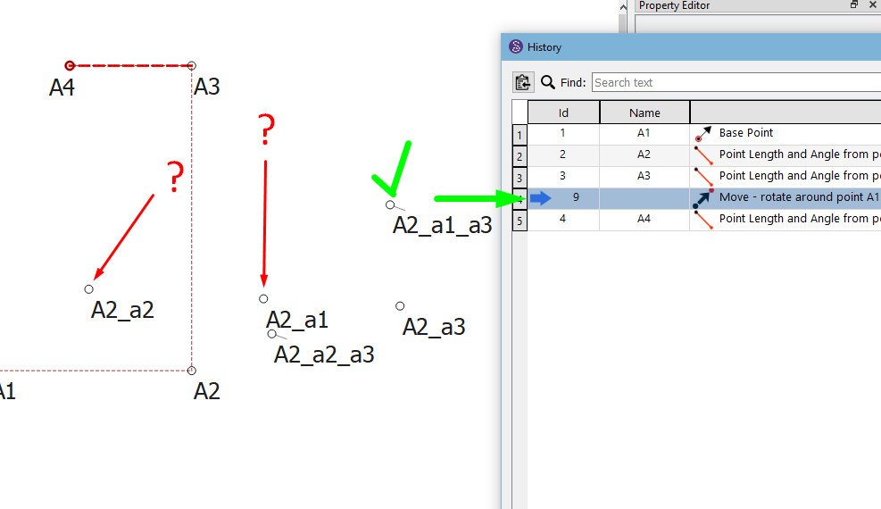

"Move object" tool operation is not registered when I do the "history hack"
Just found out about the history dialog, wish I knew about it sooner.

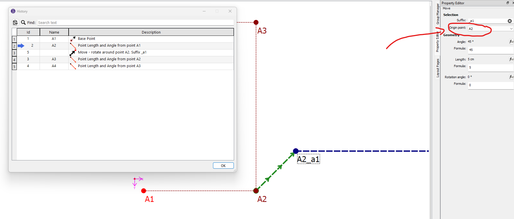

However, it only works partially with “move object” tool. As shown in the picture below, point A2_a1 is not registered in the history dialog after I do the move object operation.

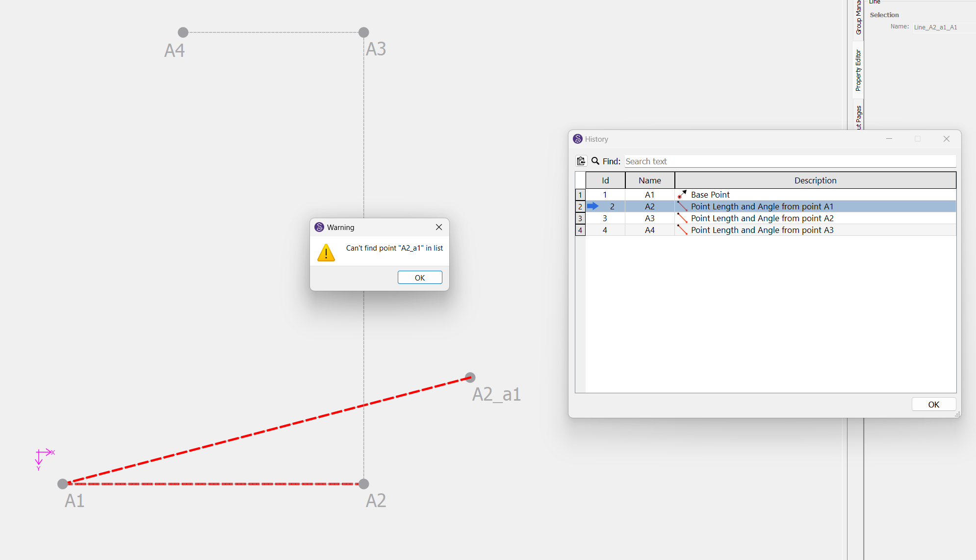

This makes it difficult to further hack the history. For example, I cannot insert Line_A2_a1_A1 before A3 is created, because point A2_a1 does not exist in history.

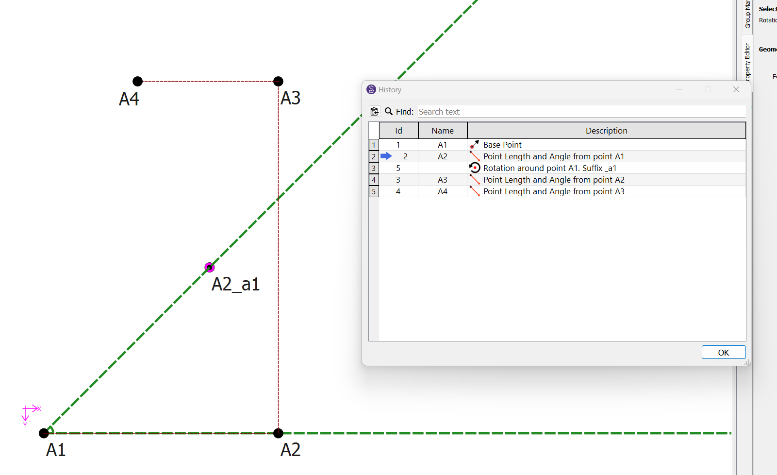

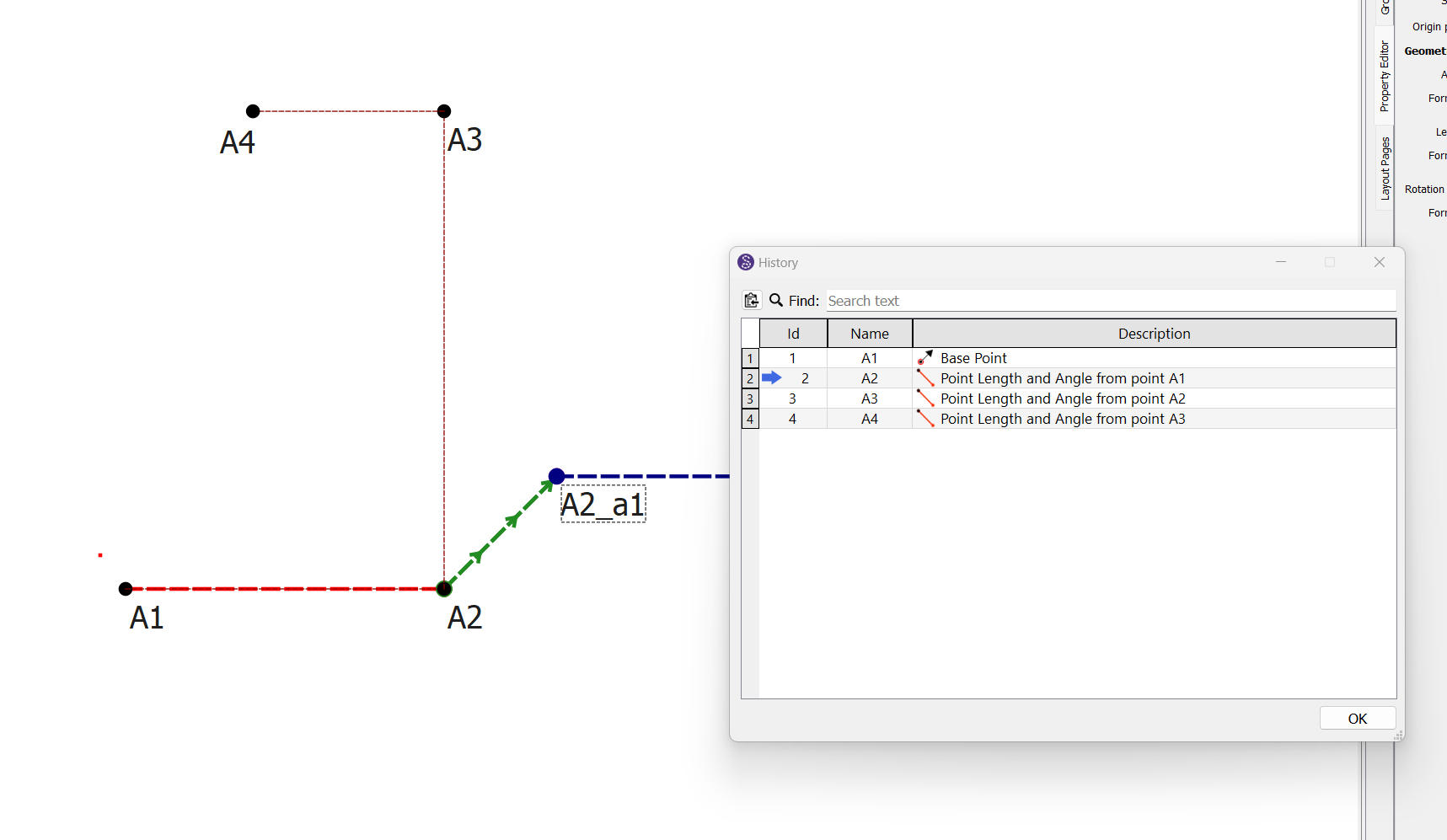

Other operation tools like rotate and mirror registered normally in the history dialog as shown in the picture below.

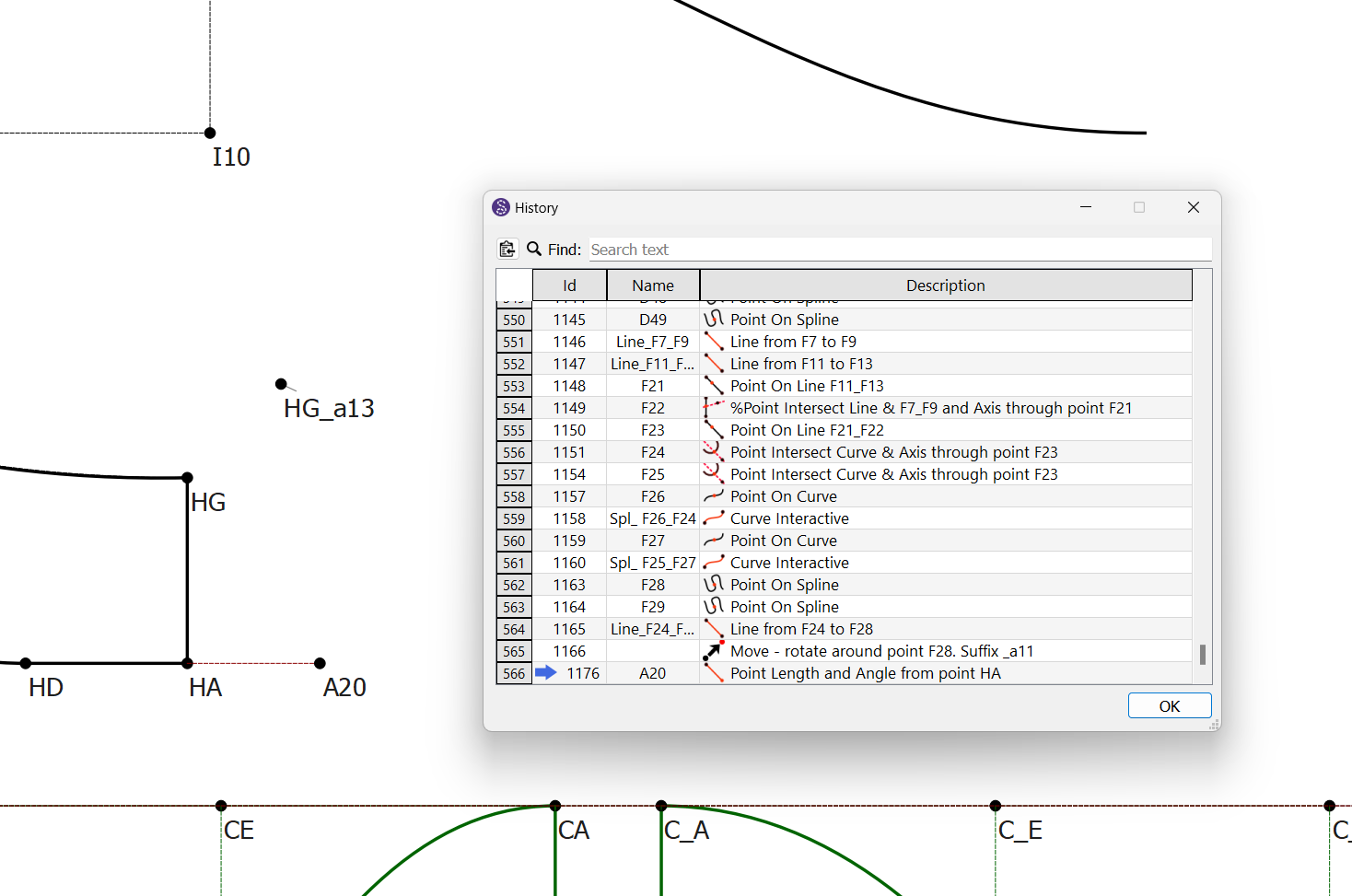

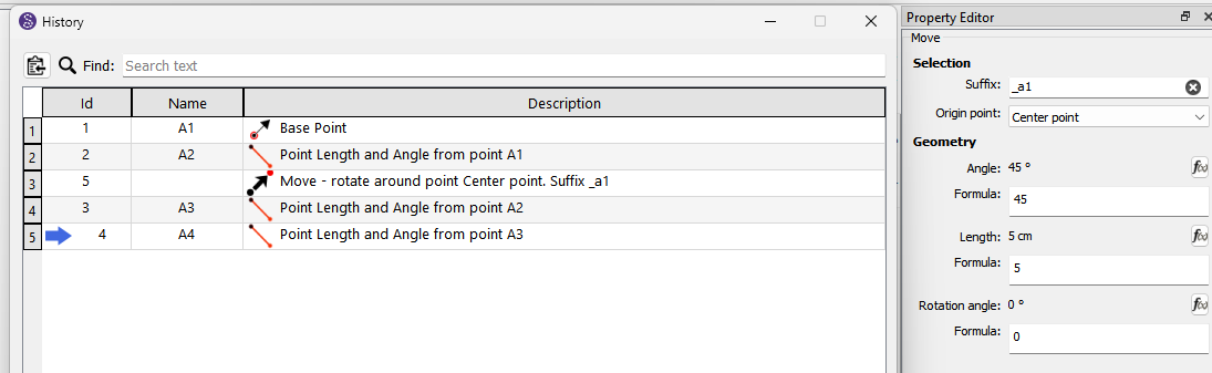

Now I noticed a bigger problem. With or without opening the history dialog, now any new move object operation is not registered in the history at all. In the picture below, my last step is to move HG to HG_a13, but this is not shown in history dialog. But I swear new move operation is registered before as shown by the second last step.
Maybe something broke along the way, so I updated the program just now and restarted the computer, but the problem persists. I’ll try with another computer and report soon.
Parka 2 028 forum.sm2d (184.3 KB) EU Male (Baron).smis (5.4 KB)
I tried different PC and earlier version but still does not work. But I found a temporary fix. The move operation will only show up in history if I change the origin point other than “center point”, then close and reopen the history dialog.
Oh, wow! That will help @Douglas when he gets around to checking.

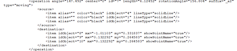

I took a look and I believe I know what the issue is. The op’s tools are rather an odd tool for several rteasons, but in this case there are 2 options for the origin point to “move / rotate” the group of objects from / around. 1) A point with a valid tool Id 2) The center of the group which has no or a NULL ID.
Problem is the part pf the code that fills the table is looking for the point name with a tool id. For ex below: Normally it’s looking for the “A1” based on A1’s id… but when there is no Id - as in the case of using the Center, the data is empty so the move tool does not show up.
That being said … I just need to put in checks for the op’s tools, and if the Id is NULL the point name = “Center” else the point name = tool’s origin point name.
