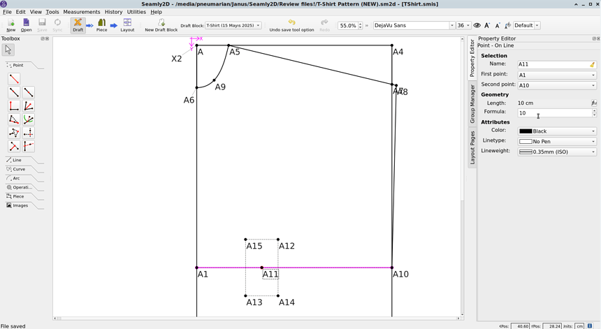

Question 1) Let’s say I draw a pocket on the block.
I want to both resize but “also move the pocket while grading.”
How can I do the move part?
Question 2) Moving A Single Control Points While Grading
Let’s say I draw a dart on the block.
While grading I want to move the tip of It.
How can I do It?
In order to know what to do, first you’ll have to know what you want to do, what the reasoning is for the particular decision. Once you can describe in formulaic form where you want the item placed, it’s just a matter of figuring out how to write that formula in mathematical form.
I see three basic options,

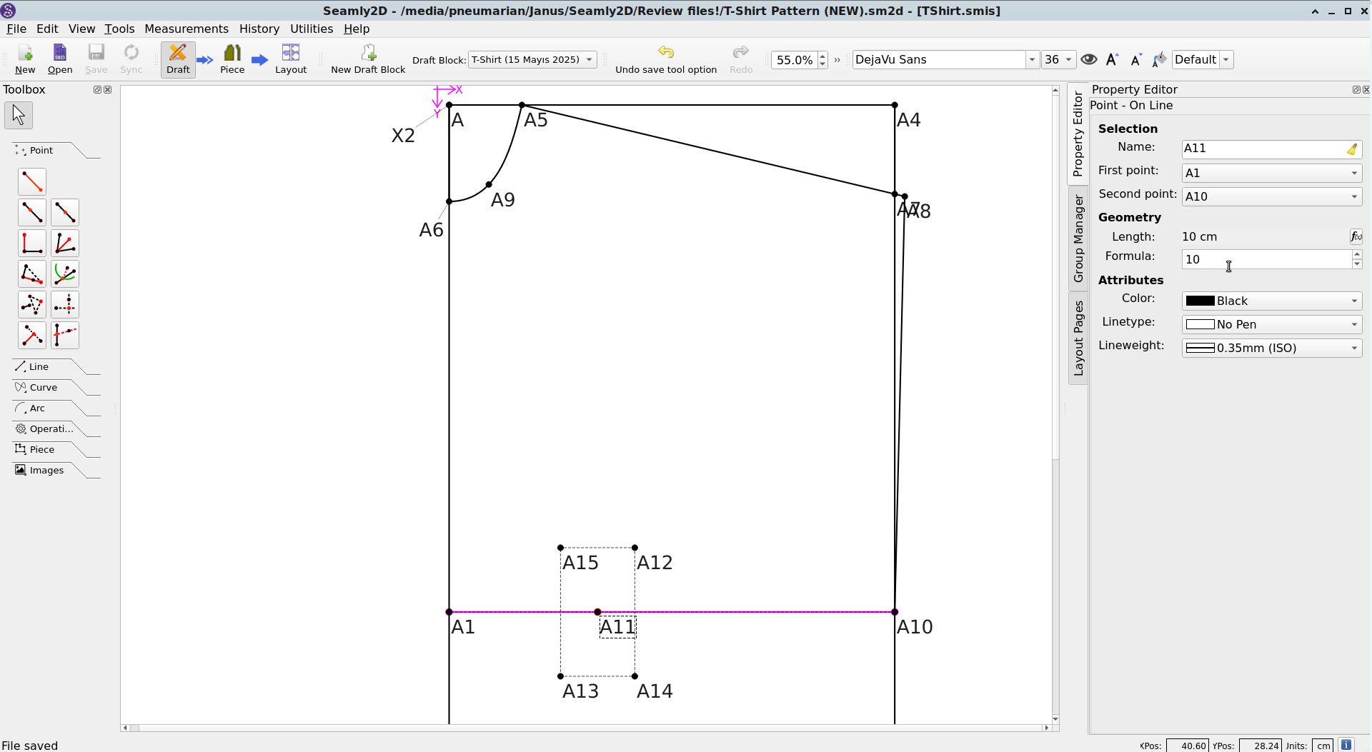

  1. you want the item (pocket/dart point) to always be a certain distance from one edge.

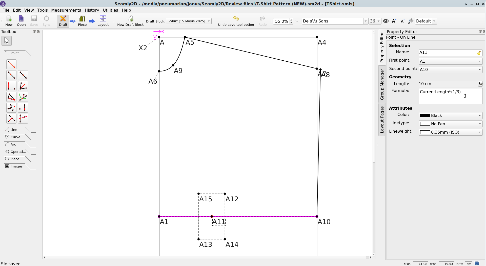

  2. you want the item to always be a certain percentage of the distance from one edge to another.
  3. you want the item to have a parabolic(?) relation to the edge(s).
Examples:
  1. The pocket is centered at 10cm from the centerline at armscye height.
  2. The pocket is centered at 1/3 the distance from the centerline to the base of the armscye. (I should have used CurrentLength/3 for simplicity.)
  3. The pocket is centered on the same line with a more complex formula. (2 examples)
I haven’t tested any of these options, but those are the basic forms your formulae might take. I hope this is helpful.
